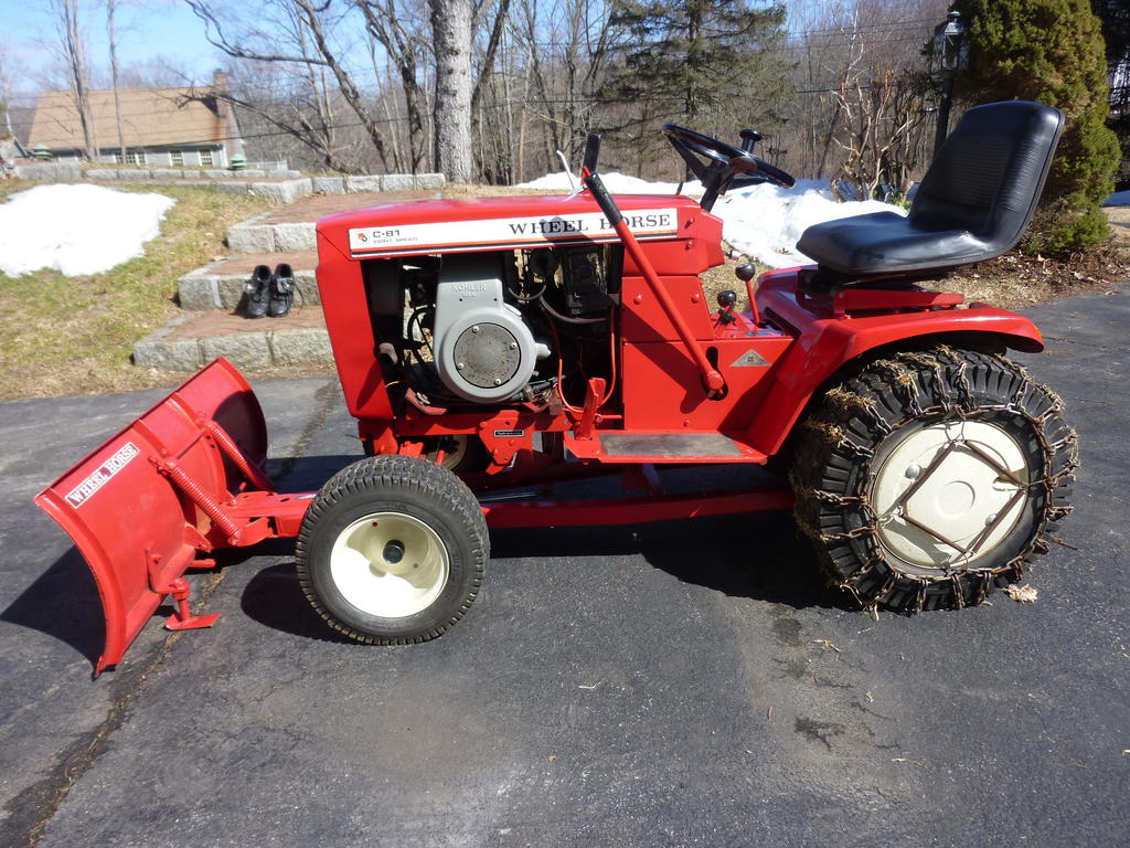

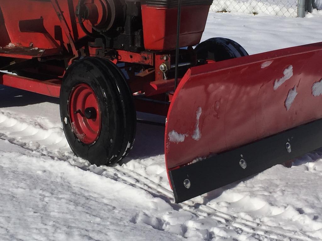

Have  a C-81 with a 48" Snow Plow, the current Steel Bottom Scrapper  Blade  is on it's last season..... I have noticed as of late that quite a few folks are installing the POLY blades.....  I plow a 100' macadam driveway and my concern and/or question is how well and how DURABLE are these blade. I did install feet on my existing steel blade plow (see pics) to limit the normal wear.   Thanks for you input

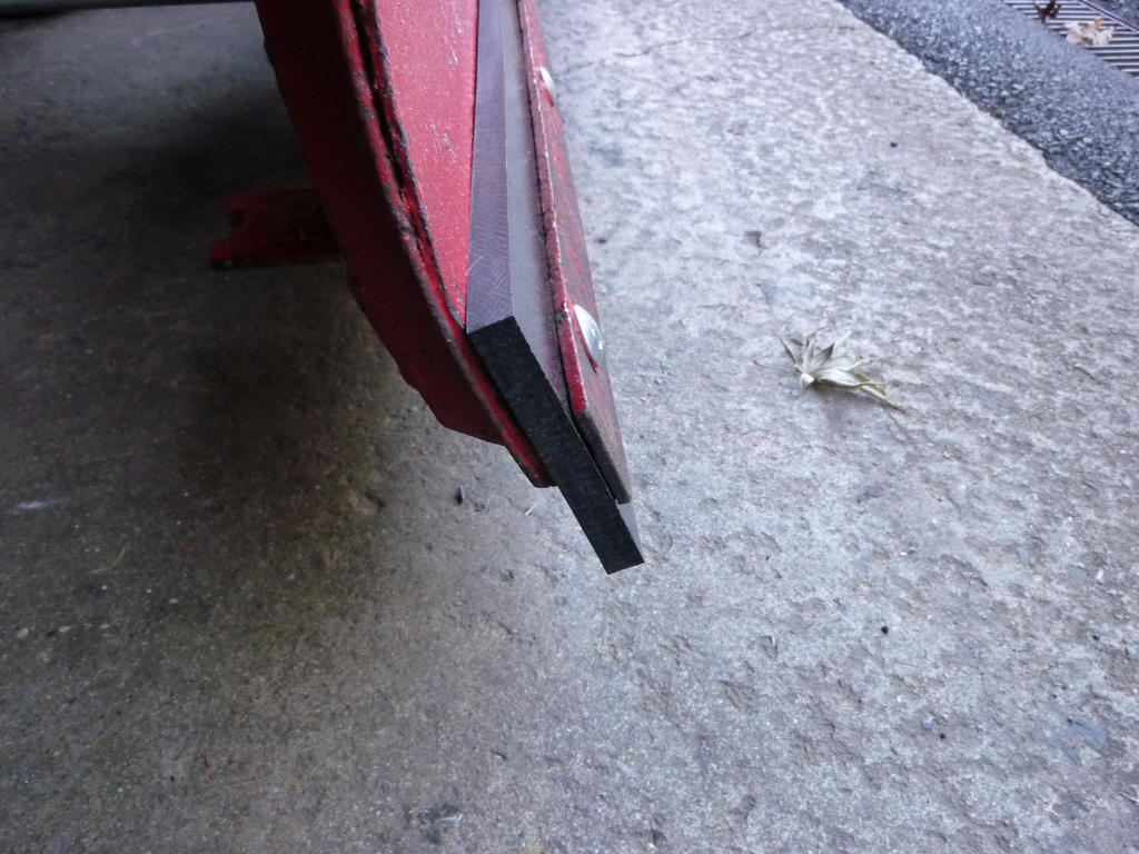

This will be the 3rd season I've had them on and there is very minimal wear (year #1 was only about 10 hours of use, year #2 about 25 hours and this year about 10 hours so far), the wear is just noticeable, I feel I should get 7-8 years of good use at this rate, and then I reverse the blade for 7-8 more years of use.  I have a 90% asphalt drive, 10% concrete -- the kind of drive you have will make a difference.  I think the asphalt is the least worst (less wear) and that a rough gravel drive may be the worst,  I have 5,000 square feet of drive and plow right down to the asphalt surface, -- but notice that you use skids which would cause almost no wear since you're only plowing snow and not riding on a hard surface.
Glen

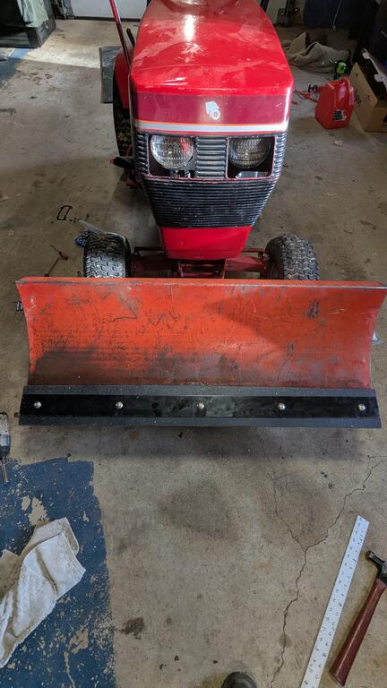

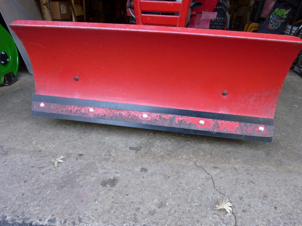

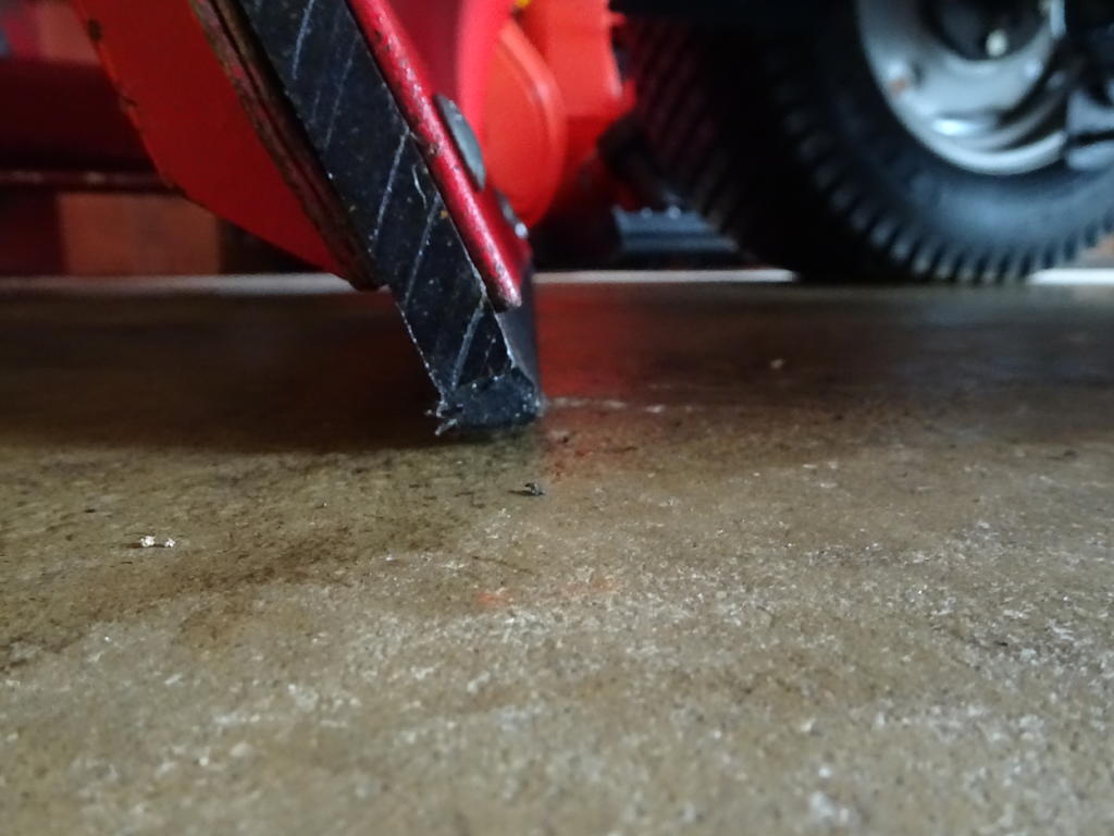

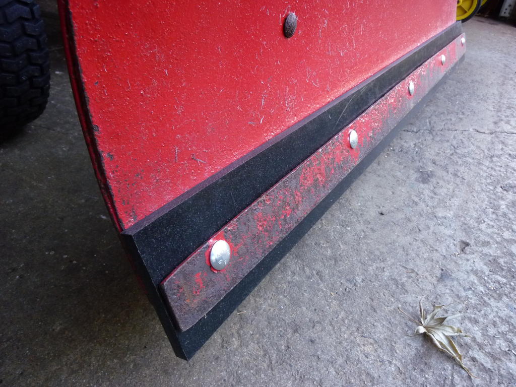

I use 3/4" rubber stall mat cut twice the width of my steel cutting edge holes that line up with the cutting edge drilled I. The center so about 1"hangs past on top and bottom sandwich that between your plow and cutting edge works great when you wear out 1 side you just flip it over I get a couple years out of one normally and I plow asphalt and gravel and the mats are 4ft by 6ft so you get a lot of them out of 1 and for about 30 bucks

I went with the poly blade this year as well and probably have about 5 hours on it so far.
Plow a few of the neighbors which is a mix of new and old (uneven and sometimes broken up) blacktop.
Very minimal wear ... would project I can get about 5 years or so out of it ...   and then I'll flip to the other edge for another 5.
Sounds good what is the best way to cut the material and cut it straight?  Thanks
bigplow1
I use a straight edge I have a 60" steel ruler and a sharp utility knife take your time usually takes about 3 to 4 cuts with a sharp blade I usually put in a new one

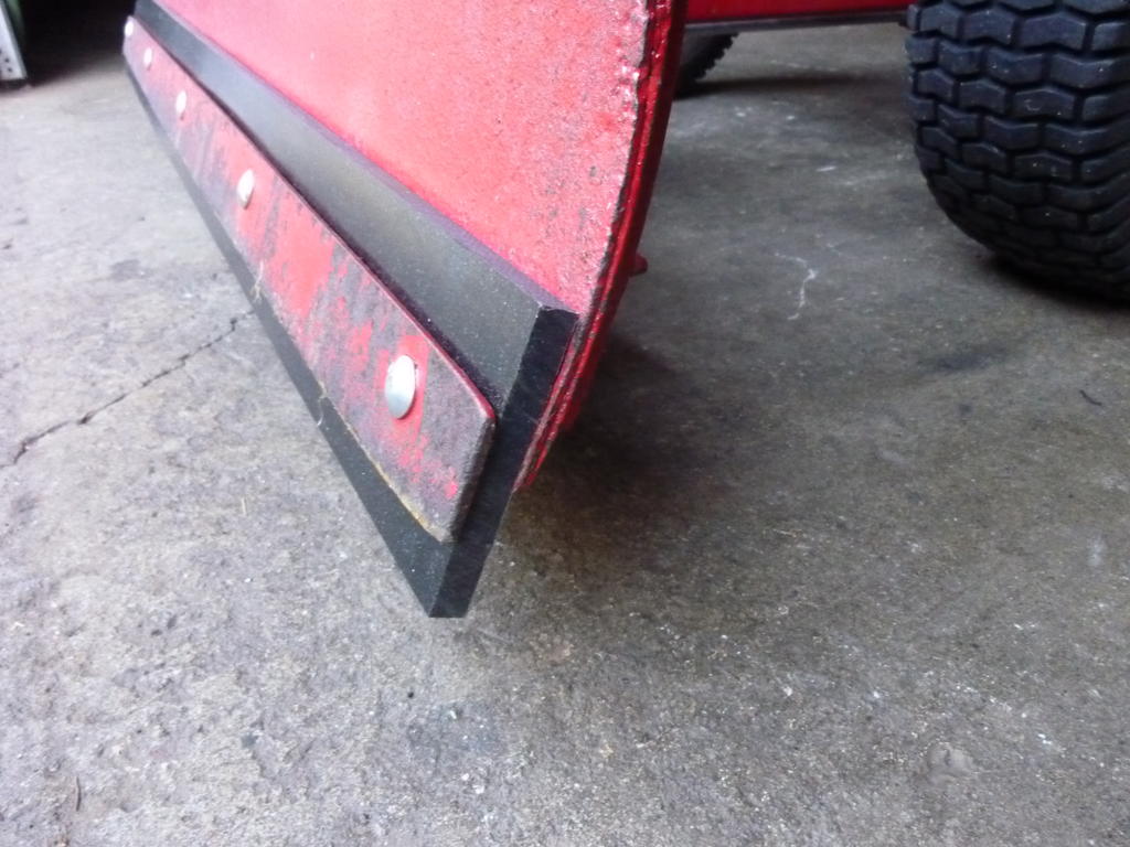

I purchased a Poly Blade off eBay and installed last season - or maybe he year prior(?). Live in MA and have not had too much snow since it was installed and looks like it has worn quite a bit. Went with it to avoid damaging the asphalt and it has done a good job in that respect. It came pre-drilled with one edge (top as installed) not having enough meat between the bolts and edge to flip and use again.  Bought some 1/2" conveyor belt strips to try when its completely worn.
Discussed wear strips on another thread a couple of weeks ago and one member do not recall the name/handle (Old-timers disease kicking in...).  He cut strips from old tires to use on his blade.  Sounds like an excellent idea - very cheap and should not damage the D-Way surface..

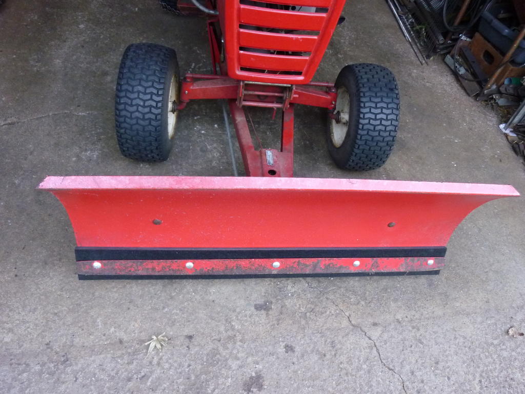

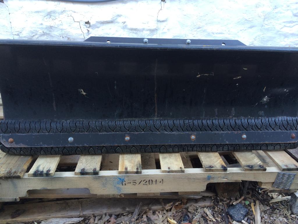

I have used both rubber and UHMW. Originally I bought a rubber horse mat, then cut a strip to bolt onto the blade. Use the blade's wear strip to use as a template and then sandwich them to the blade. It worked pretty good and didn't leave marks. I use to call it my 48" squeegee. But then I sold that dozer blade so decided to try a UHMW edge for the other blade.
For that I ordered a 48" x 4"  x 1/2" black UHMW remnant on eBay less than half what are sold for snow blades. The white UHMW is virgin so the black must be recycled. Used the wear strip again as a template and sandwiched them too. I also cut about a 45 degree angle at the very ends to prevent a snag. Three seasons and it is showing some wear. But I find that it tends to "ride" on the snow so doesn't scrape as well. I think part of the problem is that the front edge is at a positive angle with the rear edge doing the scraping. It really needs to have the edge planed so that it bites at the front. After taking the photo, it appears that is how it is wearing.

I used a 1/2" x 4" poly edge on a 48" blade that I installed before last season began on my 414/8.  I have a 450' asphalt drive
with parking area and turn around.  I plowed all last winter and 7 times this winter (so far) and the blade edge shows NO perceptible
wear (just a little rounding on the outside corners).  Before installing the edge I chamfered the the cutting edge with my wood
plane so that it mated at the correct angle with the driveway surface.
I am very pleased with the poly edge. It doesn't wear and it doesn't scratch.  The only negative is that it looks a little klutzy being
1/2" thick.  For me that is OK as performance trumps looks.
I also use the rubber tire chains modified to 2 link spacing.  I have also found them to work well. as they don't scratch the drive.
I have found the traction to be a little less than steel chains when pushing up the hill on the drive.  The slipping of the rubber chains
does not mark the drive and the straps show little evidence of wear.  I used to use steel chains and they really marked the drive
when slipping.
Conclusion: I am very satisfied with the poly blade edge and the rubber tire chains.

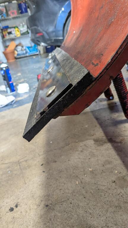

Alrashid2

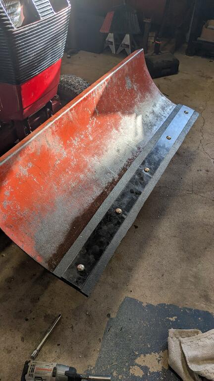

Old discussion but wanted to add that this is what I just did!
My driveway is old asphalt, with lots of uneven, crumbling spots and cold patches galore. Wanted to plow it but don't want to wreck it either. Installed a Dial a Height kit which definitely helped but because of the unevenness and incline, I was still scraping spots.
Bought a 3 ft x 4 ft x 1/2 inch horse stall mat at TSC for 40 bucks and cut a strip. My steel wear bar is 2.5" wide so I cut my stall mat to 4.5" so I had an inch hanging off either side. Used steel wear bar as a template to drill holes through mat.
Installed and we'll see if it works! One word of caution: don't over tighten! I bought new, longer carriage bolts and decided id grab Nylock stop nuts too just in case. Well, all it took was me hand tightening with a normal sized ratchet for the wear bar and plow to start warping! Couldn't believe steel would bend so easily. This happened because the stall mat isn't solid like plastic and was compresssing. Took it all apart and hammered the plow and bar back into shape.
Used the Nylock nuts and just barely tightened instead of torquing them down hard. No warping this time. Hopefully the nuts hold! If not I'll use some loctite next time.
