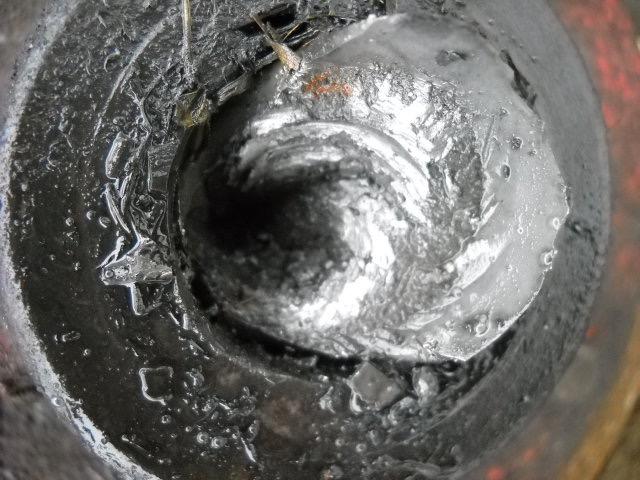

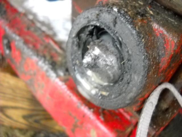

I just had my 14hp automatic break the left rear axle....I didn't see that the chains on the rear wheels were frozen over and I just put the tractor in drive...
Guess I have another project for the list. I will pull the engine and put it in my 16 hp, since I took that out for a premptive  rebuild.
Should I rebuild or look for another Eaton 1100 transmssion?
WHX??
I would pull the Eaton apart and check the rest of the internals. It's no good like it is anyway.  If they look good just look for a replacement axle. the other side of the coin if you get a whole 1100 you might have parts for future.
Thanks WH14,
I have a whole C125 transaxle on the way! I will also take the other transaxle apart and repair, for a spare. If I can find a good 108361 left axle.
Here are some pictures of the spiral break of the left axle... Is this normal?
DSCN7002.jpg.39f1e0a8d125bc580b3ceedf751b5781.jpgDSCN7000.jpg.ed411ce58661c97a13915380fa1f4532.jpg
From what I can see from the Hydro and 8 spd parts explodes the axles are the same for both.
Is this true?
