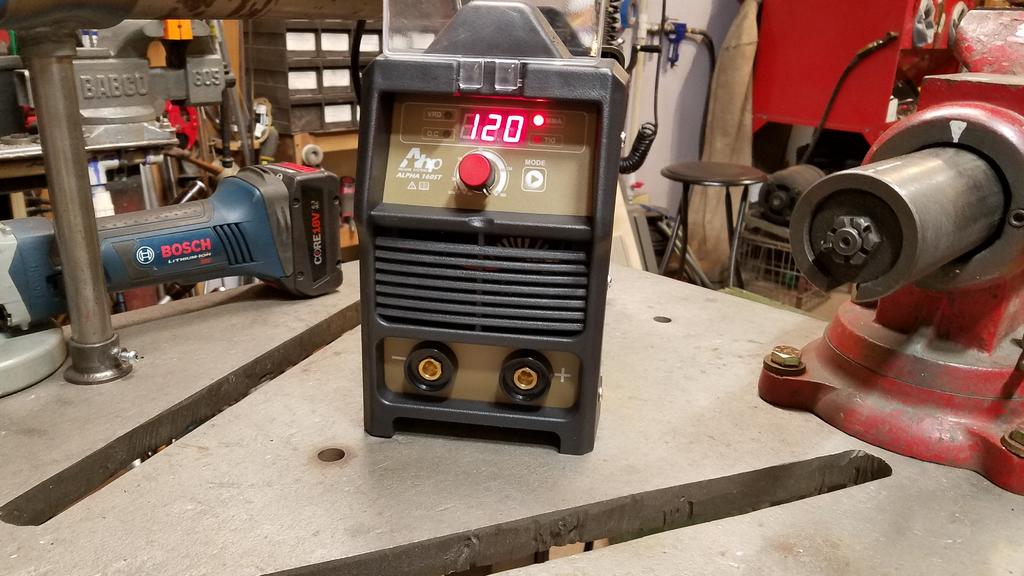

Enough rambling - I know....here's a couple pics
This thing is ridiculously small - like, half the size of my lunch box I take to work and far lighter @12.5lbs. No wonder guys have been putting a strap on them and welding stuff off a ladder, lol.
A few notes that are specific to this machine that they don't tell you - stuff I consider pretty important.
Their tech people recommend never using ANY cellulose type rods - none, including 6011.
They also stated to keep the leads short - like 10'-12' long at most. Longer leads puts more feedback to the electronics and can shorten their lifespan.
The front panel DINSE connectors are the smaller 25mm size versus most using the larger 50mm size. Roughly 3/8" diameter vs. 1/2". No big deal, several companies offer 50x25 adapters for that - I ordered a set the same day as the welder from one of the welding suppliers. Didn't want to have to use an odd tig cable/gas adapter to run my various tig torches.
The lift arc tig function has a ramp-up style feature - it takes a second or two to hit the full knob setting for the given amps the welder is set for, this is a good thing. That one difference is why I didn't want the Everlast 160 model despite it having an internal gas solenoid and high-frequency start/remote capability. That other model is a little more expensive but easily twice the size of this one - all I want is a basic machine that is light and small - and cheap. Dragging the extremely expensive 60lb Miller outside is not something I want to do - the thing is just too expensive to replace and it's internals would scare NASA.
Now, this is a 120v/220v machine. Shown on the display is it's max capability on 120v power - it comes with an adapter cord to go from the standard 50P welder plug to the common 120v 15/20a wall plug. At 120amps , that's close to being able to run 7018 rods in 1/8" size - but, the limiting factor is always the wiring from the plug to the panel in any structure. These machines are known to easily run the 3/32" 7018 rods almost continuously without a problem - but the wiring to the panel/breaker must be up to snuff or you'll be tripping the breaker often. You should really have a good quality 25amp wall outlet and minimum of 12ga wiring back to the panel - as well as keep that wire run short as possible if you want to run it on 120v often. They will also draw a lot more inrush current on 120v as will any machine - my Dynasty will almost always pop a breaker within a short time in comparison to this little machine - the Miller just has a lot more electronics drawing on the circuit in comparison. Using multi-pass methods you can easily do some very thick materials using 3/32" 7018 rods - it's an industry practice that commonly used in the field for high stress work.
Anyway - just thought I'd put out the info on it and testing will hopefully begin soon. I need to pick up a valve type torch or at least a handle to run the gas since this one is not equipped with an internal gas solenoid. No big deal - I can always use another torch - lol. I've been pretty sick the last few days and the weather lately has really kept me in the house - hoping to at least get it outside and run some rods to fully test it's power levels and ensure there are no problems. I can find only a very few complaints about these things on the net - just a few have arrived DOA for whatever reason and AHP promptly took care of it - this machine has a good 3yr warranty. Looking forward to having something much smaller/lighter that I can set up and go to work a lot quicker than dragging out the Miller. That expensive tool lives in the basement shop and is really a dedicated tig machine for nearly all metals with it's advanced tig functions. I do have an old Lincoln AC185 buzz box sitting outside under a garbage bag for years now that gets occasional cellulose rod duty - it burns 6011 quite well and despite living out there in the weather it has never missed a beat - pretty good investment for a $25 welder my brother in law found at an auction - no idea why no one wanted it but I'm glad I grabbed the opportunity.
It's a highly capable machine, much more than just hobbyist or entry level and for the price point can do a lot of work. No ac side to it so any aluminum work is out, but the dc on these runs so smooth it's almost disgusting - Miller and Lincoln need to seriously up their game as more and more professional/industrial shops are buying these things at a fraction of the cost of the big name machines. I've got a buddy that bought out an old friend's shop nearby in my old hometown - can't wait to show him this thing since he owns and regularly uses a Miller Maxstar 150 that cost him $1,800 at the time it was new and he's had issues with it lately. I've always wanted a small Maxstar - but even used they are super expensive and are known to burn out if pushed too hard - for the price point of the AHP you can't go wrong and their performance record is stellar. For anyone wanting to get a good dc stick rig at a very reasonable cost or learn to tig weld steels - this is a great machine for the money.

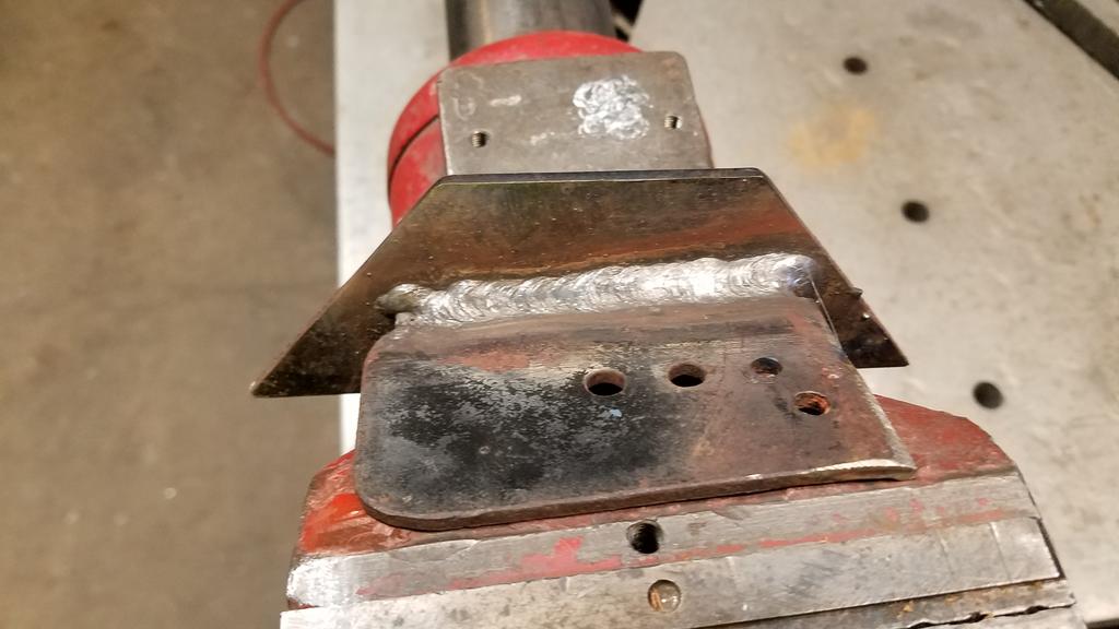

The flu finally gave me a little break yesterday for awhile - and the weather gods smiled as well, 58*F here yesterday morning at 9am...
A quick look at the radar showed a small window of time with no rain from the system coming in that was bringing huge changes to our pattern yet again so I took the time to pull the little toy out and do some quick tests. Didn't feel like dragging the heavy 220v drop cord out so I just decided to test it on the 120v side with some 3/32" 7018 rods. It runs those rods flawlessly, in fact, as good or better than the $4,000 Miller Dynasty. This thing lacks a dig control but frankly, it's current sensing works so well it's not needed - I could nearly snuff the rod out and it just kept it burning smoothly. Long arcing didn't seem to affect the machine either, which was a surprise. I set up one piece of plate in the vise and ran 5 full 14" Esab Atom Arc rods in as fast a succession as I could swap them out - it never blinked nor tripped the breaker. The outlet I've set up outside is a standard dual leg 20amp with the wiring back to the panel being nearly 50' long in 12ga building wire. Now, the Miller in comparison could barely make 1 rod before it would trip a breaker on 120v - this thing did it with no issues and to top it off it was also running an additional 25' 12ga drop cord.
Arc performance is amazing for such a little box - ran it at 90amps and that seemed spot-on for this size rod. Pushed one last quick fillet joint before it started to sprinkle rain and had to quit - the exact reason I do not like dragging that expensive and much heavier Miller outside. Out weather here can change in a flash - as we always say, if you don't like the current conditions - wait 5 minutes and it will change.
I didn't take time to photo the back side of the fillet - but penetration is excellent and had no problems holding the leading edge of the puddle and it flowed in like butter. Can't wait to run some 1/8" rod and really push it hard but I'm sure it will do fine. When I get to feeling better I do want to fully test the limits of the tig side and push it hard against the duty cycle - that's where a lot of these smaller inverter-based machines fall off if they aren't built right. Just for grins, I took it over to the welder next door - he's seen these listed and has the bigger 200a AHP tig machine but was surprised at how small this one really is. He may pick one up to do sanitary SS work in a local plant as it would save a lot of aggravation having to use his engine drive running outside with super long leads when he has to weld piping and fixtures in there.
No regrets so far, for the money I'm really impressed with this little bugger.

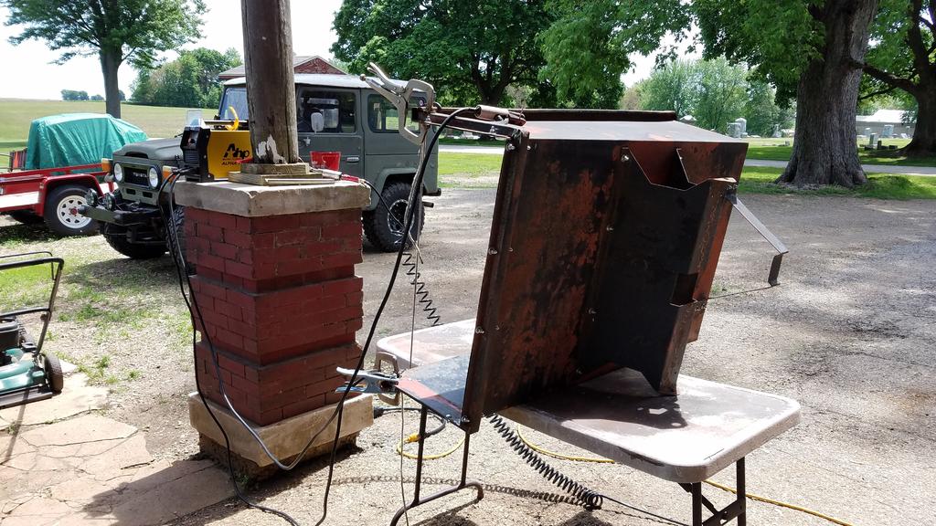

Been using the little AHP a LOT lately, man, I love this little box of a machine. It's been loaned out a couple of times as well to my brother in law - he wants one badly but they are out of stock again for a while.  Yesterday, I needed to make some repairs to an old lawn tractor cart, think it's either an Agri Fab or similar. Both corner frame reinforcements were cracked at the welds from abuse and rust. The AHP performed flawlessly running 7014 1/16" rods for repairing the sheet metal parts, about 20ga material. It's so nice to grab the heavy 25' drop cord and this little lunch box sized machine and take it where it's needed instead of dragging out a bigger machine or using the old Lincoln 180a buzz box and the 220v supply cord.
Spent almost all day making a new axle, fitting some used tires/wheels and repairing various spots on this cart to make it functional again - productive day and yielded a useful tool. Haven't had time yet to test out the tig function and I'd really prefer to get another torch to use with it that has the gas valve instead of having to shut off the tank regulator outlet - but I'll try to report back soon.

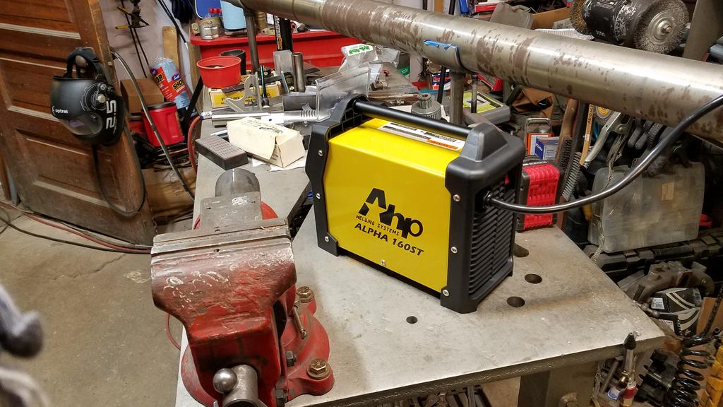

Cruiser has been passed onto a new owner - was getting to be too much for me to drive the old beast any longer. I severely miss its rugged reliability and simple design. Easy to work on - but the parts weigh double that of most vehicles. I'd love to have a newer one like an 80 series, or maybe a 120 - but, prices are a serious premium and its nearly impossible to find a low-mile, non-abused example without paying nearly the cost of what they originally sold for. Not to mention - look around -they rarely ever come up for sale on models prior to the 200 series SUV monster. Fuel mileage - hah! Forget it, most get around 12mpg at best. I replaced it with a '03 V8 4Runner Limited w/leather, 183k on the clock and in pretty nice shape other than a rust hole in the rear gate, which will get fixed. The 4Runner has been pulling averages of around 20mpg, despite the 4.7L V8 engine.
I did finally get a new torch w/valve to use the with AHP welder - TIG function on lift arc is excellent, although I'm well out of practice in that process. Every time I've used it one foot or the other is hunting around for the amperage pedal, lol. That poor welder has been abused a lot over the winter and is generally not even here from either my son in law or brother in law borrowing the dumb thing. Son in law has it currently, doing heavier stick work on his pickup and snow plow setup. Still runs perfectly, has not tripped the safety even once yet.
From the site - it looks like the price has increased on the 160ST, up to $299 now compared to $240 that I paid for mine. I also see the newest version of the 200 amp TIG is out - TIG201XD, with an introductory price of $690. That's pretty cheap for the features and duty cycle on these machines - tempted to buy one of the 200 amp AC/DC models for heavier work and keep my expensive Miller safely in the shop.
