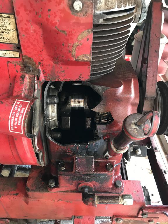

Firebug 267 #1 Posted January 8, 2018 So I was out plowing with my 74 d—60 the other morning, nothing major, just some light powdery stuff so I wasn’t working it to hard. About a half hour in the single Koehler exploded. Scared the hell out of me since it sent parts flying. I’m figuring it’s going to be a lot more to find a donor block, crank, machining, etc then to just repower it. Im just looking to see what other people have repowered their d series with and how much engineering goes into it. I was sort of leaning toward a newer Honda or commercial Briggs or something along those lines. Any input is helpful. Thanks guys. As a side note, I do have a d 200 that is in retting restored and I plan on plowing and mowing with that when it’s done, So if the 160 is a lost cause then it is what it is, but my wife likes the belly mower on and isn’t afraid to use it. And the rest of the tractor is solid in good running order. 2 Share this post Link to post Share on other sites
elcamino/wheelhorse 9,363 #2 Posted January 8, 2018 I don't think J B Weld would work on that hole. I know there are some threads on the 22 hp Predator motor from HF. @Aldon is using one on his GT14 I think. Good luck. Share this post Link to post Share on other sites
Sarge 3,473 #3 Posted January 8, 2018 The biggest trick on a D is that hydro coupling between the engine and the pump. Since it's off the flywheel side of the engine it puts a lot of limits on what can be used. I'd start hunting for a K482 or K532 twin engine from a D180/D200 with a pressurized oiling system - which is the downfall to the K341 single engine. Honestly, those bigger twin opposed iron series engines were about the best ones Kohler ever built - just ask any machine shop that works on Kohlers. The other main issue is the overall length of the crank - if you alter that length with a different engine it will screw up the whole PTO system off the other end of the crank and then you'd have to alter a lot of the tractor to make it work. They have been a few swaps done - everything from Predators to other brands. 2 Share this post Link to post Share on other sites
Skipper 1,792 #4 Posted January 8, 2018 Just feel like pointing out the easy solution. Why not just find another K341 1 1 Share this post Link to post Share on other sites

Firebug 267 #6 Posted January 8, 2018 I thought about another 341 for it but was thinking about something a bit more modern since my wife uses it a few times a week. A good 341 will probably be the easiest way to go with out having to engineer and fabricate a bunch of stuff Share this post Link to post Share on other sites
pacer 3,180 #7 Posted January 8, 2018 I have to agree that a replacement K341 would be the easiest, most practical, sensible, etc, etc, solution. And, hey, you certainly cant knock that beefy 16hp 341, while I too like the big Ktwins that big one lunger is no slouch. 1 Share this post Link to post Share on other sites
pfrederi 21,167 #8 Posted January 8, 2018 (edited) Something else to consider, there are a lot of after market parts to rebuild a 341, not so many for the twins...and a twin rebuild needs two pistons, two rods, two sets of rings.... If she is working with a 48" deck then 16 hp is enough. Edited January 8, 2018 by pfrederi 1 Share this post Link to post Share on other sites
Shynon 7,706 #9 Posted January 8, 2018 3 hours ago, Firebug said: I thought about another 341 for it but was thinking about something a bit more modern I would find another k 341 and rebuild it, as it will last longer than anything modern. 1 Share this post Link to post Share on other sites
Firebug 267 #10 Posted January 9, 2018 Another thought I had, my parts tractor had an Onan twin from a later year 160, maybe a 77. While it runs it still needs some help. Doesn’t have the right carb, someone welded on harley exhaust pipes, etc etc. I know the Oman’s were less desirable and more expensive to rebuild but it runs. Or would a replacement 341 still be a better option Share this post Link to post Share on other sites
Shynon 7,706 #11 Posted January 9, 2018 2 minutes ago, Firebug said: 341 still be a better Share this post Link to post Share on other sites
JackC 619 #12 Posted January 9, 2018 "I know the Oman’s were less desirable and more expensive to rebuild but it runs." If it runs, I would go with it. Better to use it than to have it sitting around taking up space. Make sure the starter is in good shape because they are a bear to replace once the engine is on the tractor. I really like the ONAN's on my D-160s. With the correct and clean carb, they are nice quiet smooth running engines compared to the single cylinder engines. They also have plenty of power for plowing and mowing. Probably has more torque than the single cylinder Kohler 16. The electric PTO that goes on them is also nice. Share this post Link to post Share on other sites

mrc 1,119 #17 Posted January 11, 2018 any idea what caused such damage? Share this post Link to post Share on other sites
Desko 686 #18 Posted January 11, 2018 Many factors. Could have been a stressed rod, lack of lube, a tab bit to high of RPM, too much side load, may have just up and broke the thing is no one will ever know what truly caused it. Share this post Link to post Share on other sites
