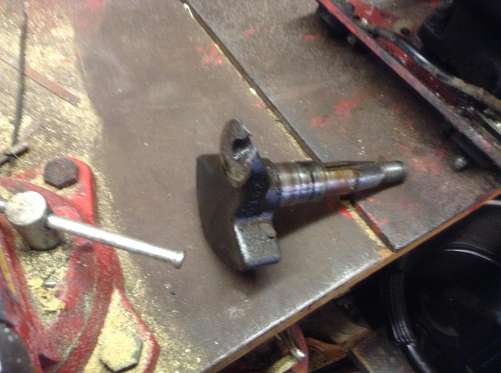

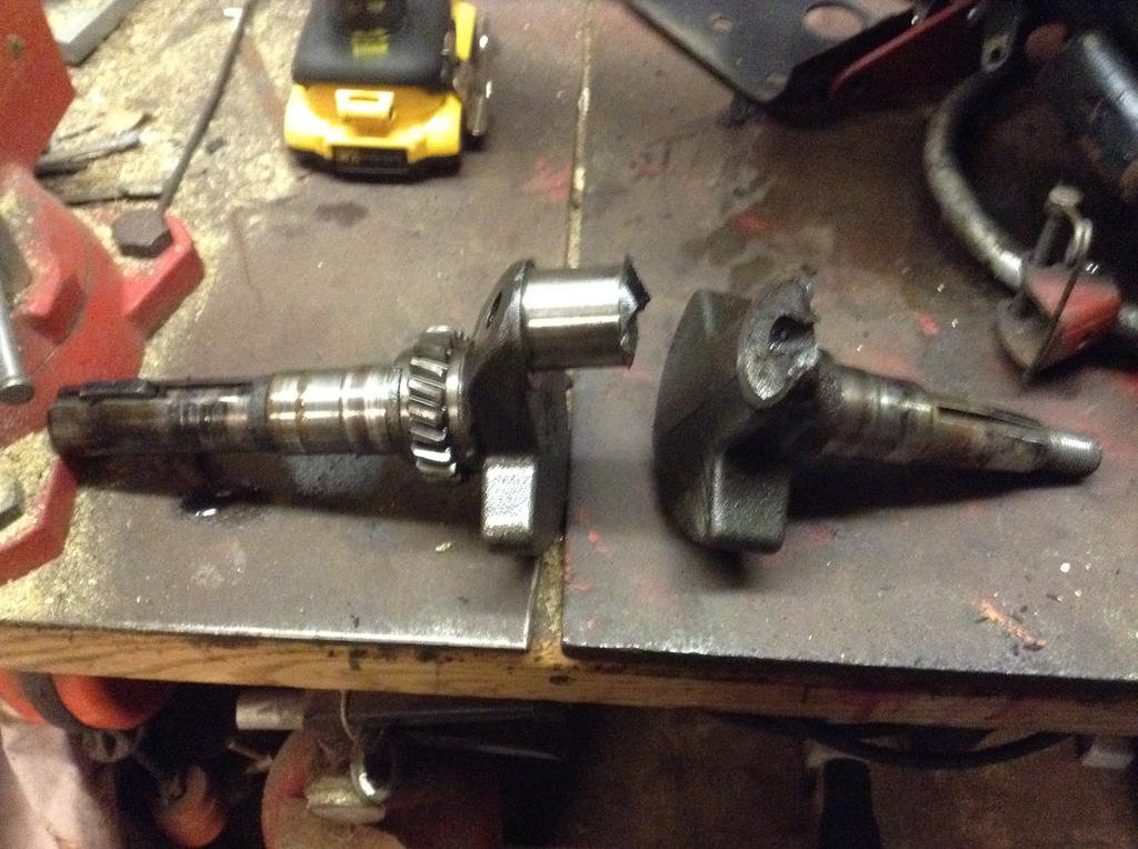

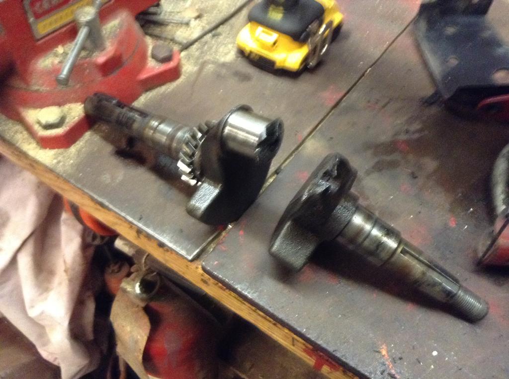

My son was using our C-85 to plow snow and it suddenly stopped.  He grabbed me and we tried to start it and it wouldn't even turn over.  Turns out the crankshaft broke, and when this happened the flywheel moved enough to hit the stater and wiped out some magnets and blew a fuse, kind of a chain reaction.  Of all the blown engines I've never seen this happen and I'm not sure what caused this.  We have worked the heck out of this tractor, and I've all the things I could think of that would break, the crank isn't one of them!  I'm wondering if the crank had some kind a flaw, but it has lasted all this time.
I've looked up what a new crank and flywheel cost and it looks like they are still available from Kohler for about $304 and $428.  I see that there are some used ones on eBay, but I hate to get a used crank, a used flywheel would probably be okay.  I looked online to see if some outfit sells re-manufactured K181s, but didn't see any.  I could fix this, it's just a mater of what makes the most sense with money/time.  I'm also pondering shooting the works and buying a new short block at around a $1,000, realizing I'd still need a flywheel.  I love this tractor and plan on having it for life (my life, I'm 57), so I might just renew that awesome engine:)

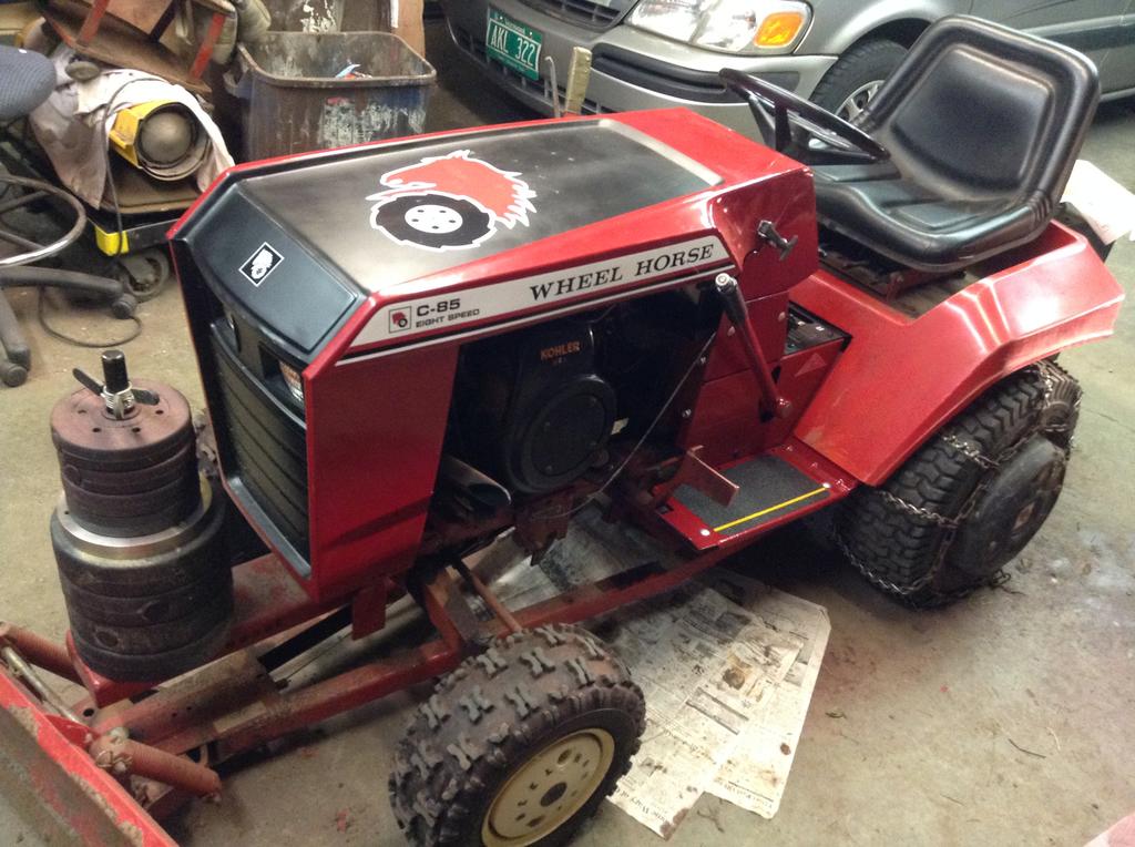

This is what it used to look like!
5a517084345c0_DBpicoffiPod1-20-17278.JPG.a228a0255afb46131d5caff4ae551bec.JPG5a517101ec3d9_DBpicoffiPod1-20-17515.JPG.9f228ed55096168c8c7f79677fcb00e2.JPG

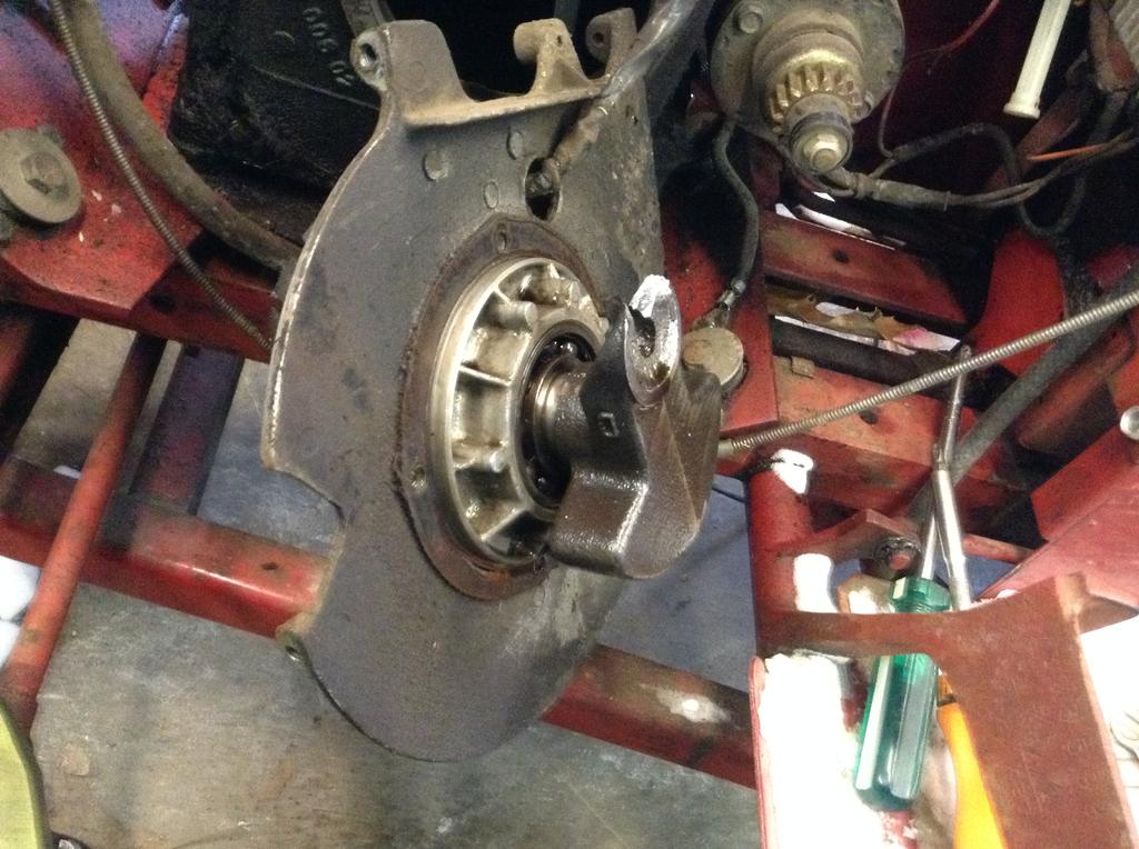

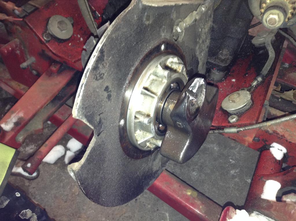

This is what it looks like now!
5a51697bbaf26_IMG_03171.JPG.2ae542072c6af990674c917c40b41108.JPG5a51699ae3ad3_IMG_03191.JPG.8ea8e5ff3b6535ce668645554f9a69b0.JPG5a5169b7b6cde_IMG_03221.JPG.bd20c46d5b5135182b954f91c1419572.JPG

Wow never seen a crankshaft break, my guess is you will also have a broken cam. As the k181 cam is prone to breaking when a rod goes, clearance is that close.  I would look for a good used motor to repower or rebuild as cost to replace those parts will be more than a good used or rebuildable.  Or upgrade for more  HP

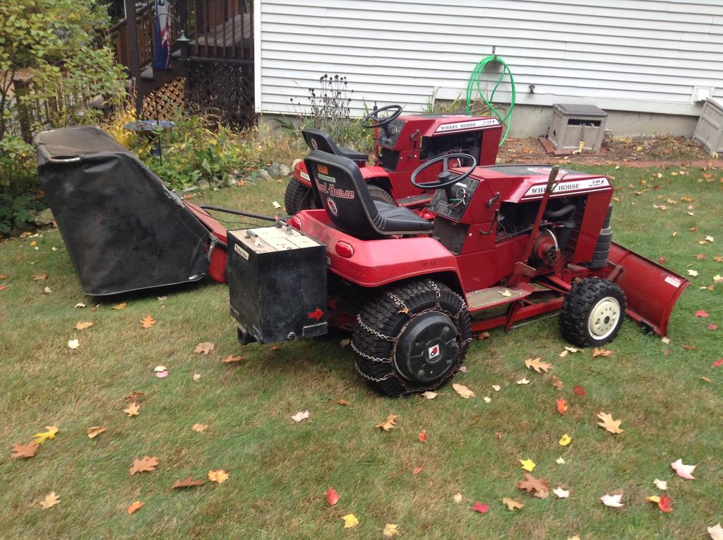

I have found a used complete K181, and I've got it on there, so it is fixed now.  What a tune up! :bow-blue:5a5e3a6be5c0c_IMG_03231.JPG.80f4b97f4ae73dad0477d9651aa12896.JPG5a5e3badb25bf_IMG_03241.JPG.dd503f7ba7c2c4652c9256330d3cc541.JPG

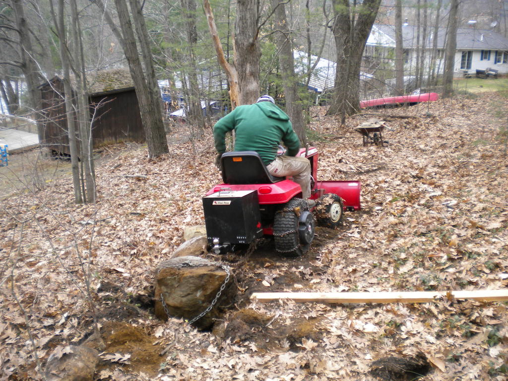

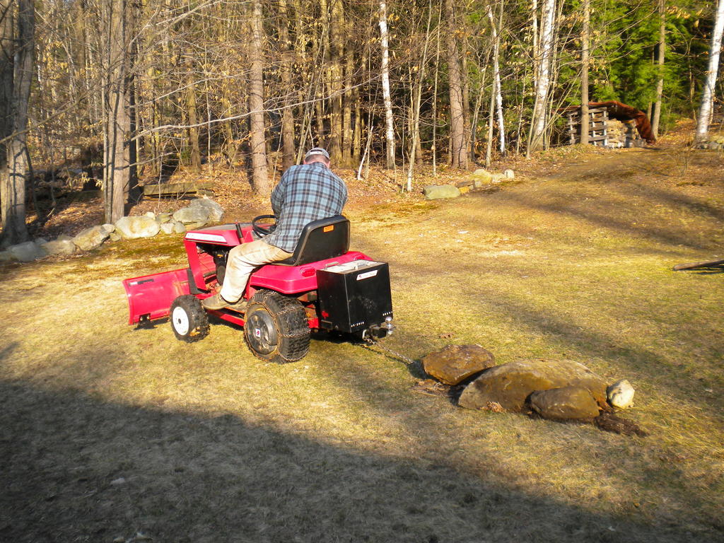

Now to figure more about how this happened.  I think going to a 12hp would have been great if I had one, but I don't.  My little 8hp tractor has plenty of power for what we've been using for - plowing snow and some dirt work.  Oh and occasionally some rock work!
These rocks that I dug out are on skid (sheet of plywood) that I was pulling -
It is totally amazing to me to know what this little 8hp tractor has done!
Like I said when I posted this that I had never seen a crank shaft break and I'm still puzzled by this.  I know I'm carrying a lot of weight, but it seems like there's so many weaker links (like the connecting rod or drive belt) that would have broke or failed before the crank shaft!
When I was in the equipment business, I saw plenty of engine damage, but not like this.  We had lots of customer lawn mowers come in with bent crank shafts (from hitting rocks or something solid), but never a broken one.
Has anyone else seen damage like this?

I'm guessing there might have been a casting flaw in it but the bigger mystery is why it waited this long to rear it's ugly head. Like you I have seen many bent cranks come in, mostly on push mowers that hit a rock or stump, but never one like that.

We may never know the real answer but you could have nailed it right there. It is possible to have a casting flaw on the inside of a piece of metal that is just beyond the point of Machining and maybe this engine just got to the point of wear and tear over many years that it finally lost its ability to stay whole.
Looking at the photo you don't see any signs of cracks or flaws that had been festering and finally gave, just one clean break. Strange. Only broken crank I've seen was on a built small block Chevy and it snapped off where the flywheel bolts up, happened at the starting line and took the bell housing with it.

I have to ask, How much weight do you have on that tractor? Just noticed the wheel weights front and rear... plus the additional.  Wow....traction must have been off the scale...

You got your money's worth out of the original motor but that is an awful lot of weight on your rig, was your son pushing piled snow back when it happened.  I'm thinking it might have cracked during a previous run and with all the conditions just right it just gave its last gasp!! I think it had a heart attack, so to speak.  I'm sure the wheels weren't slipping when it happened... I got rocks like the one you're pulling out in the picture... wow, that's all I can say, just plain wow.... Good luck with your repair  I hope your new engine gives you the same dedicated service the old one did. At least she didn't go out on a whimper....
