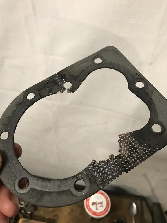

OK guys, here we go again! I decided to test the compression and have no compression in the front cylinder. I know it’s usually the rear cylinder that has issues but that has over 90 psi. Like I said in my first post, I decarboned the heads/valves, reseated and adjusted the valves, new (non-OEM) gaskets and new plugs. Running really rough and loud with misfires and loss of power. Any advice or recommendations before I convert it to a boat mooring?😂
Any input/advice would be greatly appreciated!
Thanks Guys!

Well, I’ll let my new head gasket speak for itself. I’m not sure what happened... was it installer (Me) error, old head bolts that backed out. Not sure. I’m definitely ordering a new OEM gasket kit and new head bolts. I’ve also bought High temp Threadlocker to install this time around. I’ll let you all know how it works. Very relieved it’s not a valve seat! Thanks to everyone for their input!
  • Thanks 2
lynnmor
That gasket does look like inferior material.  Do you know if the head is flat?  I don't think you are to use thread locker on the head bolts, usually you use a drop of oil.

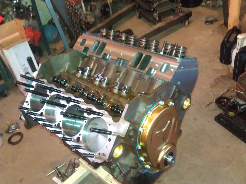

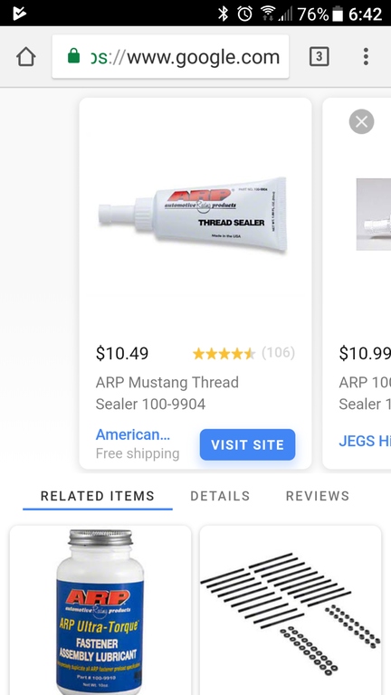

This is what I used on my SBC head bolts, ARP thread sealant...
Howie
Yeah but that is because the head bolts go into the water jacket on the SBC!:)
r1jakecfd
It’s a good lesson in buying OEM parts. Material is completely different material, not aluminized. OEM set on order
WVHillbilly520H
If it's a factory block with through holes the aftermarket blocks have blind holes,  plus this sealer is for the steel to aluminum so the threads don't gall up and you can remove them without breaking the bolts off plus helps get the correct torque reading when installing, Jeff.
