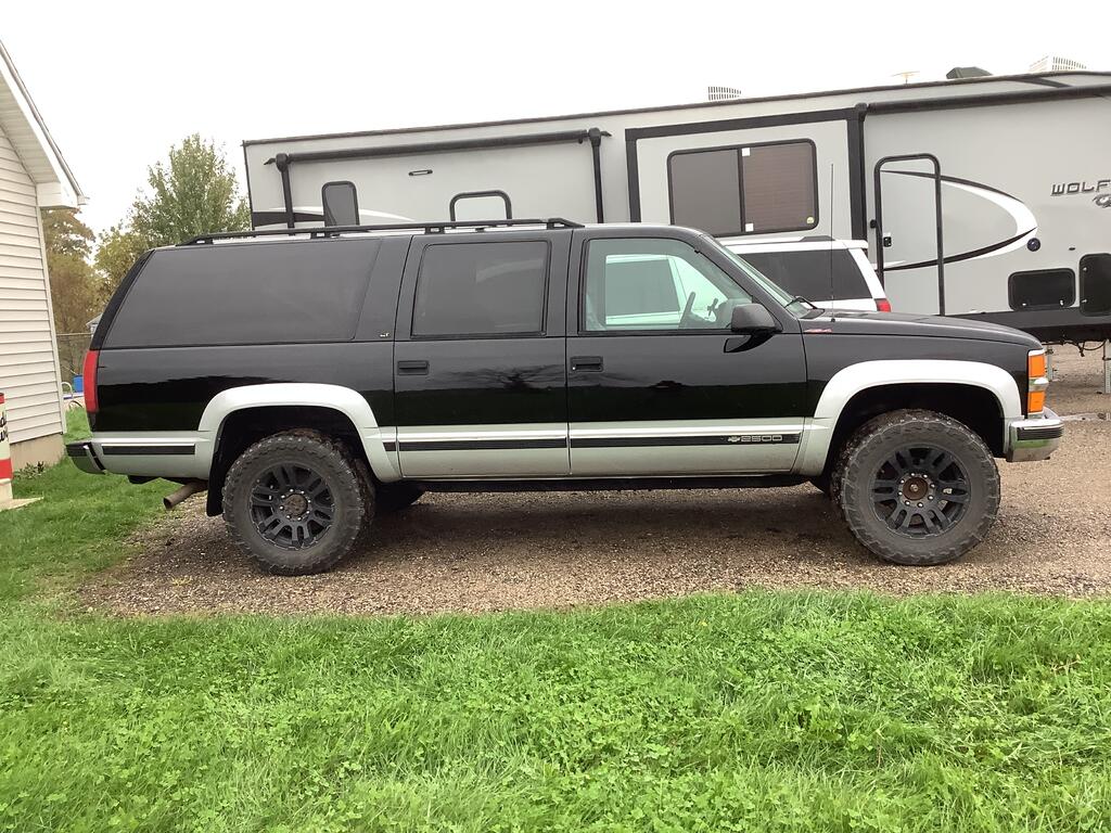

Pullstart 64,591 #876 Posted October 21, 2021 A bit of a torsion bar crank to fit these… but the rubber is in better shape. 3 Share this post Link to post Share on other sites
Horse Newbie 7,202 #877 Posted October 21, 2021 3 hours ago, Pullstart said: A bit of a torsion bar crank to fit these… but the rubber is in better shape. So you crank down on the torsion bar a bit, snd it raised the front ? Share this post Link to post Share on other sites
Pullstart 64,591 #878 Posted October 21, 2021 2 minutes ago, Horse Newbie said: So you crank down on the torsion bar a bit, snd it raised the front ? Yep. Turning the adjustment bolt in puts more tension on the bar. In my teenage days, an S10 was good for about 2.5” lift by just cranking on them… so long as you son’s mind the rougher ride. This is a temporary thing and we’ll soon have a new suspension under it. Share this post Link to post Share on other sites

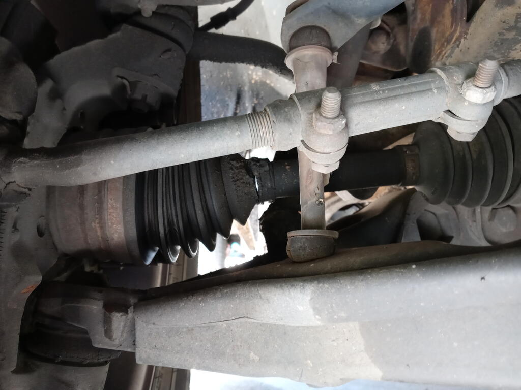

Horse Newbie 7,202 #881 Posted October 22, 2021 29 minutes ago, Pullstart said: Take a picture of it… I’d like to see that I'll get one tomorrow...don't know the correct terminology for all the suspension parts, but there's a little rod about 8 inches long, vertical, with a rubber bushing on each end. I think it goes from what might be a sway bar up to the a frame I believe. There is one on each side. Already pretty sure I need both CV axles..every blue moon I may hear a little crack in them. , but the boots are cracked, so I've heard if you're gonna do the boot, may as well do the whole axle. 1 Share this post Link to post Share on other sites
Pullstart 64,591 #882 Posted October 22, 2021 That’s what it sounded like, but your second explanation helped solidify that. Sway bar end links. They’re practically a 3/8” bolt that feeds through the sway bar and lower control arm. Easy peasy. I couple washers, bushings and a spacer tube and a nut. I’d say cut the old ones off with a sawzall or cut off wheel and replace them both at the same time. If you dry fit them with no tools, you should be able to get them assembled just fine - then tighten them. As for the CV shafts, they take (I think) a 36mm socket and a good breaker bar to get them loose from the hub and (also I think) a 15mm box end wrench or socket to unbolt them from the differential. You should be able to do that without popping the spindles off the a-arms. A dead blow hammer or a big hammer and a block of wood will drive the axle splines out of the hub once it’s apart. I’m a firm believer in DIY as we all pretty much are. Buying whatever tools you need for this job are likely cheaper than paying for it to be done, if you’re able to do it. I know that some day, I won’t be able to turn wrenches like I do now, but if you can there is nothing to be concerned with as far as doing something wrong. Neither of those items affect alignment, just handling and 4 wheel drive 2 2 Share this post Link to post Share on other sites

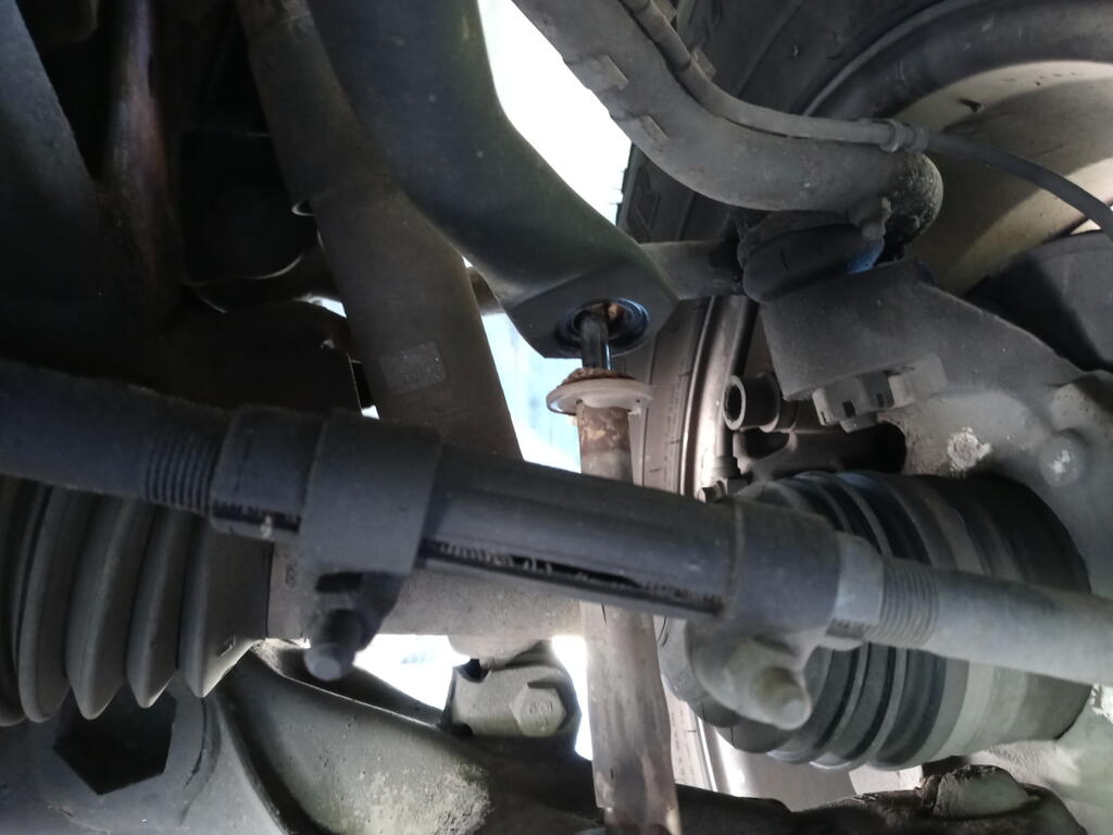

Horse Newbie 7,202 #883 Posted October 23, 2021 On 10/21/2021 at 8:53 PM, Pullstart said: Take a picture of it… I’d like to see that @Pullstart You asked for a pic of my broken front suspension part... In the first pic you can see the rod I was talking about...in the second pic you can see the rod on the passenger side that has the rubber bushings still intake, all-be-it worn, with 274,000 miles on them. Also second pic you can see a crack in the CV boot, passenger side. 1 Share this post Link to post Share on other sites
Jeff-C175 7,203 #884 Posted October 24, 2021 9 hours ago, Horse Newbie said: broken front suspension part Yup, stabilizer bar, sway bar, whatever you wanna call it. That's the easiest front suspension repair to make. But I see those cracked and dry rotted boots too... I could always tell when those sway bar link bushings were worn, every time I hit a bump they would 'jingle' like Santa's sleigh. You could only hear it if you believed though........................................................................ 2 1 Share this post Link to post Share on other sites
Horse Newbie 7,202 #885 Posted October 24, 2021 (edited) @Jeff-C175 I will probably still take it to a shop and let them take a look. With 274, 924 miles on the truck, I'm sure there are probably other suspension parts worn...and like you said the boots...shocks have never been replaced... Edited October 24, 2021 by Horse Newbie 1 Share this post Link to post Share on other sites

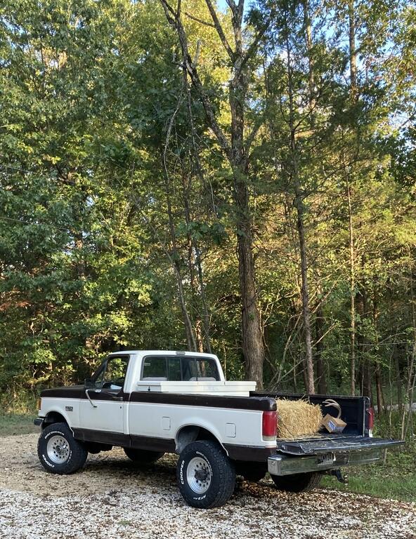

cschannuth 3,817 #894 Posted November 4, 2021 4 minutes ago, slim67 said: Crazy isn’t it? My son bought this rust free, high mileage 1990 with a 460 and a five speed in it for $7000 and I thought he was nuts. He has been offered double that. It is absolutely nuts. That was probably a $14,000 truck when it was new. 2 5 Share this post Link to post Share on other sites
slim67 2,744 #895 Posted November 4, 2021 4 minutes ago, cschannuth said: My son bought this rust free, high mileage 1990 with a 460 and a five speed in it for $7000 and I thought he was nuts. He has been offered double that. It is absolutely nuts. That was probably a $14,000 truck when it was new. Nice practical truck just that way I like them. Regular cab and long bed. 4 Share this post Link to post Share on other sites

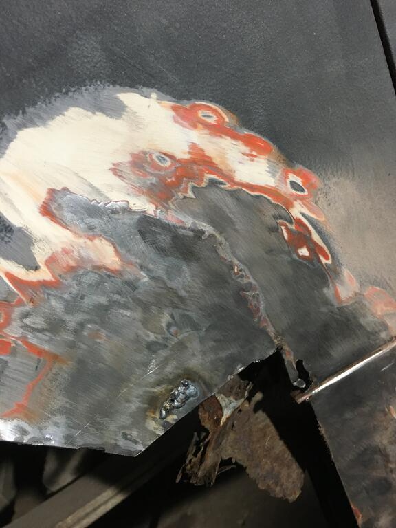

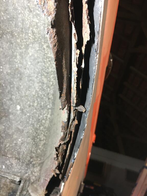

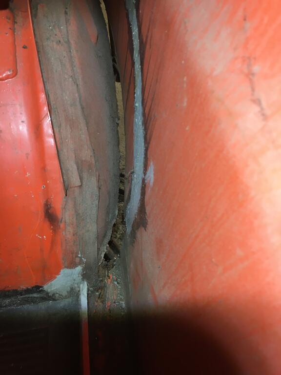

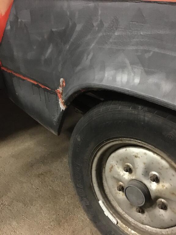

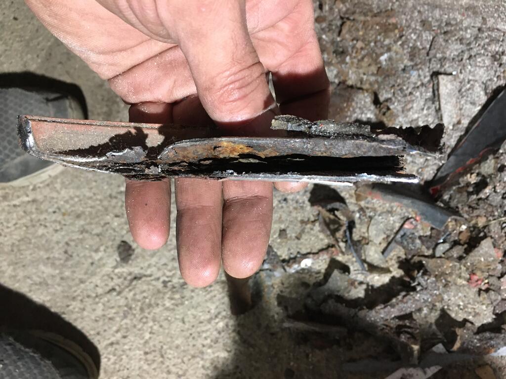

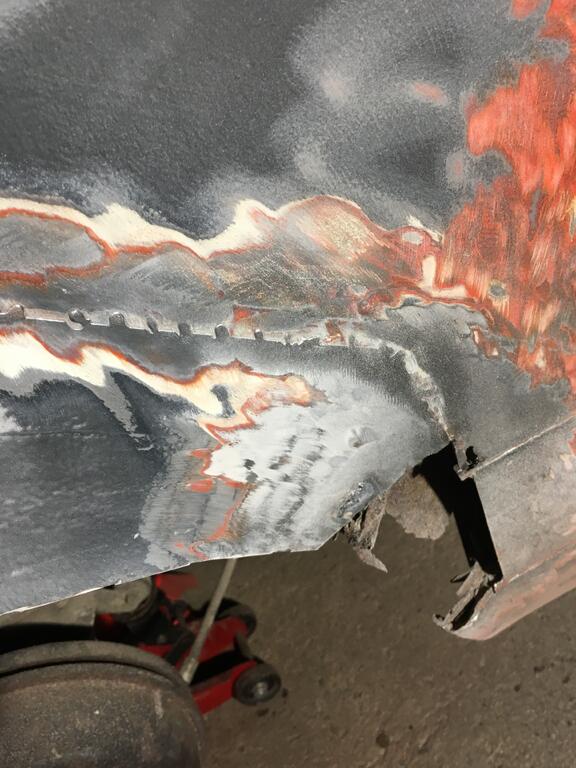

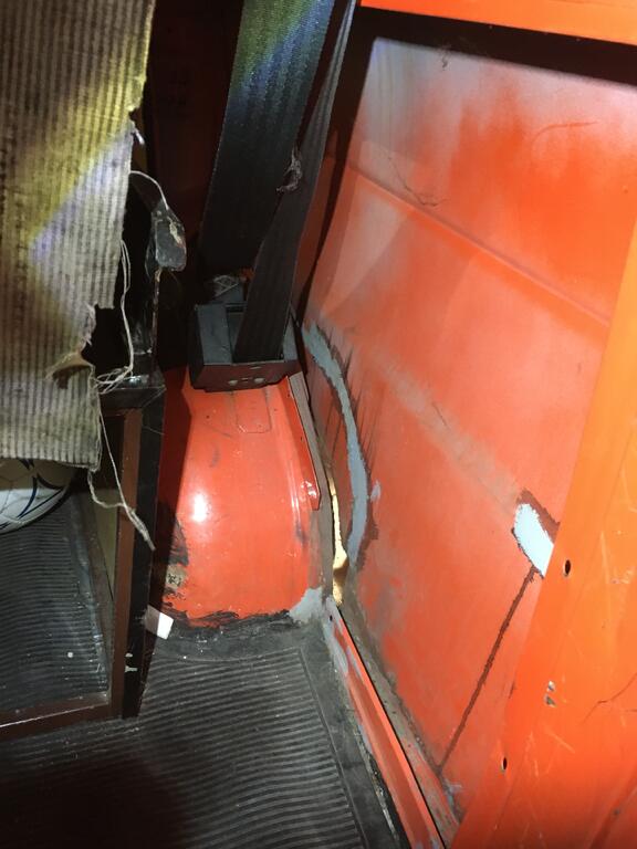

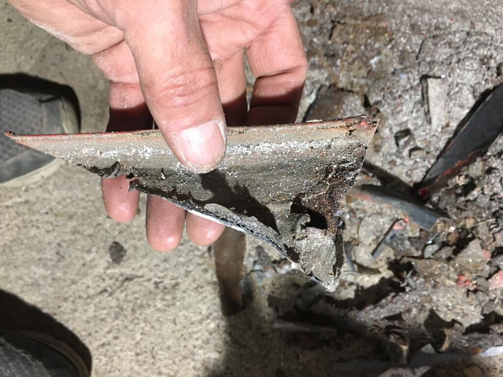

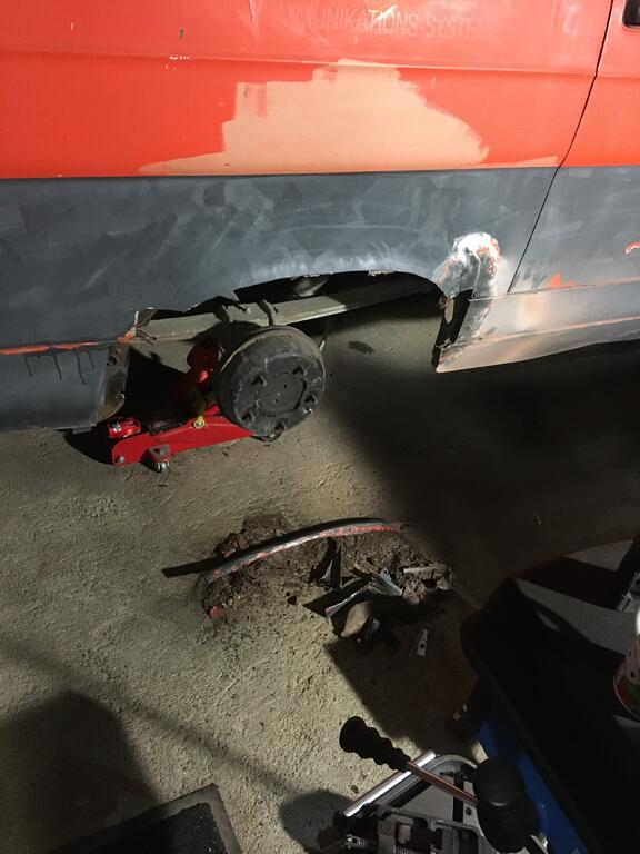

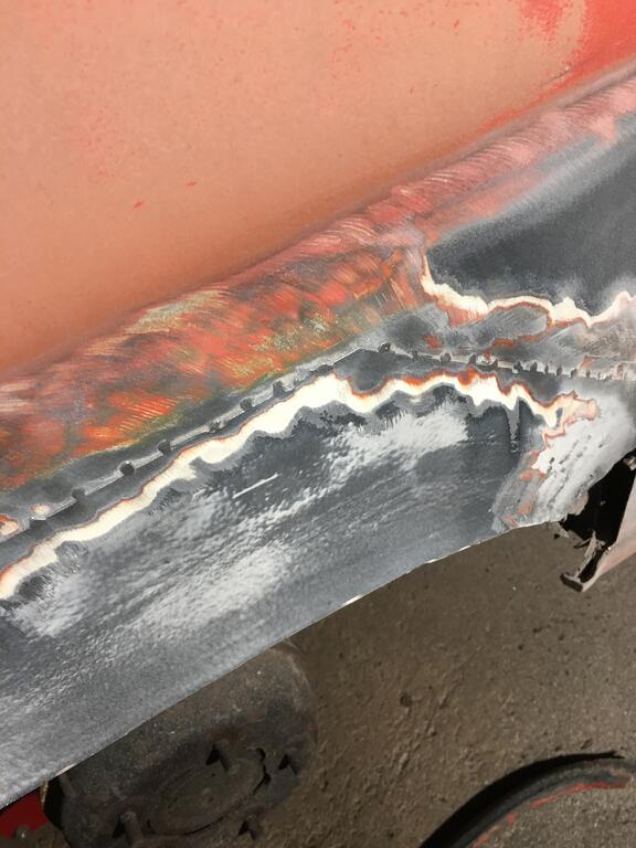

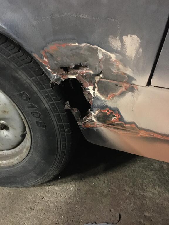

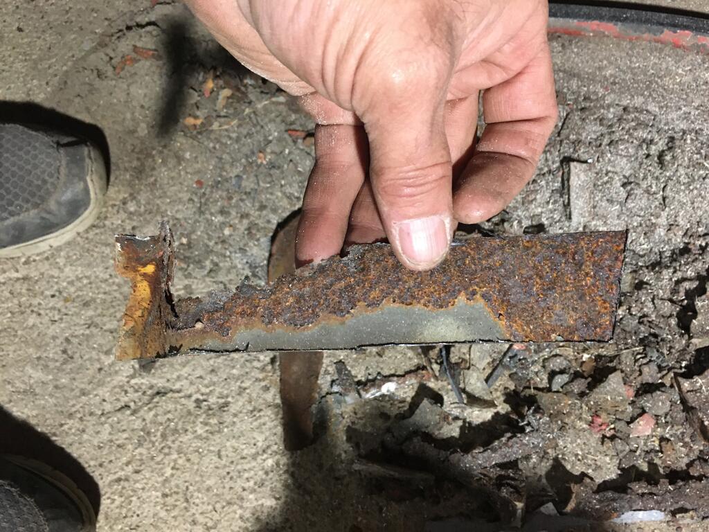

Tractorhead 9,093 #897 Posted November 7, 2021 Began the rework of the Van‘s Rear Fenders. a horribly scenario i found... Never trusted a black lined Car... It hides mostly a unproffessional fixed or dead Bodywork. So i begun to cut out the Areal, to see when i will find good material to fix it clean. Few minutes later i be clear, this gonna be a heavier Bodywork than hoped, but not as bad as i feared. I can be saved, but it needs few squaremeters of Metal. Oh Boy, i must be a complete idiot to start that Rework. Sheetmetal repair was just sticked over the rotten old Metal. time to rework that to save the Rest of the Body. Cut out as far as needed. Wrong corrosion prevention shows the Results... Sadly the first repair was done with too much gunk instead of make it once clean. But there is some good stuff aside so a fixing is not complete imposible, just a dang lot of Work. Reconstruction has begun, 3 squaremeters metal was ordered Doing it Step by step. i have no Hurry, so i can make it Clean again. 2 2 Share this post Link to post Share on other sites
Handy Don 13,340 #898 Posted November 7, 2021 1 hour ago, Tractorhead said: Reconstruction has begun, 3 squaremeters metal was ordered Doing it Step by step. You must have a real sentimental attachment to that van to take this on! Best of luck to you. Automakers have come a long way since the days of that van. Much more attention is now being paid to designing the bodywork to not collect grit and moisture in rust-prone folds and using metal coatings that hold rust at bay for longer. Also, the plastic fender well linings have done a lot to quiet the ride and protect the bodywork. 1 1 Share this post Link to post Share on other sites
