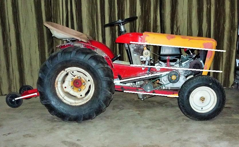

R 1 & 2 are satisfactory. I'm thinking third feels like slippage but maybe it is the high gear ratio
3rd gear is going to cause the most resistance to the belts. Leave the cover off and pull it up to a tree or wall and SLOWLY increase rpm of the engine. Get used to it first, then look at the belts and pulleys while doing it. You should be able to determine what and where it's slipping. PROBABLY A GOOD IDEA TO CHAIN IT DOWN TOO!
I'm guessing the trans pulley. Appears from the pics you are using a smaller belt when the trans pulley is designed for a 5/8 w belt plus it's the pulley with the least amount of contact area with the belt. The front pulley on the jack shaft looks full of belt to the outer edge but the idler pulley looks 1/2 empty of belt. Can't really see the trans pulley where the belt is.
Loosing the belt loop around that idler will allow for more belt contact around the trans pulley.

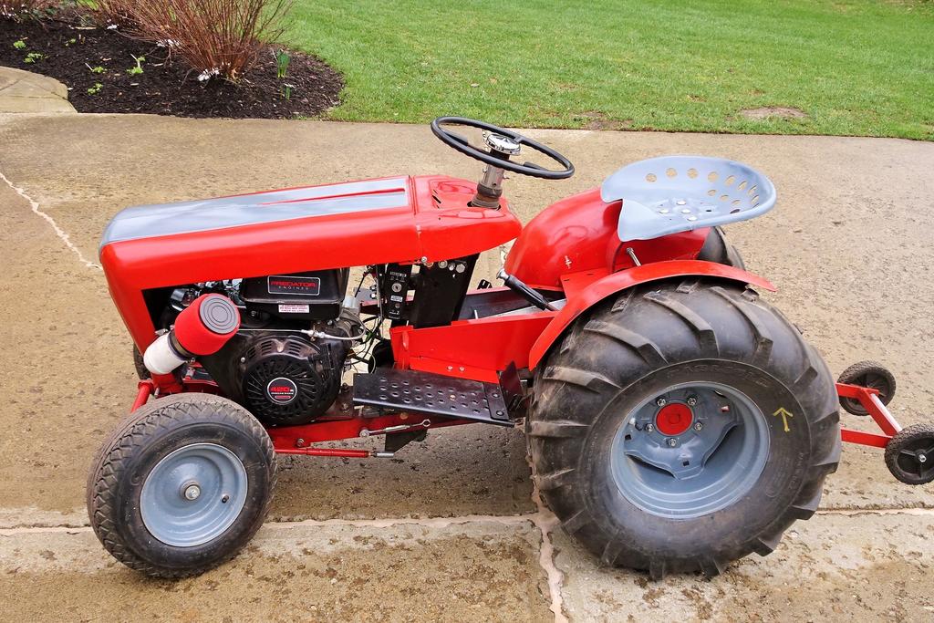

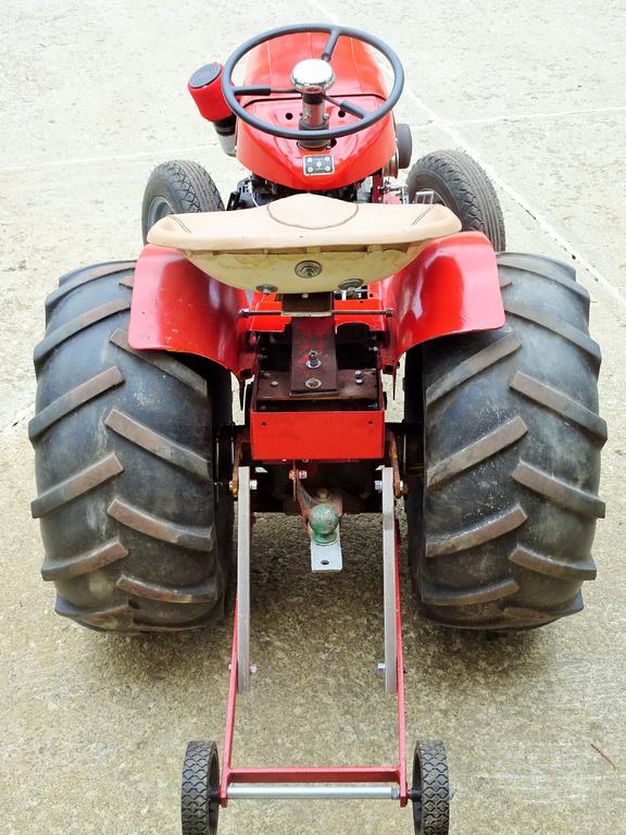

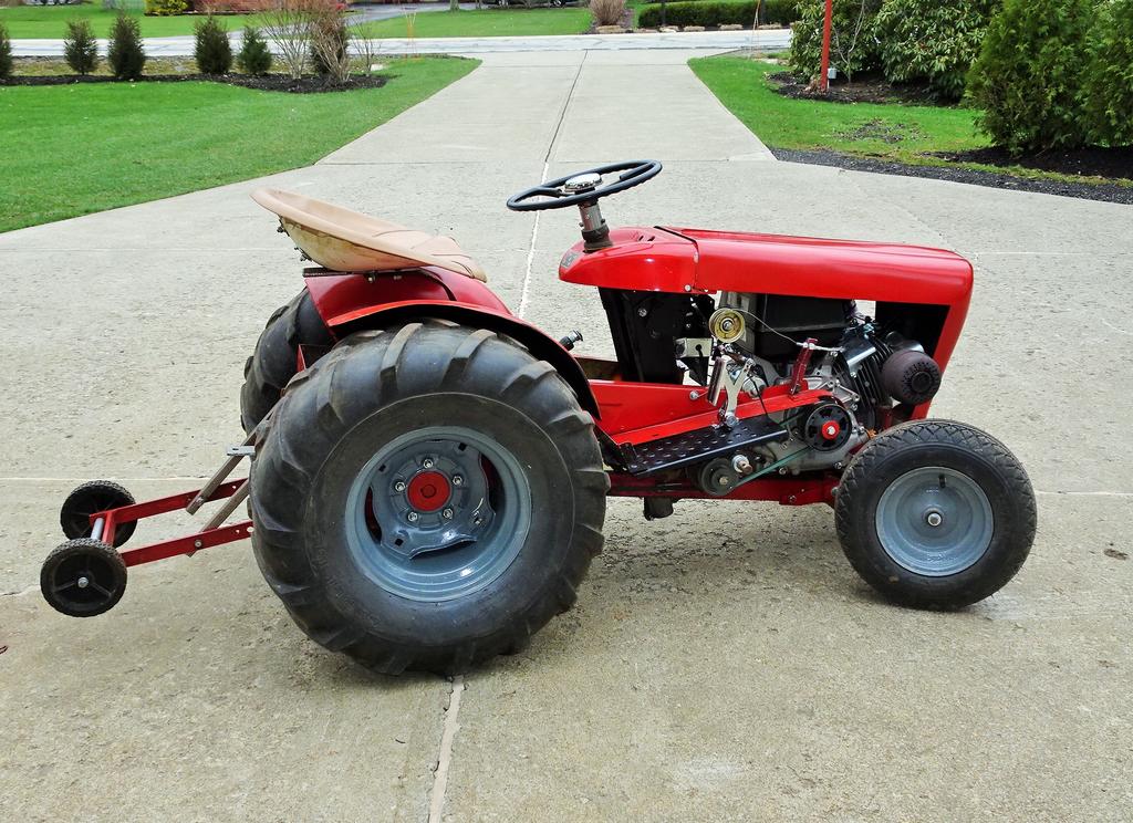

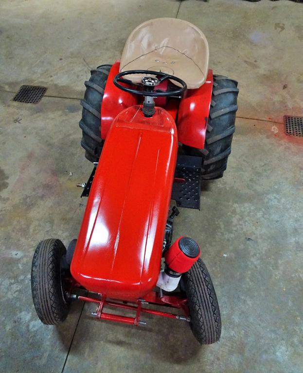

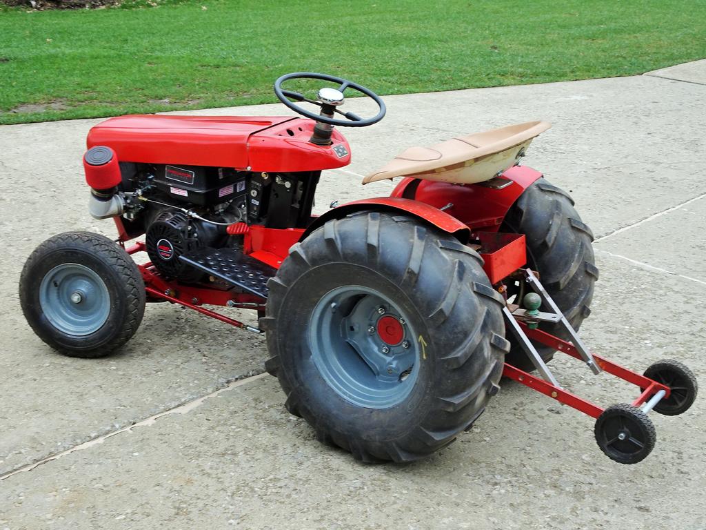

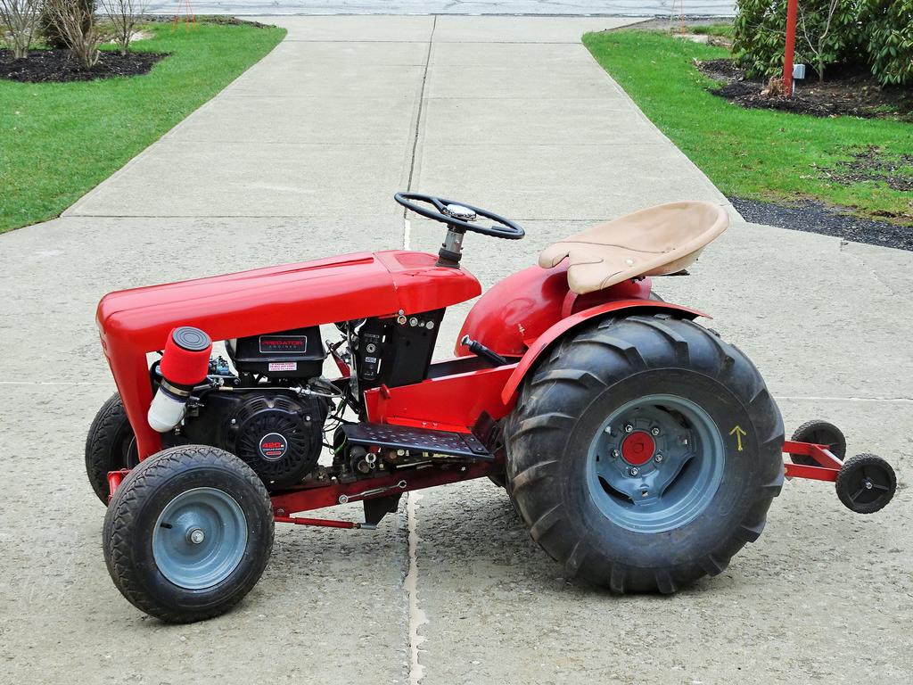

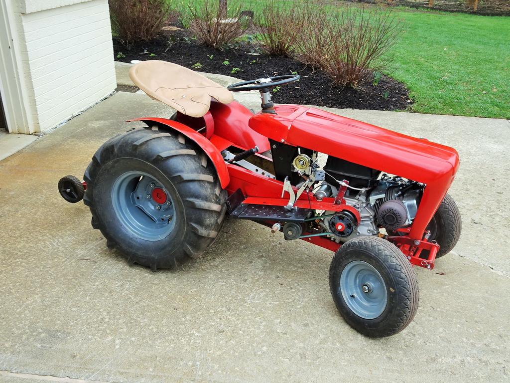

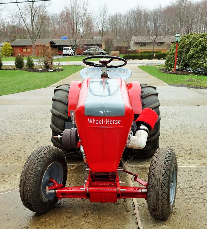

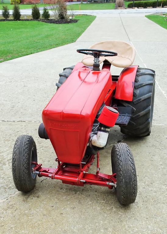

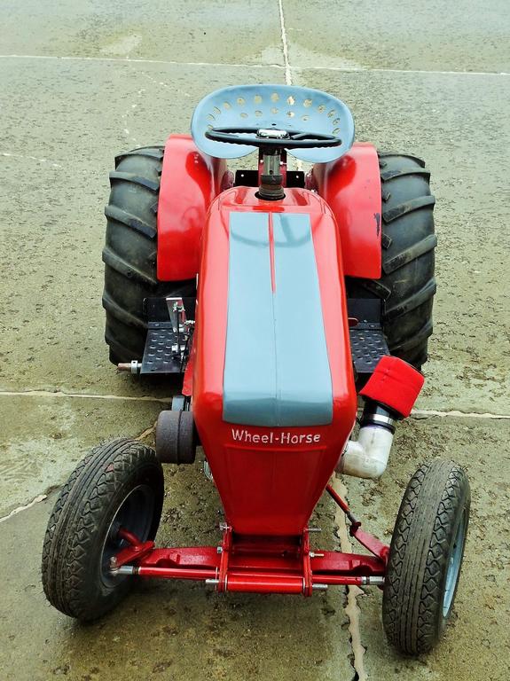

Before I look at the pulleys as wallfish has suggested I decided to start the bodywork. The Rust-oleum gloss marigold is my base color. I like how it makes the Krylon gloss banner red look richer, smoother and creamy. The difference is noticeable between the round dash and the red only belt guard. I believe my First Born is pleasing to the eye is due to the symmetry as the white lines show. But then again "beauty is in the eye of the beholder," or maybe its the beauty, only a parent can love. Anyway, I wonder how I lucked out with those lines.
giddyap

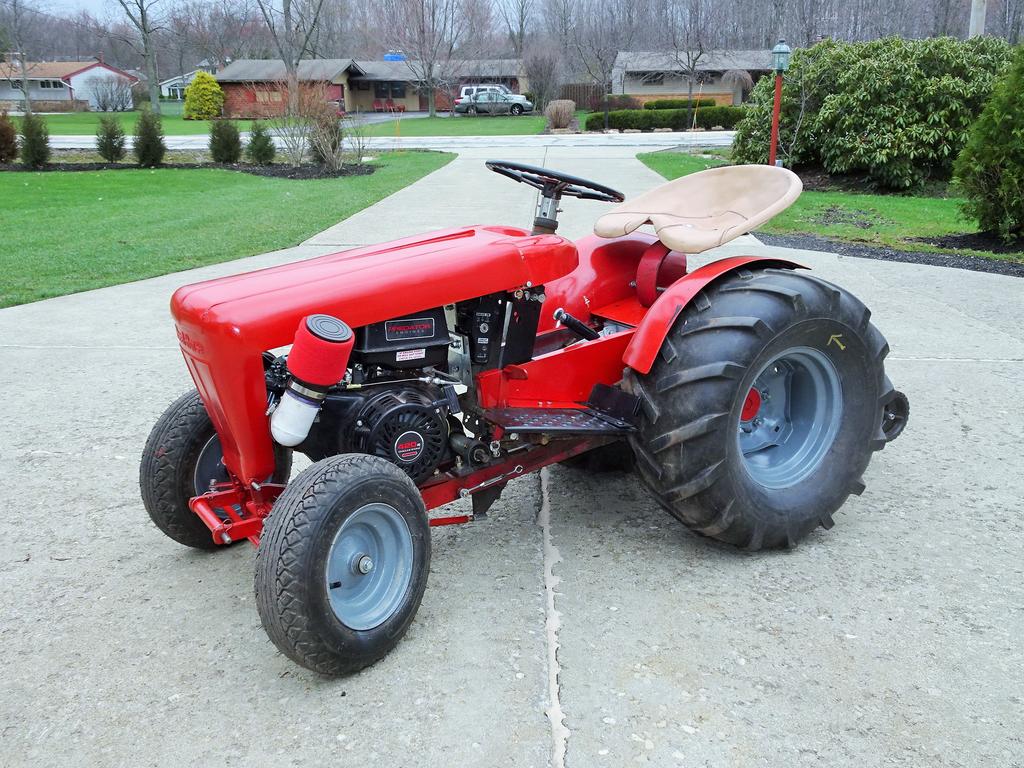

It feels like a long time since my last post and If it weren't for the winter weather in April, it may have been much longer. I managed to start the body-work and my yard work and then when it got cold again I threw some paint on my "First Born". It's good enough to satisfy the call for "more pictures", but... WARNING - defects, do not enlarge the pictures. I plan to finish the "finish" aka surface appearance at some later date. With that on the back burner, I plan to tackle the belts, AGAIN. With the suggestions given by wallfish in his last reply, I am confident I can resolve all the driveline gremlins. Now I have a confession. The last picture is my other restored Suburban, but it's far from original. So I am now acquiring parts to make it my next custom project sometime down the road. One question, Whatz ya all think about the smoke gray wheels?

Man. ... if my actual finished finish work looked as good as yours I'd be a few solid steps ahead of my current finished finishes.
:handgestures-thumbupright: for the gray wheels.
  • Haha 2
Achto
Looking great !!! :text-bravo:
dells68
At first I started to veto the gray, but it's growing  on me.  Kind of makes me think of the old Massey tractors.  Good job!
5 hours ago, dells68 said:
....... Kind of makes me think of the old ............. tractors.  Good job!
What I was thinking too.
Good color to give the "old tractor" look.
oliver2-44
I too like the grey wheels. Maybe go with a gray seat or  a gray stripe on the bottom edge of the hood to tie it together

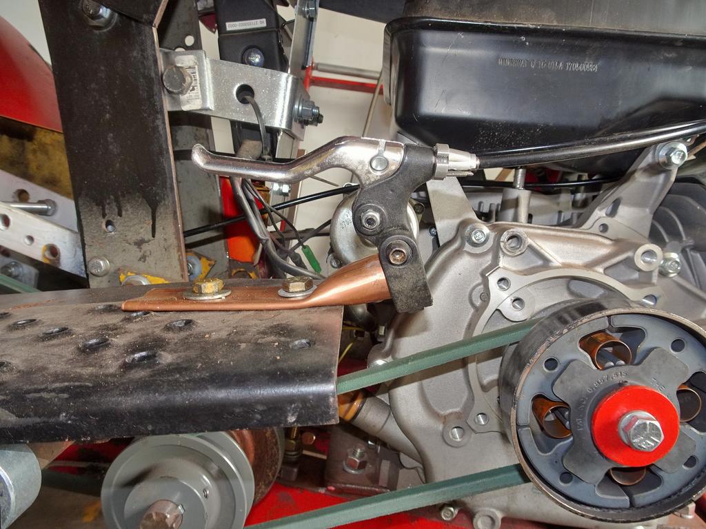

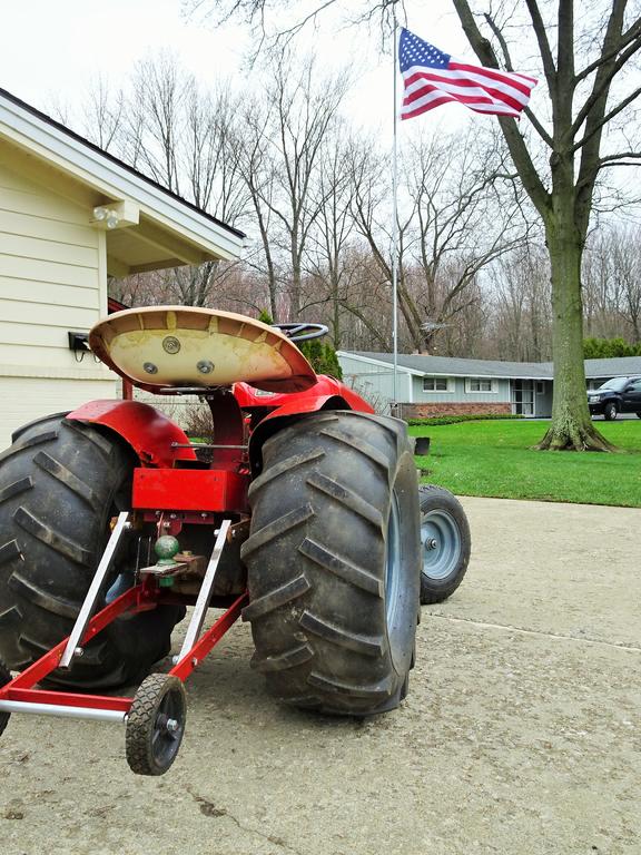

I just made a huge improvement with the gas pedal. Went to the bike shop and got a handlebar lever that is spring loaded. Works great. But...... I broke the trans. Snapped a gear or the axle - free spinning no brake. Gotta investigate if a 8- speed matches up with the frame..... Oh well
  • Sad 3
giddyap
Snapped the axle on the Commando trans I had used. One hub pulled off by hand the other is still resisting. Last resort, I may cut the axle and work separating the two on the vise. Sure hope the trans I'm taking from my other Suburban gives up its 3 lug hubs and these fit. The two white bars support the Cub (Ross) Steering column to the tool tray. Three weeks to the Big Show should be enough time to finish.
