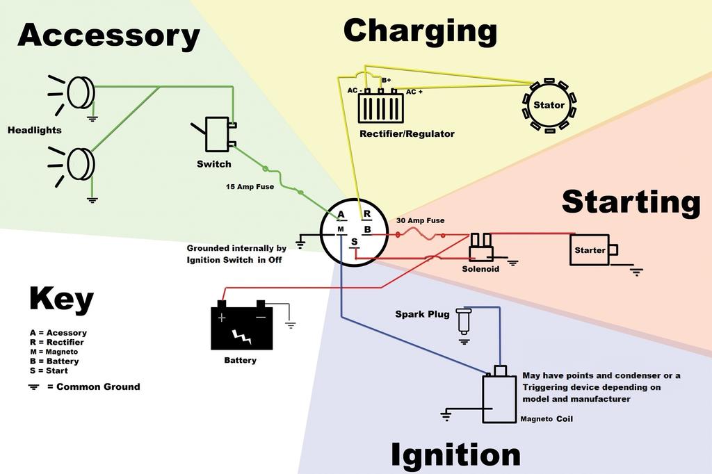

If your Raider has the ignition switch that powers the starter directly rather than using a solenoid the switch probably is the problem. Here are a couple wiring diagrams you may want to use to get away from the older style switch. One is for battery powered ignition with points and the other is for electronic. Raiders came both ways depending on the year.

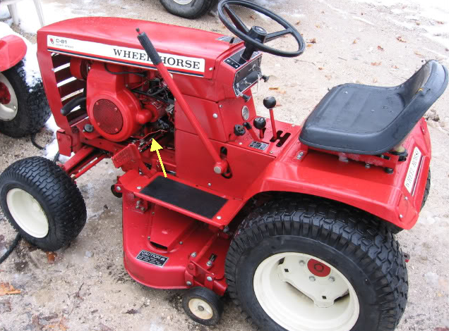

I'm going to venture a guess that your problem lies in this area:
The arrow points to the engine anti-vibration cradle. The cradle is isolated from the frame with rubber mounts. Therefore, it is not grounded to the frame or battery. So Wheel Horse added a separate ground wire from the cradle to the frame. Your starter ground is made through the bolts that connect the starter to the engine block. The block is grounded to the cradle through the mounting bolts, and the cradle is grounded to the frame via a 6 or 4 gauge cable. The battery connects to the frame and completes that ground circuit to the starter.
Check this ground path first. It is a common problem with all 1978 and later tractors with the cradle mount.

The only reason I included the two drawings is that we didn't know what year Raider 10 we were dealing with. With the additional information I am thinking that the first step should be to clean and tighten ALL electrical connections including grounds. I would also suggest moving the ground cable to the engine block.
