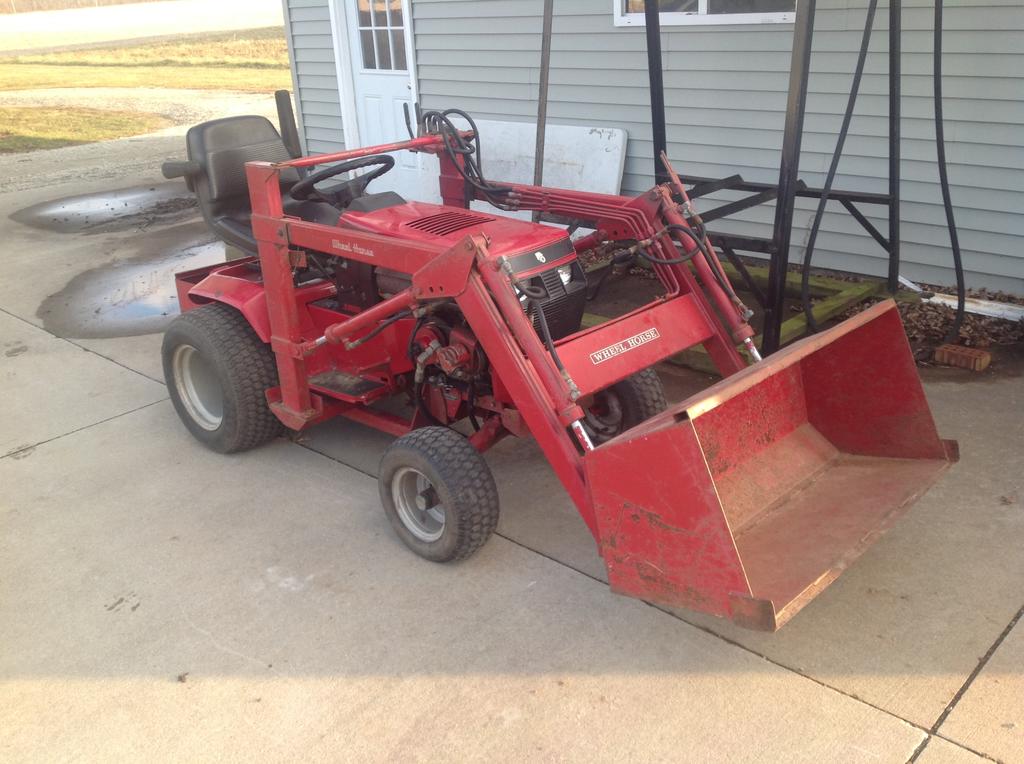

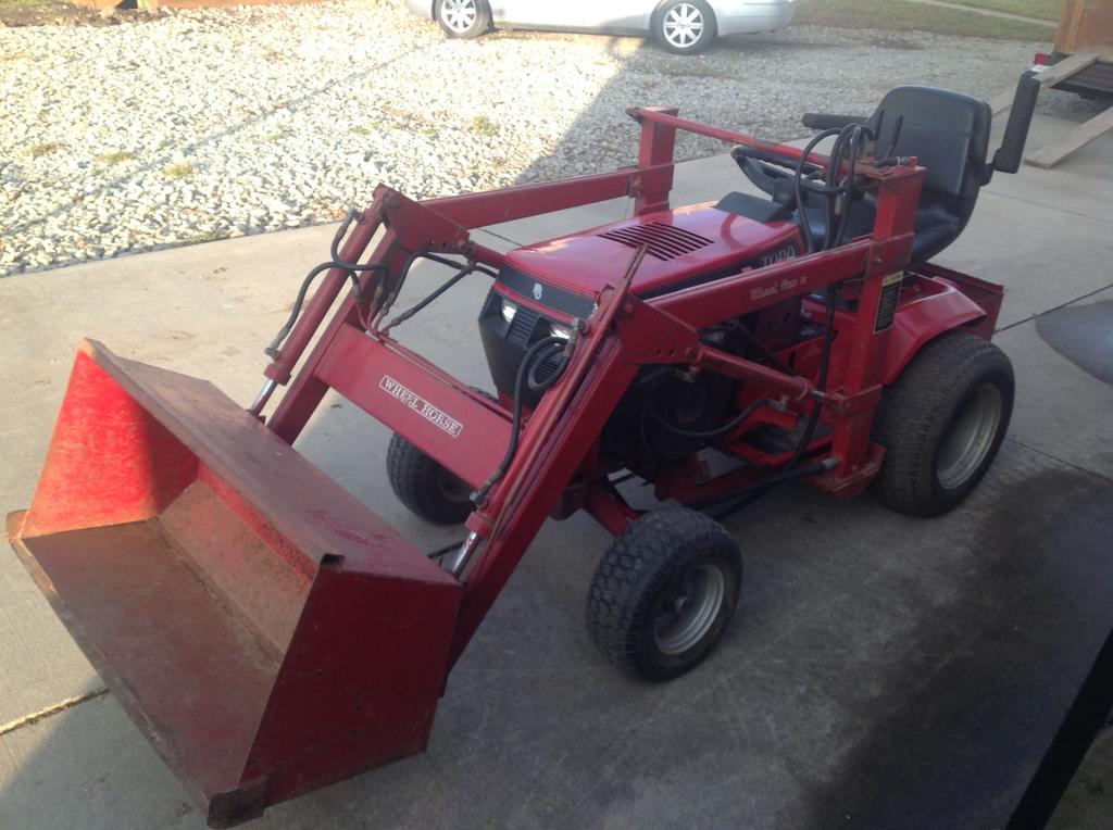

Adams94 1,068 #1 Posted December 23, 2017 It's on my 520-8. Just need 2 braces and a new belt!! 6 8 Share this post Link to post Share on other sites
953 nut 56,159 #2 Posted December 23, 2017 Let it snow, you are ready! 2 Share this post Link to post Share on other sites
wfrpalm 218 #3 Posted December 23, 2017 Cool, wish I had that set up. 1 Share this post Link to post Share on other sites
muz123 1,192 #4 Posted December 23, 2017 Nice setup! Looks great! 1 Share this post Link to post Share on other sites

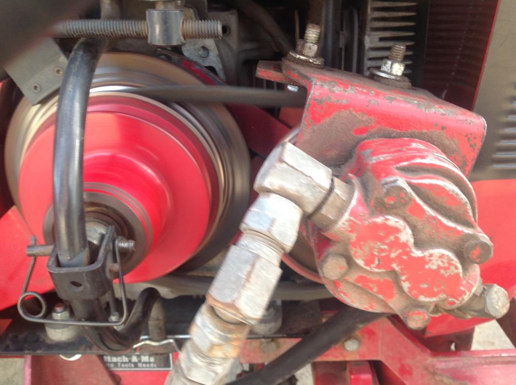

Adams94 1,068 #5 Posted December 23, 2017 Thanks! I just changed the pump mounting so it's moved forward some and the belt now works! Now just need braces, although looks like the fitting on the top of the pump will be in the way for that brace more configurations needed Share this post Link to post Share on other sites
richmondred01 2,268 #6 Posted December 23, 2017 Very nice and the ever elusive 520-8 too. Great. 1 Share this post Link to post Share on other sites

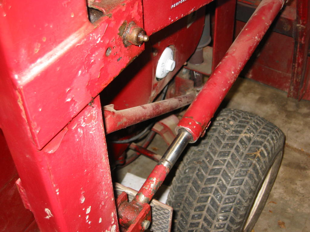

roadapples 6,983 #9 Posted December 24, 2017 @Adams94 braces on mine (same loader) are 36"OA and 34.5" hole to hole. My right brace goes under the pump. It's close but clears by about 1/8" 1 Share this post Link to post Share on other sites

Adams94 1,068 #12 Posted December 24, 2017 (edited) 9 hours ago, roadapples said: @Adams94 braces on mine (same loader) are 36"OA and 34.5" hole to hole. My right brace goes under the pump. It's close but clears by about 1/8" Thanks! Is it the same size steel as the cross tube at the top, could you take a picture of your pump and how the brace goes through there? 1 hour ago, ebinmaine said: Exactly what I was thinking! I may have a tiny bit of loader-envy..... I don't blame you lol Edited December 24, 2017 by Adams94 Share this post Link to post Share on other sites

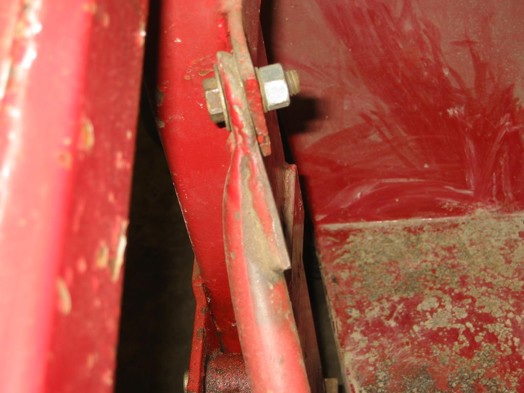

wallfish 17,112 #13 Posted December 24, 2017 (edited) 16 hours ago, Adams94 said: looks like the fitting on the top of the pump will be in the way for that brace Loosen those fittings and adjust them so they're closer to the tractor and re-tighten. Kind of like the bottom one is. If necessary the brace can be spaced out a little where it bolts onto the front brace bracket with washers but it should fit past the pump. Edited December 24, 2017 by wallfish 2 Share this post Link to post Share on other sites
Adams94 1,068 #14 Posted December 24, 2017 31 minutes ago, wallfish said: Loosen those fittings and adjust them so they're closer to the tractor and re-tighten. Kind of like the bottom one is. If necessary the brace can be spaced out a little where it bolts onto the front brace bracket with washers but it should fit past the pump. I’m going to play with it a little today. Thanks! Share this post Link to post Share on other sites
roadapples 6,983 #15 Posted December 24, 2017 4 hours ago, Adams94 said: Thanks! Is it the same size steel as the cross tube at the top, could you take a picture of your pump and how the brace goes through there? I think the tube is the same. Sorry, too dumb to do pictures... 1 Share this post Link to post Share on other sites
Adams94 1,068 #16 Posted December 24, 2017 5 minutes ago, roadapples said: I think the tube is the same. Sorry, too dumb to do pictures... I understand lol 1 Share this post Link to post Share on other sites
pfrederi 17,974 #17 Posted December 24, 2017 Tubing on my D200 is 1-1/16" OD (Same a cross bar) Note on one side someone welded on reinforcing plates...Probably a good idea 2 Share this post Link to post Share on other sites

MalMac 1,332 #19 Posted December 29, 2017 I have never noticed on the Onan that there was auxiliary mounting holes for the pump bracket. Is that what is mounted to? Share this post Link to post Share on other sites
Adams94 1,068 #20 Posted December 29, 2017 9 hours ago, MalMac said: I have never noticed on the Onan that there was auxiliary mounting holes for the pump bracket. Is that what is mounted to? There's is one unused threaded hole above the frame and jus tin front of the pto and the other goes into the front bolt of the upper pto arm mount Share this post Link to post Share on other sites
