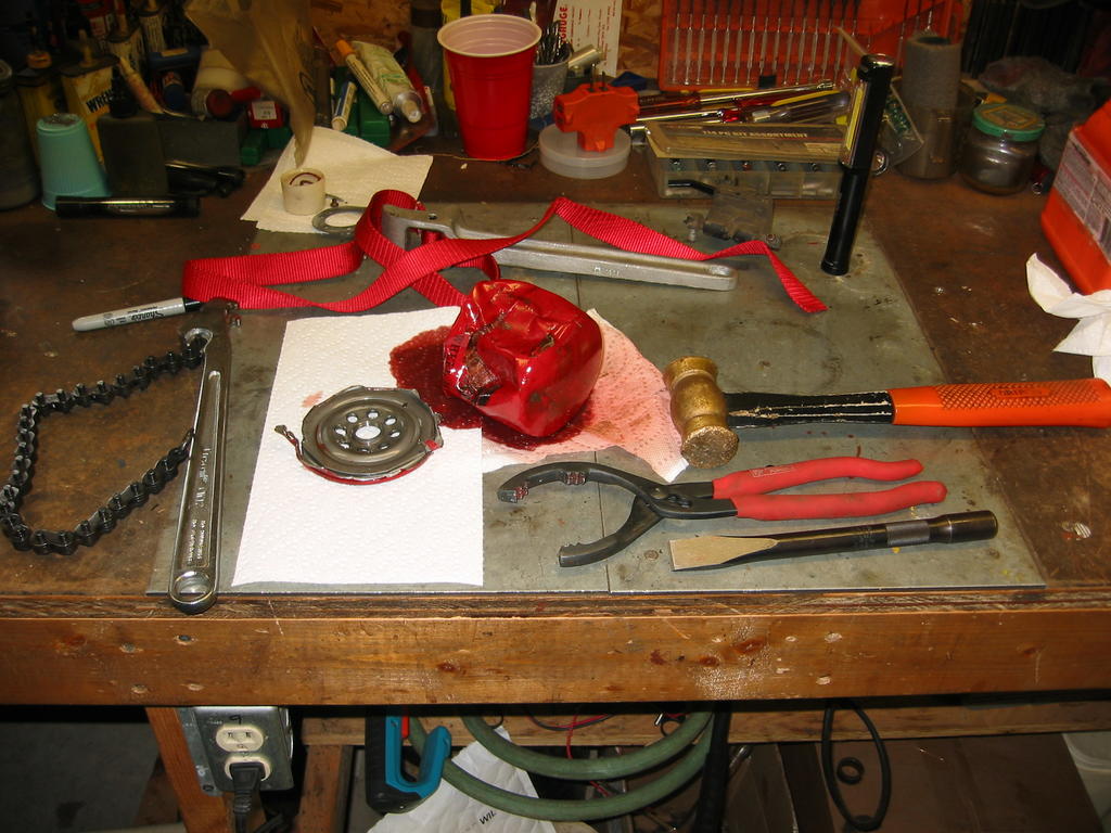

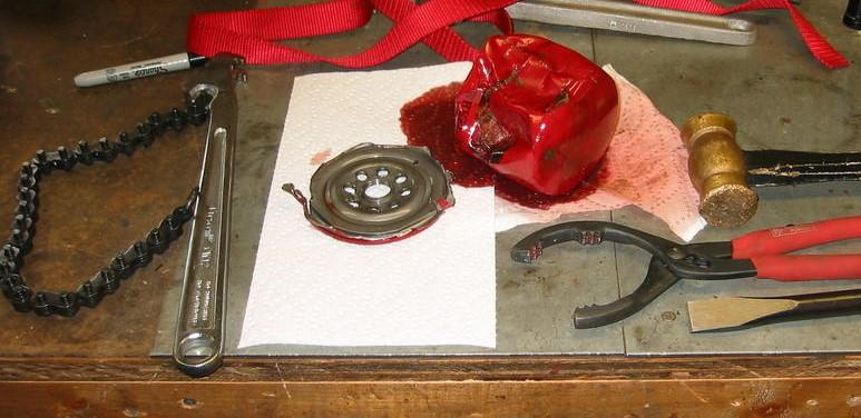

pfrederi 17,515 #7 Posted December 24, 2017 Victory...Tried filter pliers (no movement), strap wrench (slipped), Chain wrench (crushed the filter housing, couldn't get close to the inside edge because the parking brake shaft was too close to the filter. Hammer and chisel won the day 5 Share this post Link to post Share on other sites
953 nut 54,361 #8 Posted December 24, 2017 1 hour ago, pfrederi said: Hammer and chisel won the day works every time. 1 Share this post Link to post Share on other sites
AMC RULES 37,102 #9 Posted December 24, 2017 The before... ...and then, beaten to a bloody pulp. 2 Share this post Link to post Share on other sites

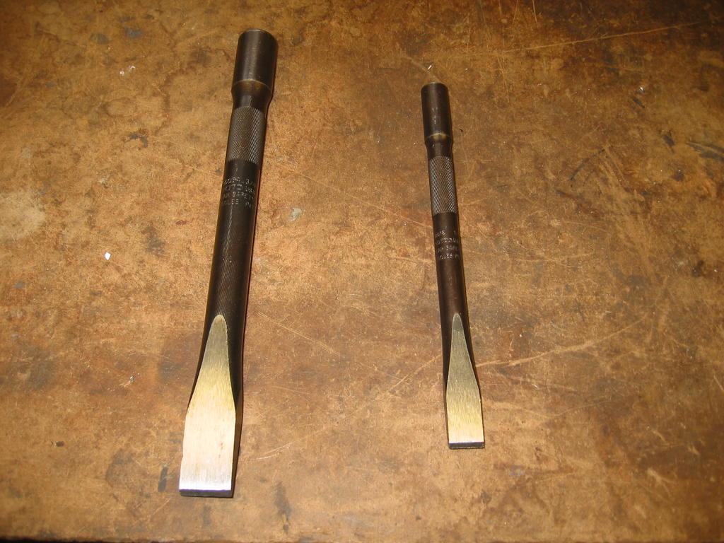

Sarge 3,462 #13 Posted December 26, 2017 I spy a very interesting looking chisel - what brand is that ?? Older Chrysler slant six engines were notorious , folks would crank their filters down and generally had to use pry bars to roll back the face plate enough to crack them loose - even a chisel wouldn't work . Book said hand tighten , and they meant it - by hand only , no tools , fool....lol . Sarge 2 Share this post Link to post Share on other sites
pfrederi 17,515 #14 Posted December 26, 2017 1 hour ago, Sarge said: I spy a very interesting looking chisel - what brand is that ?? Older Chrysler slant six engines were notorious , folks would crank their filters down and generally had to use pry bars to roll back the face plate enough to crack them loose - even a chisel wouldn't work . Book said hand tighten , and they meant it - by hand only , no tools , fool....lol . Sarge Proto Bought them a couple years ago to replace the ones i got from my Father. The were at east 75 years old and had spent most their life breaking cement and rocks.... 2 Share this post Link to post Share on other sites
squonk 40,736 #15 Posted December 26, 2017 (edited) On 12/24/2017 at 12:34 PM, pfrederi said: Victory...Tried filter pliers (no movement), strap wrench (slipped), Chain wrench (crushed the filter housing, couldn't get close to the inside edge because the parking brake shaft was too close to the filter. Hammer and chisel won the day It's bleeding! I used to run into stuck filters on Chevy motorhomes. They always seemed to have about 20,000 miles on them and they had the black AC-Delco filter that was installed at the factory. We would always end up puncturing the can and tearing it all off leaving the round metal filter mounting which is on the left in Paul's pic. Used an air hammer with a punch in one of the holes and applied pressure in a counter clockwise direction. 95% of the time it would come off. The other 5% the oil filter threaded block adapter would shatter. Luckily this was a cheap cast iron piece held on with 2 bolts. You couldn't get to the bolts with the filter base on but once it broke off it was a matter of putting it in a vise and getting the bolt. Used to keep a few adapters in stock just for this occasion. Edited December 26, 2017 by squonk 1 Share this post Link to post Share on other sites
Sarge 3,462 #16 Posted December 28, 2017 I figured it had to be a high quality brand - those rock chisels are made from some interesting steel for sure , wish they still made them from whatever that alloy was...Proto makes some very good tools even today . Sarge Share this post Link to post Share on other sites
