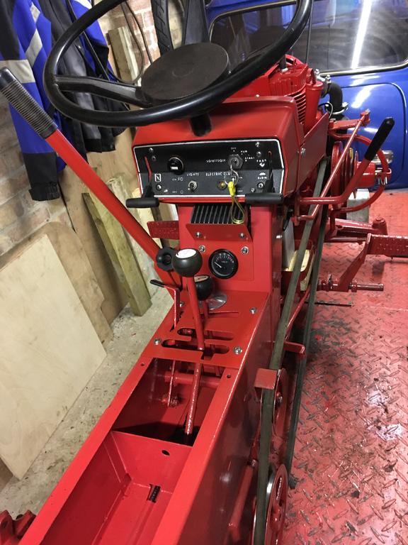

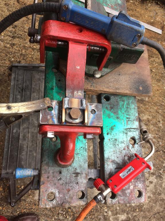

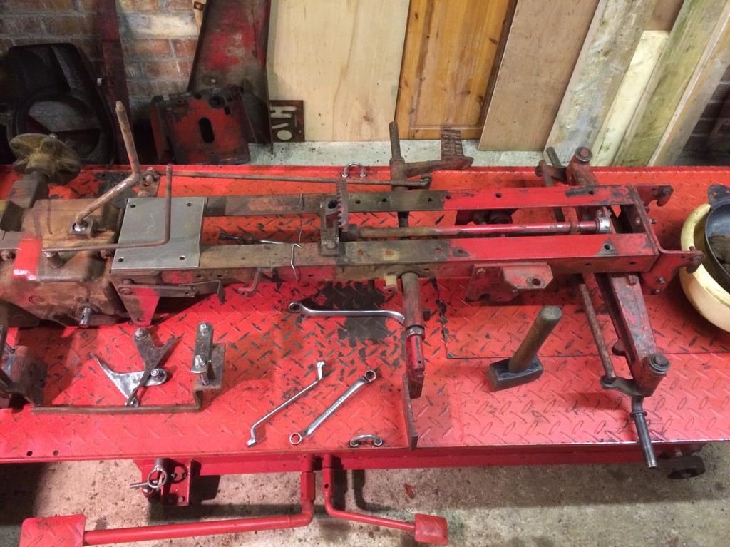

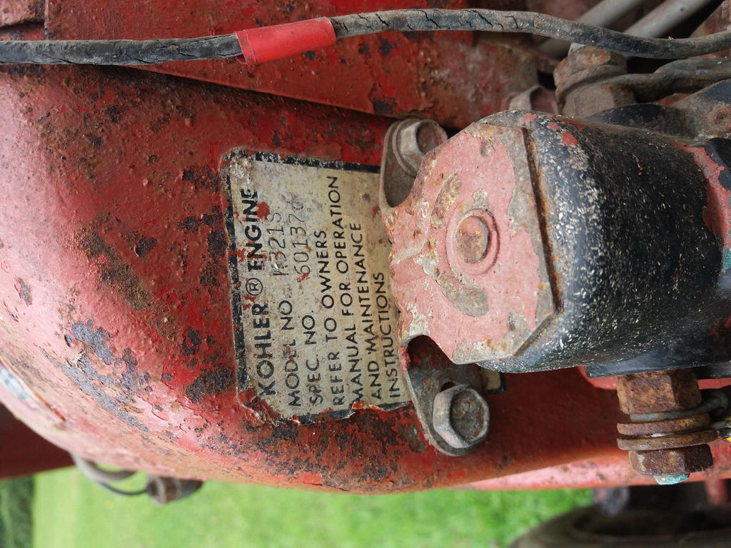

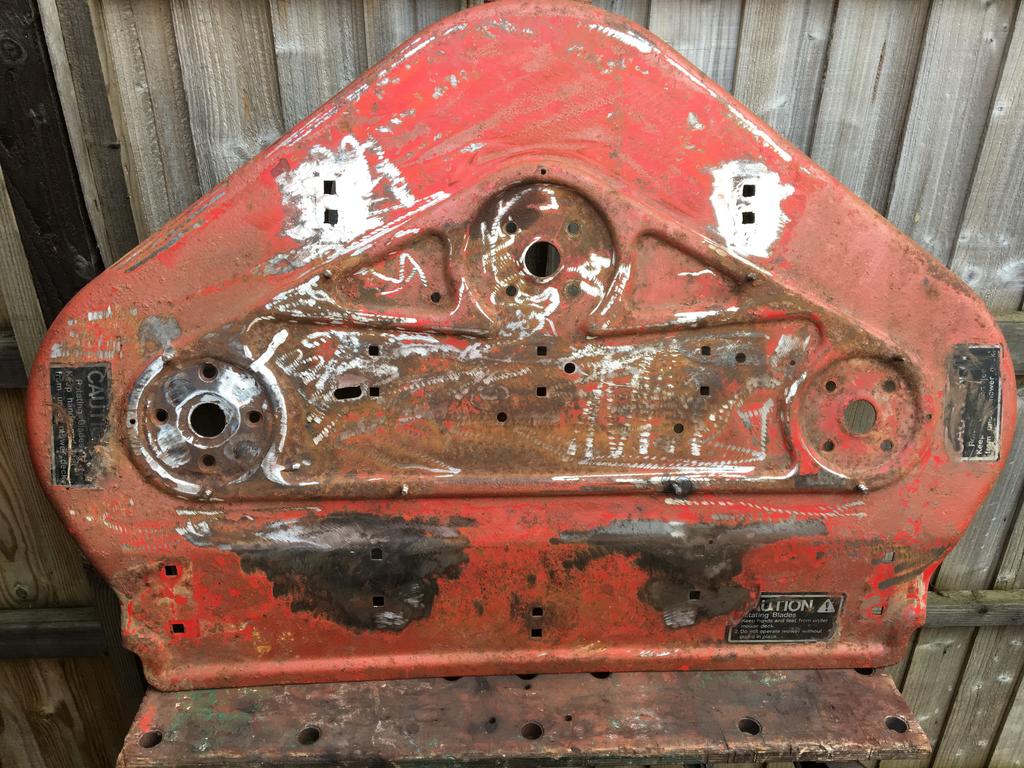

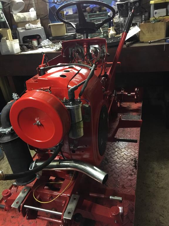

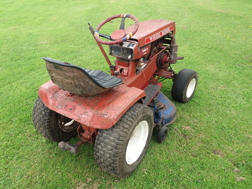

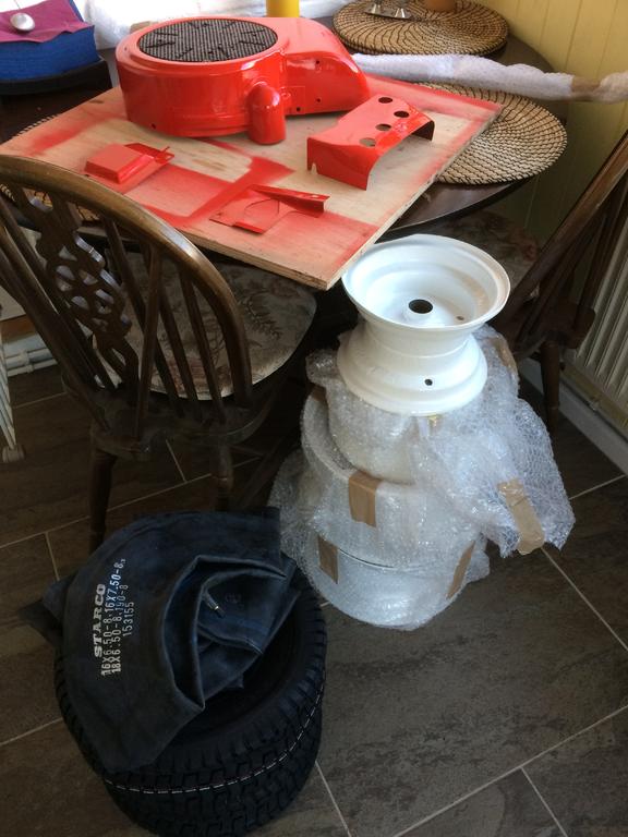

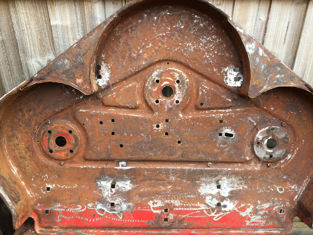

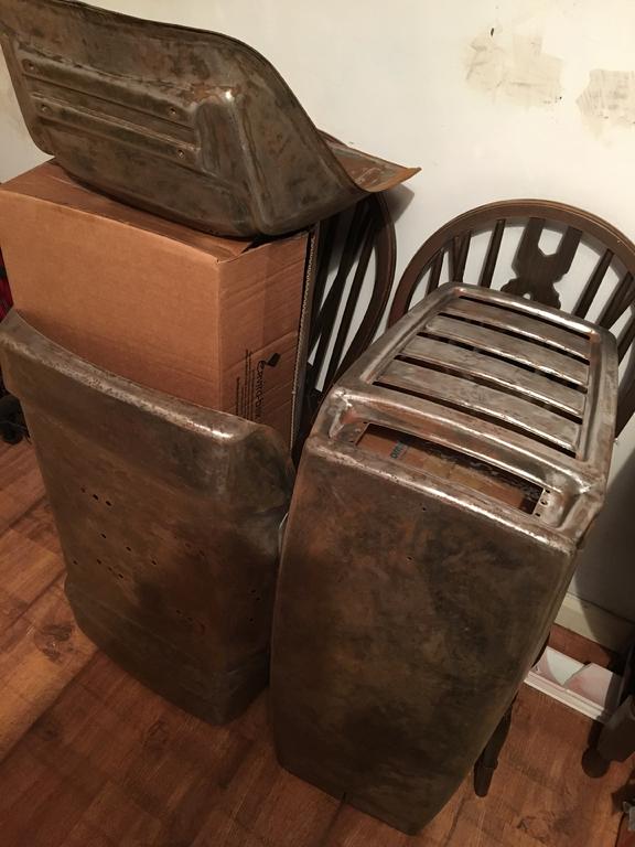

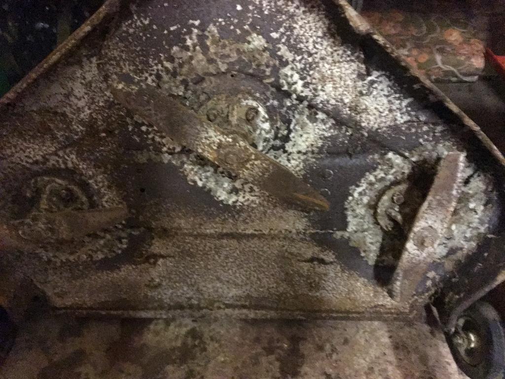

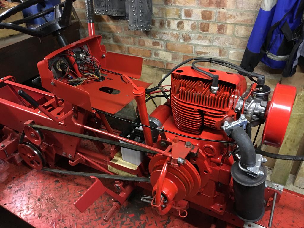

Graydon 62 #9 Posted December 20, 2017 A Big thank you to everyone for your offers of help and support, its very much appreciated. I've posted some photos of my raider 14, starting from when I purchased on October 8th 2017 up to the present day. She did initially look in reasonable condition, however, hadn't been used in over twelve years. Although she looked reasonable, time, negligence, combined with the damp welsh climate had taken its toll, so absolutely nothing functioned. The only bonus was the engine did turn over freely by hand and had compression. The "toe out" on the front wheels was so excessive, it was near impossible to push her up into my van. Hopefully now fitted with new adjustable tie rods and new front wheel bearings, there should be a vast improvement. I'm not going to bore everyone with a complete list of all the repairs so far to date, however, I did manage to save a considerable amount of money by dismantling the starter solenoid and repairing the inner workings. This past week or so, I've been completely stripping the cutting deck and have welded all the cracks, splits and unwanted holes in the cowling. I've also needed to order all new cutter bearings and spindles, plus a new drive belt. Unfortunately yesterday the carburettor had decided to start flooding, the big worry being fuel pouring on to a hot exhaust! Then to top that the starter motor packed up! Luckily, only new brushes needed. Can I buy any in the UK? not a chance, I did however, managed to find some in the US on EBay, although, the shipping was more than the cost of the brushes. Unfortunately, I managed to ruin the nice new paint on the starter motor, very annoying. IMG_2276.MOV Share this post Link to post Share on other sites

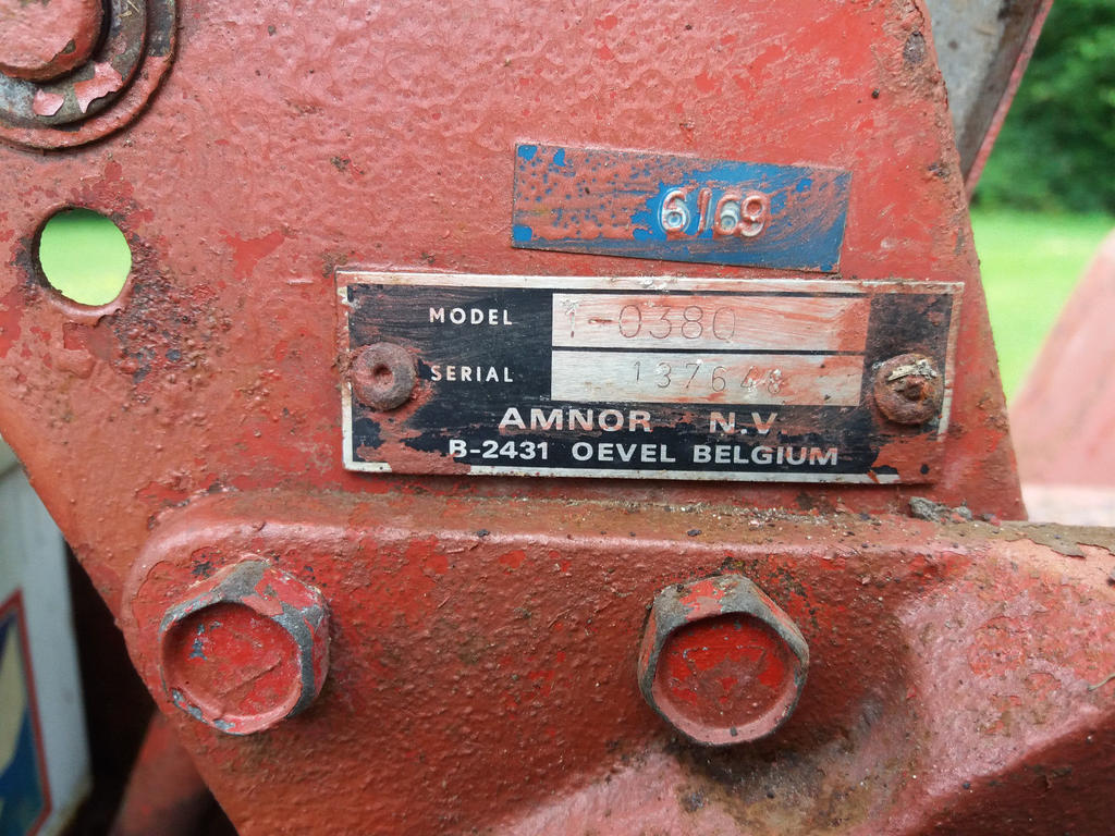

Anglo Traction 761 #10 Posted December 20, 2017 (edited) Found the Edited pics . Some very good work your doing there. Will be a real nice example. 1-0380 Model number is listed as a 1974 C-160 !, but then. it was assembled in Belgium !. Notorious for nonconformity of the Model Ranges. Still, 14hp is as good. You are covering much of the same work like Solenoid/Deck etc that I had to do on mine. Would be good to see you posting your progress in a separate Thread ?. Regards Edit:- PS - nice work on saving the original Muffler. Edited December 20, 2017 by Anglo Traction 1 Share this post Link to post Share on other sites
Graydon 62 #11 Posted December 20, 2017 (edited) Hi, These are my first posts on here, so I'm fumbling around in the dark a little. I'm not too sure how to start a new thread, or where it should be done. Thank you for the complements. I could have taken it to be shot blasted and powder coated, however, in my mind it wouldn't then be my own work. I would like to keep my Raider near to original as possible (except for the cigar lighter socket), fortunately I managed to unfold the top seam on the muffler. I was then able to install a new perforated stainless steel baffle pipe together with new wadding. Edited December 20, 2017 by Graydon I wanted to upload a pdf document, however, it didnt work Share this post Link to post Share on other sites
