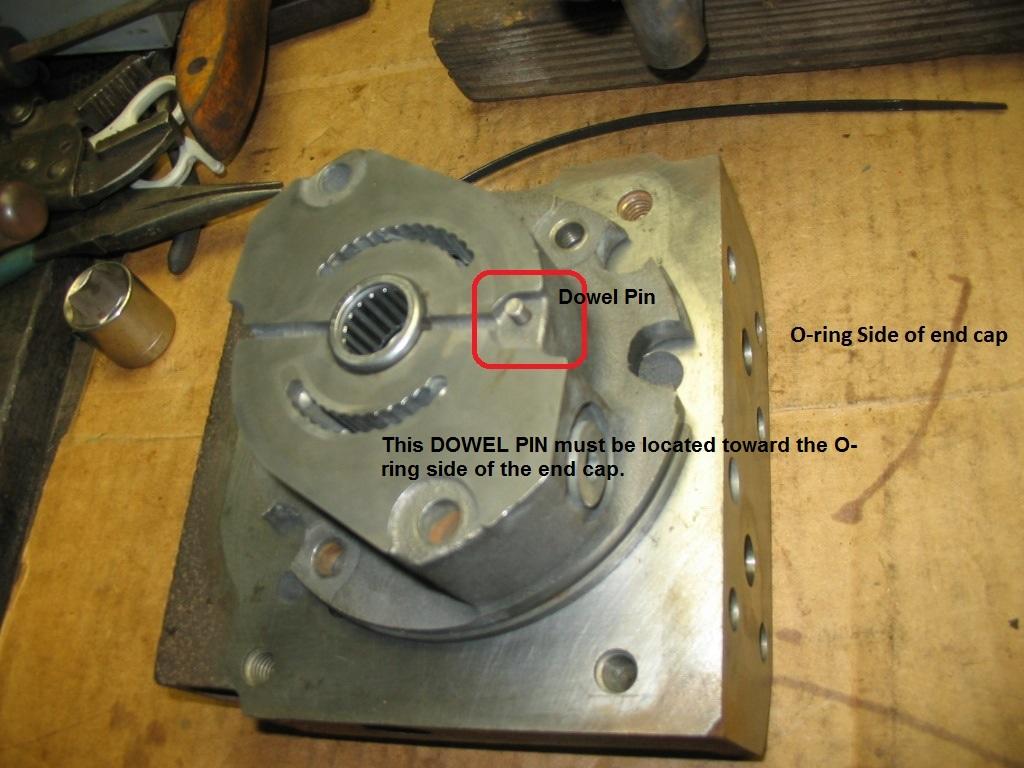

Did you get this CHARGE PUMP HOUSING mounted correctly.  It is possible to mount it 180 degree out of phase....backwards.
If you did not ...or don't remember... open the pump to make sure.

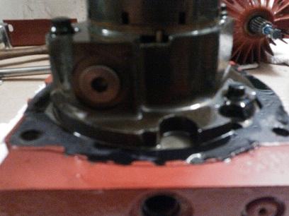

Petes Horse
Not sure. I tried different directions when I reassembled it and thought it only went in in one way. That might explain why the wheels are working and not the lifts.

Petes Horse
You're right that's what I had to do.
Just pulled the plug out above the temperature sender. When I spin it counter clockwise it pulls a vacuum. Clockwise it pumps oil out.
That doesn't look right. Oh well, I do need the practice.

daveoman1966
Is counterclockwise the right direction to spin it? Could the check valves and implement valve stop it at such low rpm?
I will definitely be taking a lot more pictures of what I'm doing that's for sure.
The CHARGE PUMP HOUSING can be mounted backward.  It will bolt down in either ONE of TWO ways.  What I've shown in the pic is the CORRECT way. YUou'll have to remove the hyd pump to know for sure...unless you have taken pics during the reassembly.
Petes Horse
Doh!
Thanks for the help. That was it. That would have taken me forever to figure out.
