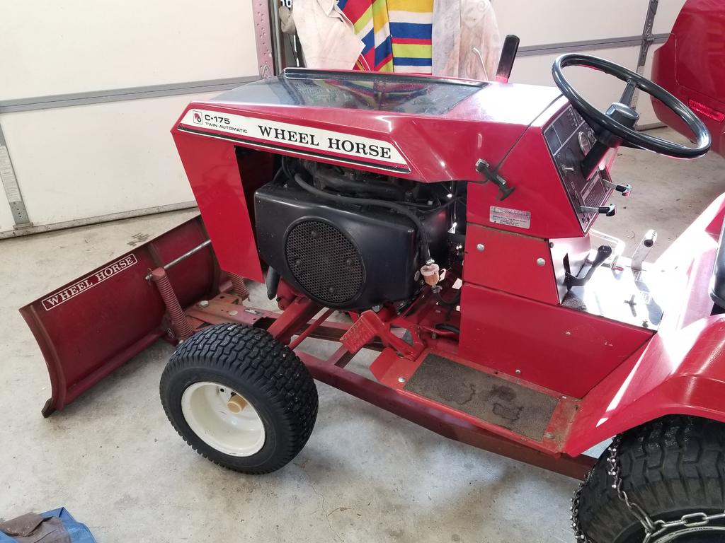

JERSEYHAWG /  Glenn
4 minutes ago, Devin said:
@JERSEYHAWG / Glenn its a C-175 Twin Auto so hydro if I'm not mistaken a while ago one of the first times I actually put gas in the carb and it fired up the whole thing lurched forward about a foot so I'm hoping thats a good sign
Here's mine. A very nice rig you found. Step at a time. We have to look into that lunging forward. Why?
Glenn

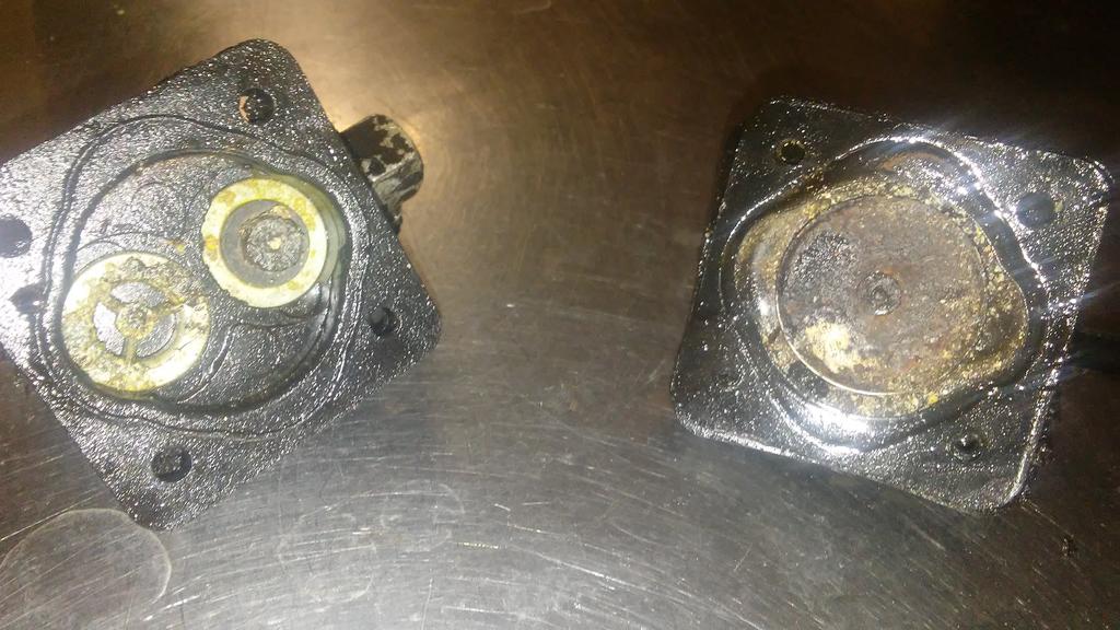

@953 nut yep the line says 1/4 and 6mm on it I for some reason never remember the 1/4 and i just took the fuel pump off and apart and this is the inside of it I cleaned it put it back together and put the inlet part in some water and manually pushed the lever and it works the water came out the outlet
  • Sad 1
The big problem with these pumps is that they are on top of the engine and have to lift the fuel about 12 to 15 inches depending on how full the tank is. The valves may leak a slight bit which makes the pump less effective and it has to pump about 1/2 PSI just to get fuel up to the pump.
