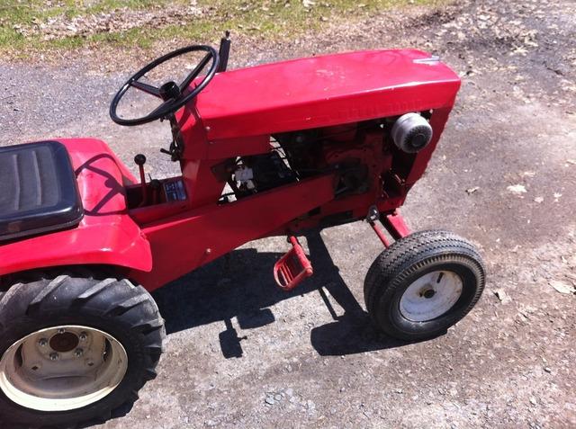

A 1257 is basically the same tractor as a 1267 but with the 4 spd instead of the 8 (6) speed.
sqonk_1_001.thumb.JPG.058d9918de25be3dca593800a3f69245.jpg.53b6ee7658f3b6a3e12962c8b2027b6c.jpg
