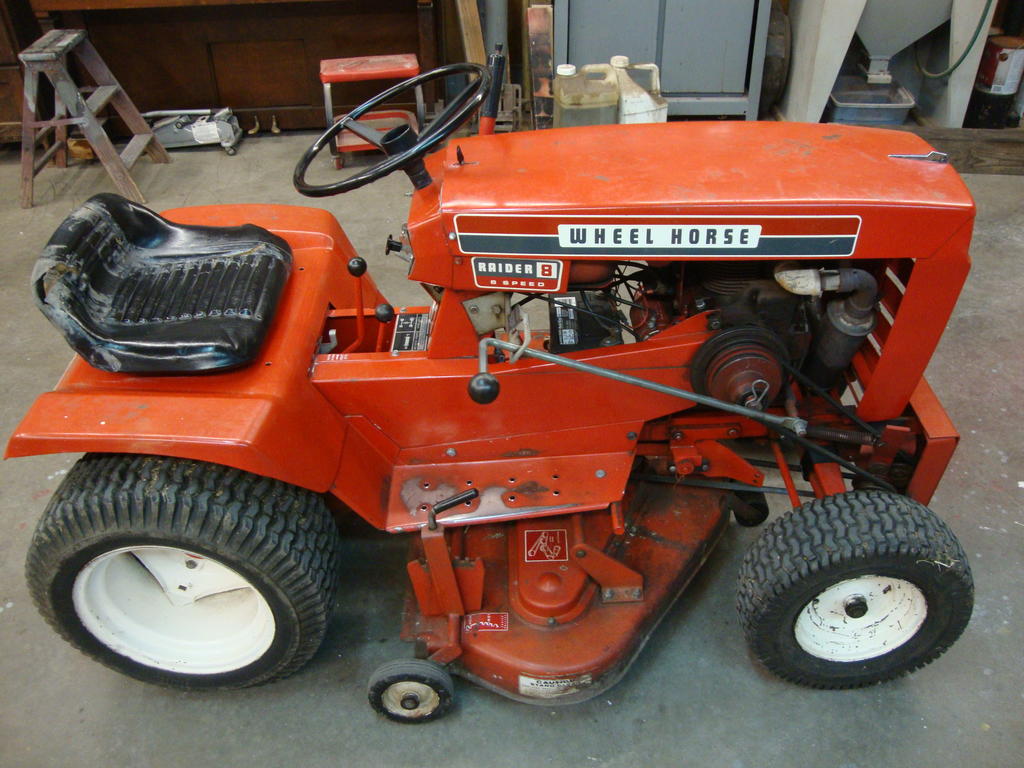

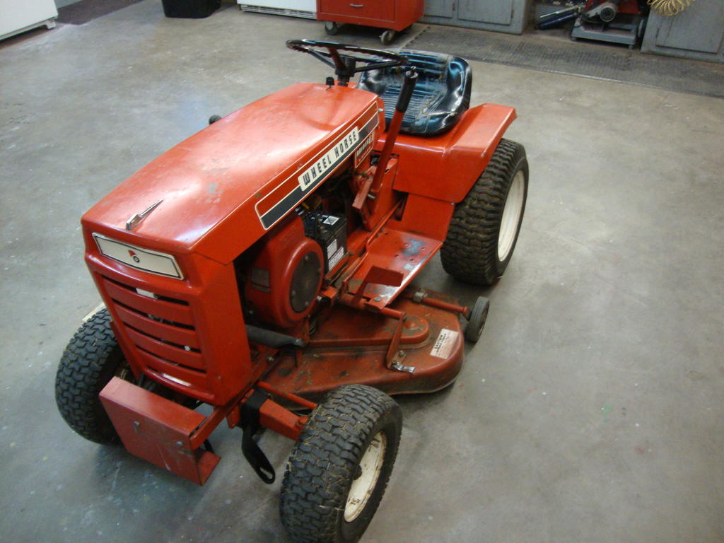

dclarke 4,058 #1 Posted December 3, 2017 At the tractor show in Jacksonville, Illinois this past September I learned of a young lady (Shirley) that was looking for someone to work on her Wheel Horse tractor for her. She lives in a neighboring town not too far from me so I contacted her after the show and went to talk to her to see if I could help her out. She still uses this Raider to mow her yard and it appears to be in very good original condition but being 45 years old it has several things that need attention. She has agreed to let me bring it home and make a winter project out of it so I'm going to give it a good going over and see if I can get this thing fixed up so she can depend on it. She complained of the clutch pedal jerking when she let out on it and I noticed the drive pulley on the tranny input shaft is loose and she said it won't start right now, she thinks it has a wiring problem. I haven't heard it run yet but she told me that it runs fine (she mowed with it 2 weeks ago) and that I shouldn't need to do much engine work, she did say that it doesn't smoke but will use a little oil but she isn't worried about that. I went and picked it up today and plan on getting started on it shortly.. This should be fun! 24 2 Share this post Link to post Share on other sites

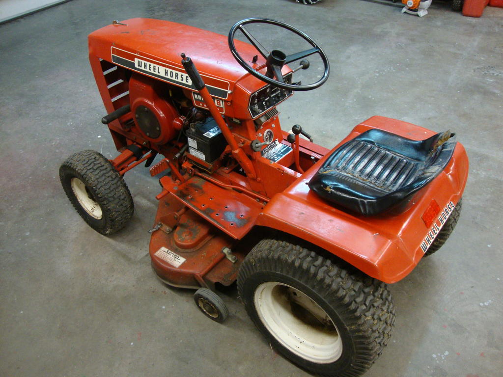

dclarke 4,058 #2 Posted December 3, 2017 This is Shirley on her pride and joy, she told me that her Mom bought this tractor new in '72 and it has been used continuously since then. 17 3 Share this post Link to post Share on other sites

dclarke 4,058 #9 Posted December 4, 2017 Thanks for the comments, guys.... I got started on it this evening, so far I haven't really found a lot that it needs. First thing I did was jump the starter and fired it up so I could listen to it run, it purrs like a kitten and what little I ran it in the shop I didn't see any smoke. I also engaged the mower deck and it sounds pretty good too. Shirley told me that new bearings were installed in the deck a few years ago. I did find the dash stand cracked right where they always do so I'll weld that, the wiring is brittle and the wires to the safety switch on the clutch pedal were unhooked so I'll rewire everything when it goes back together. It's gonna need axle seals so I'll open the tranny and have a look inside when I get to that point.... 6 6 Share this post Link to post Share on other sites

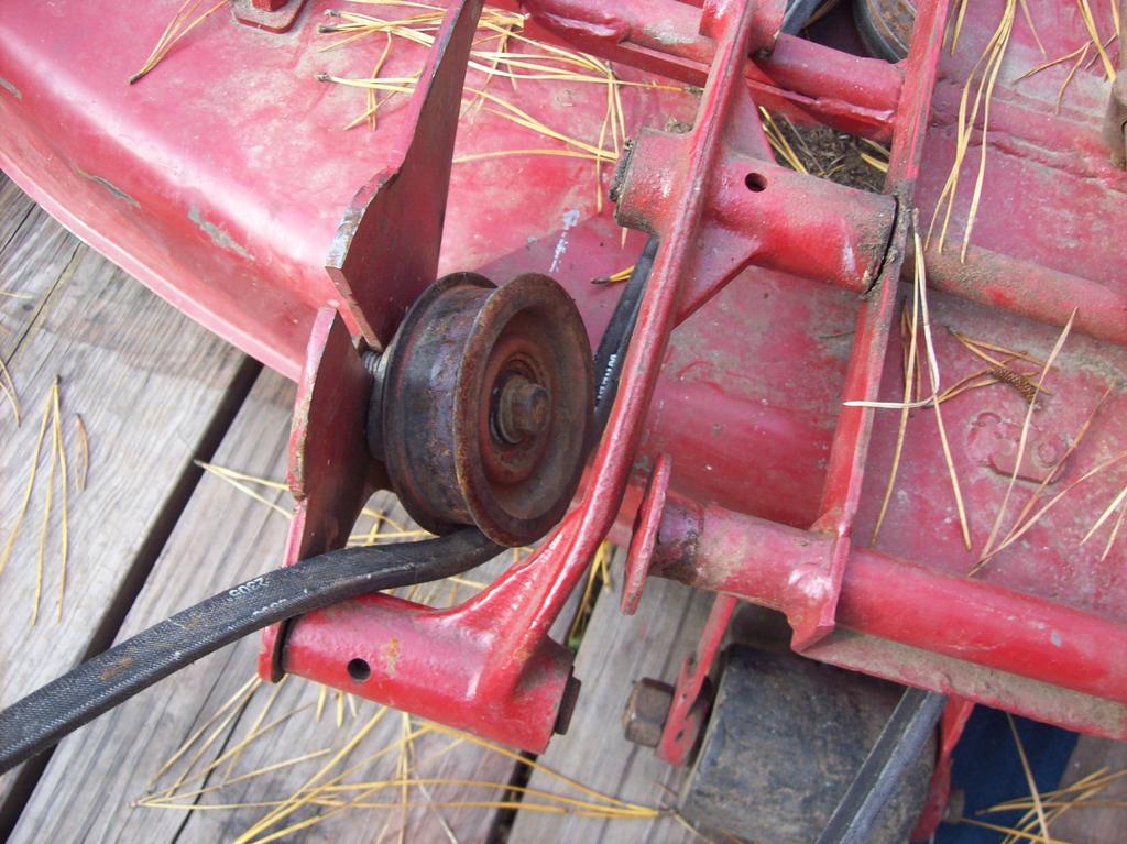

dclarke 4,058 #11 Posted December 4, 2017 (edited) 9 minutes ago, 953 nut said: Looks like it is a well maintained tractor. Will be interesting to follow along. By the way, this is a calendar shot! It has been well maintained, Richard. When I first went to talk to her about this tractor she had it out in the driveway when I got there and the whole time I was looking it over she was wiping it down with a rag that she keeps under the seat. She's really attached to this tractor because it belonged to her Mother. Does anyone know what this little pulley is for? It's located up by the attach a matic. Edited December 4, 2017 by dclarke 4 Share this post Link to post Share on other sites
953 nut 57,925 #12 Posted December 4, 2017 12 minutes ago, dclarke said: anyone know what this little pulley is for? It's located up by the attach a matic. That is for the older decks that didn't use a Mule Drive, the bracket on the mower with a flat pulley would ride on there as the mower was raised and lowered tensoning the belt. 4 Share this post Link to post Share on other sites
dclarke 4,058 #13 Posted December 4, 2017 7 minutes ago, 953 nut said: That is for the older decks that didn't use a Mule Drive, the bracket on the mower with a flat pulley would ride on there as the mower was raised and lowered tensoning the belt. Thanks, Richard. 1 1 Share this post Link to post Share on other sites

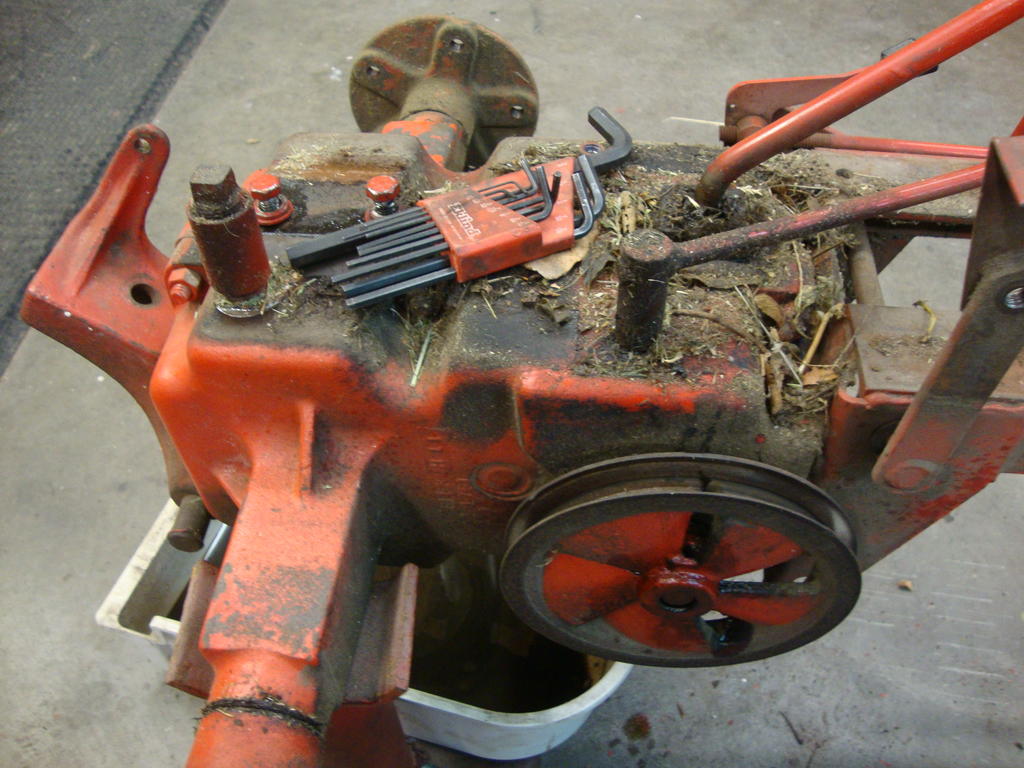

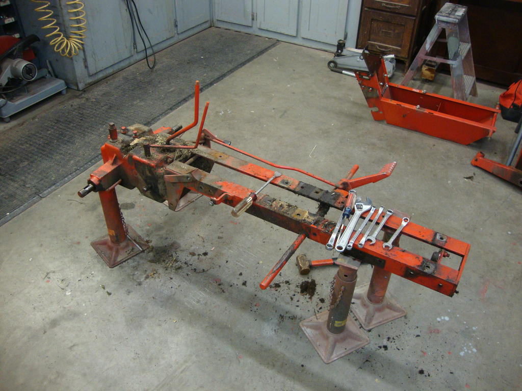

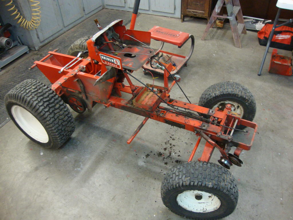

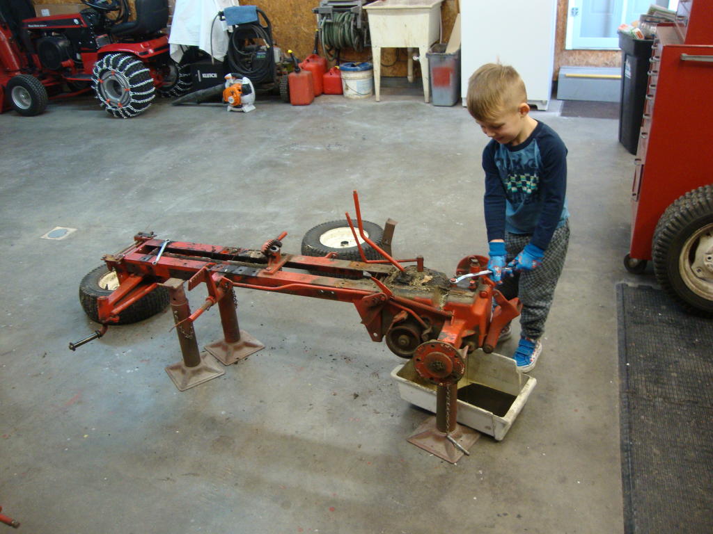

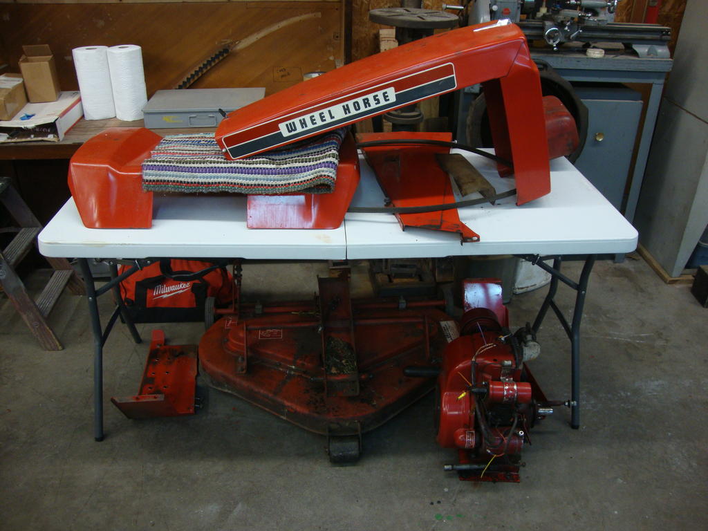

dclarke 4,058 #14 Posted December 4, 2017 I had some help this morning so we got most of the tractor taken apart, I had pretty good luck taking the hubs, hitch and pulley off of the tranny. All of them came off without much trouble at all. The tranny input pulley is bad but the shaft is good and I have another pulley, next I want to open the tranny and check it out then start making a list of parts I'll need and get those ordered. So far I'm surprised at how good of shape this tractor is in. 8 Share this post Link to post Share on other sites
JPWH 6,251 #15 Posted December 4, 2017 Nice job. Tractor will be like new when you finish. 4 1 Share this post Link to post Share on other sites
oldredrider 2,553 #16 Posted December 4, 2017 Denny, I guess I'm gonna have to be specific about "going over" a tractor. It looks like you're idea is more like a frame off resto. 3 1 1 Share this post Link to post Share on other sites
dclarke 4,058 #17 Posted December 4, 2017 14 minutes ago, oldredrider said: Denny, I guess I'm gonna have to be specific about "going over" a tractor. It looks like you're idea is more like a frame off resto. Paul, I wanted to take a look at everything to make sure I don't miss something. I'm really not restoring this one, just fixing what's wrong and replacing what needs replaced and clean it up a little. The lady that owns it wants the wheels painted and I may buff the paint on the tins a little but other than that it gets put back together like it is.... 5 1 Share this post Link to post Share on other sites

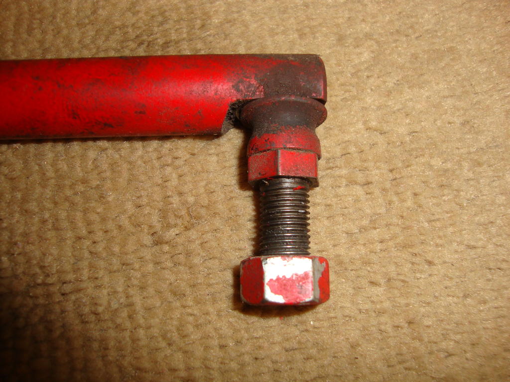

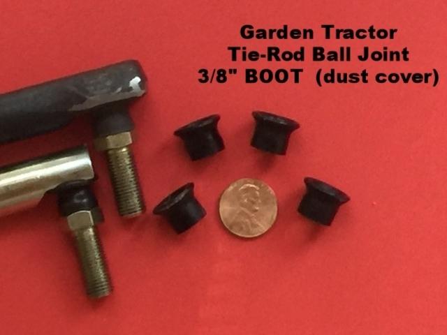

dclarke 4,058 #22 Posted December 5, 2017 Does anyone have a source for these little rubber grommets that go on tie rods? Share this post Link to post Share on other sites
Shynon 7,475 #23 Posted December 5, 2017 Glen in the vendor section has those 3 1 Share this post Link to post Share on other sites
dclarke 4,058 #24 Posted December 5, 2017 40 minutes ago, Shynon said: Glen in the vendor section has those Thanks, Tom.... I should of known that. 1 Share this post Link to post Share on other sites
