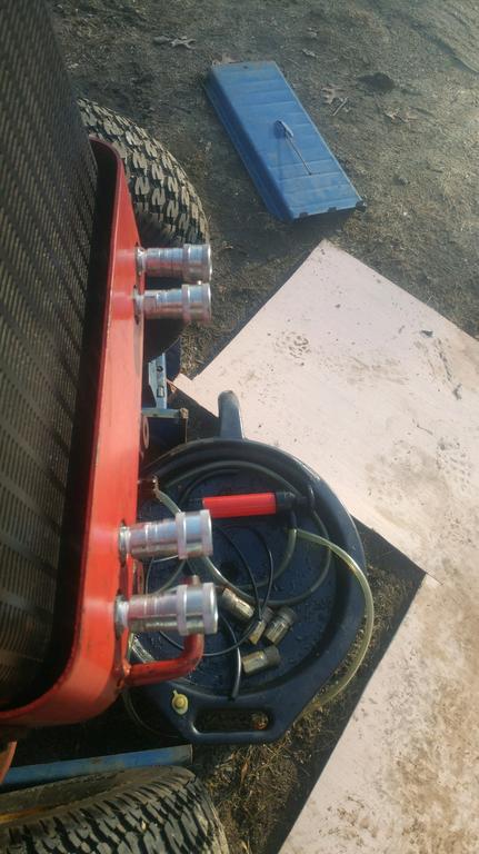

I am trying to find out what the specs are on the D-250 front hydraulic ports but can't find them anywhere. I need to find out what to use for for the Male connector.
The Hydraulic guys in town couldn't match it to anything. They couldn't even match the threads on the female end.
Thanks in advance for any help,
Lance

D-250 tractor is all metric start with that . john deer is us standard. you need to go one way or the other what ever works for you.
C-101plowerpower
guess since its made by gutbrod in germany all the hydraulic fittings are some sort of DIN coupling
lak1965
So after some intense investigating I discovered that the front Hydraulic female connectors are a 18m x 1.5 thread and 18MM connector. I have found a 18M x 1.5 to 3/8 " adapter that I think would better than trying to find a 18M male quick connect. 3/8M18FHG8

Here is the finished product I used 3/8 in couplers for the front of the tractor, Ill send out pictures when I get the plow mounted.

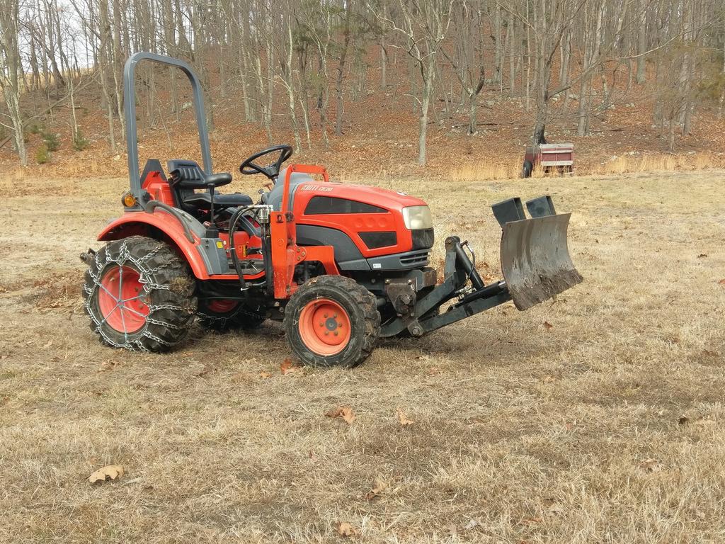

WVHillbilly520H
One has to admit JD did have some good implements...i just finished up a JD blade conversion on my Kioti, Jeff.
