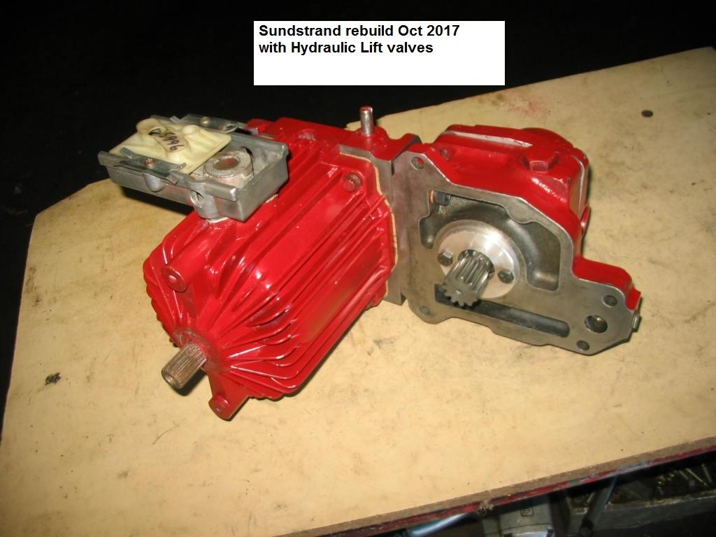

daveoman1966 3,880 #9 Posted November 25, 2017 The charts tell me your Sundstrand power unit is model 90-1140. When you've exhausted all the above suggestions / guidance, it is likely that the Hydro pump and motor have worn out. I have a rebuilt one...PUMP AND MOTOR on the shelf and ready to send. my email is: daveoman@windstream.net 2 Share this post Link to post Share on other sites
