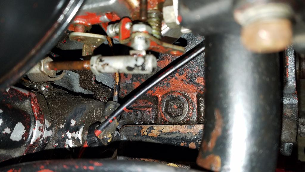

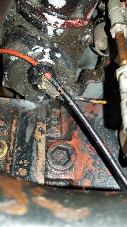

I was cleaning some oil residue from an earlier dumb move - I try to keep things clean so any leaks that spring up show easily . I noticed along the top of the block towards the center from the right cylinder's valve cover a cast marking , cleaned it off and found this -
The casting mark clearly shows K532 .
Now , is this a case like the single cylinder blocks that were stamped "301" but you had to check internally whether it was a 10hp or 12hp engine ? K241 & K301 blocks are stamped the same and that is common knowledge .
But , what about the K482/K532/K662 twin opposed cast iron engines , same deal ?? Any insight on the blocks or anyone know for sure ?
Or - did someone swap out the original K482 from this '74 D180 to a K532 20hp from a donor ?? Some of the tins seem to be completely black to the bare metal , while others are clearly red underneath the black - so some painting has been done and this tractor it has at best a sketchy history . At one time it lived at the welding shop next to me to the West , or at least for a short time . The folks I got it from are about 40 miles away in a rural area and the gal that sold it had told me her father had gotten it from the town where I live - from the local welder . His son that now owns/runs the shop doesn't remember it but it may have belonged to his Dad who started the business - but he does say he knows his Dad never bought a new Wheel Horse , he'd only owned a Cub or two that he remembered . Anyway , hard telling on it's history and a lot of mods/repairs have been done in the machine's lifetime .
I'm just curious if this is the original engine/block - the tins are marked as a K482 / spec 35222b as it should be to match the '74 model year in the published model year reference list . The model tag was long gone off the tractor when I got it , the year came from figuring out the sum of it's parts as to the model and such . Maybe that casting mark explains why this engine feels so strong , there is a noticeable difference between the 482 and 532 engines before from when we used them in other industrial equipment such as Ditch Witch , ect . The 20hp version just had a lot more torque and grunt compared to the 18hp . The K662 is insanely powerful and quite underrated - I ran one of those years ago on a compactor with a gear drive transport feature - that engine is a whole different animal compared to the 18 & 20 versions .

Anyone know anything about these numbers and true engine size ??

If its a D180 they use a 482 bore with a 532 block
