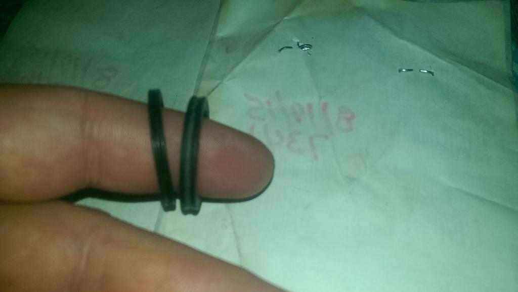

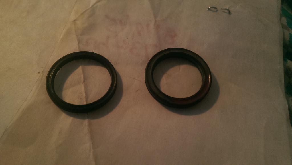

I blew my entire 2stage apart to refurb it, that front gear could be opened up without removing the auger so change the gasket but not the seals, and I work in an industrial facility and happened upon a better set of "quad seals" (flat o-rings) the biggest difference is the factory (left in 1st pic) were I.D. oversize where as the ones I used(right 1st pic) were snug fitting O.D. and I.D., I believe @wallfish used Lubriplate engine assembly grease in the gear box without issue for years, Jeff.

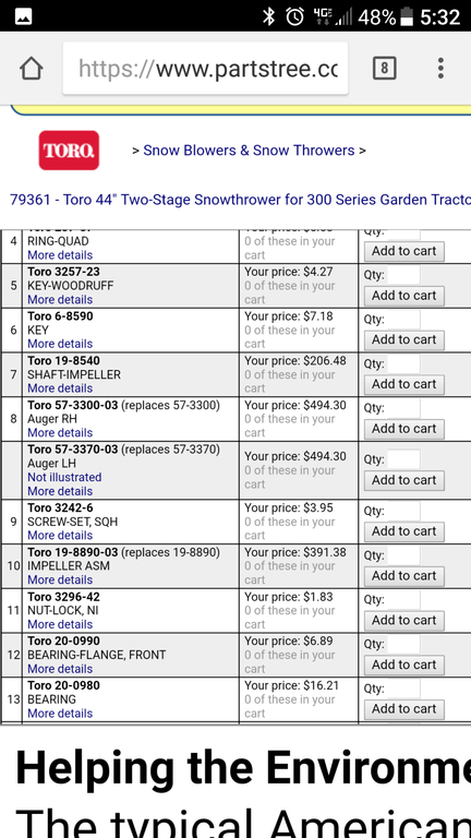

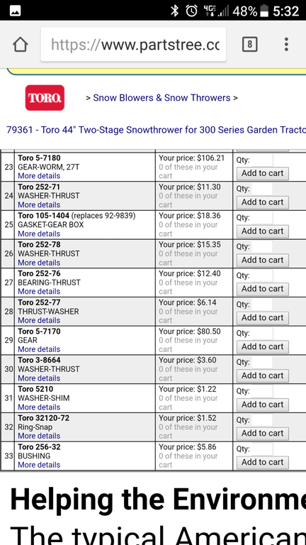

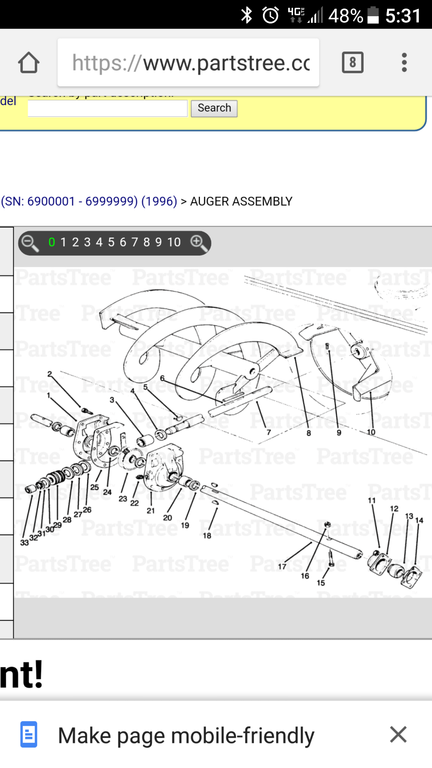

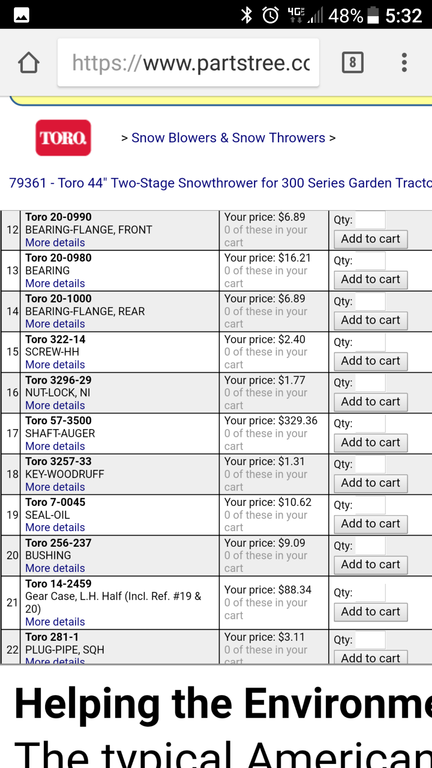

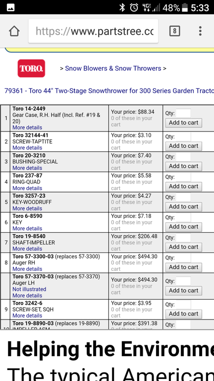

I forgot to answer your other questions, the gasket I got off eBay, buy I'm pretty sure it's the same gearbox used on their walk behinds, as far as the gearbox bushings (there's 3) I made my own at work as well as the thrust washer bearings, the auger bushings should still be available through TORO for now, I went ahead and converted to cam lock regreasable bearings like others here on RS, Jeff.   Partstree.com still shows most parts available...
RJC1965
thank you Jeff I will order the parts through Parts Tree on closer inspection it appears the leak is from the rear rubber seal. I am going to refill and run it one more time before I pull it apart to be sure.
