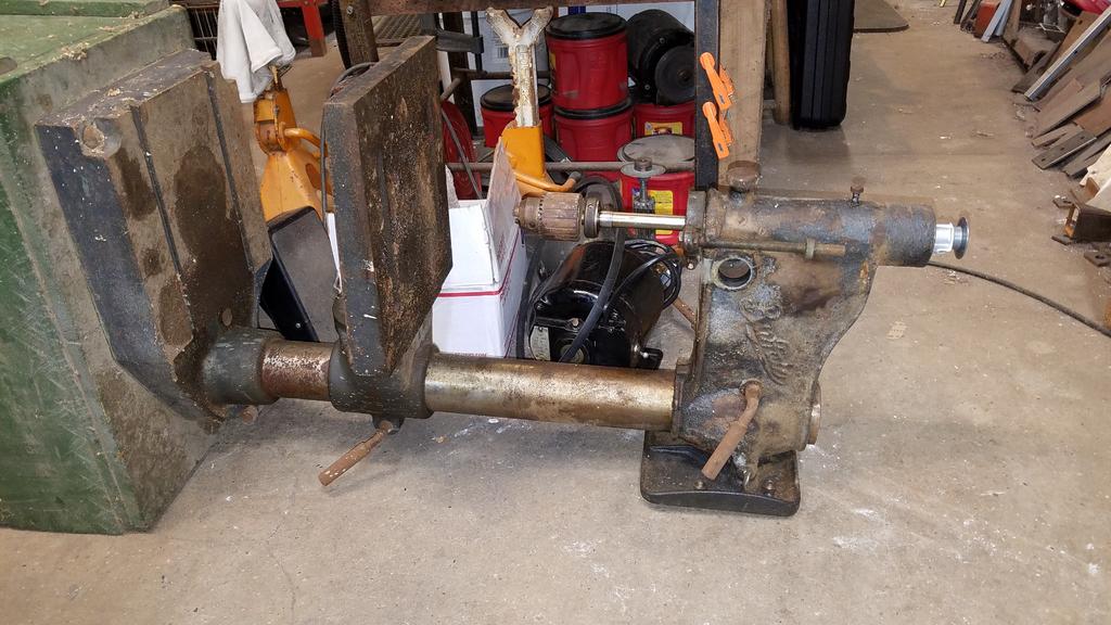

Sarge 3,464 #9 Posted February 19, 2018 I'm always on the hunt for that and other parts - especially the lift mechanism for my '52 Atlas/Clausing model 1810 in pieces all over the shop. Working on the column more tomorrow to finish cleaning it, welding a few more scars and get it hot wax coated, then onto welding other worn/broken parts from kids beating it up. That one is a monster project, parts are expensive and I haven't even touched the original Atlas motor yet. The table/head lift's gears are badly worn, doubt they will work much longer so I'm planning some experiments with special filler rod on the tig - hoping they are cast steel but I doubt it . Almost 800lbs of iron but it is very well built - this one has the extended length spindle on it and some really huge double roller bearings, built like a tank. Very unique table and head lift setup - every drill press should be built like this one. Oh, and got lucky as this model had the larger production table w/slots and oil channels..:) The Buffalo will probably be left in a patina finish and just oil it up good - bolt it to the 1,100lb welding table and leave it there, need a small one like that anyway. Also have a Delta DP220 that's in great shape - got to hunt some reduction pulley stacks for both it and I'd like a stand alone set w/smooth bore for a column-mounted reduction on the Clausing to help protect the original motor from the VFD unit . Too many projects at once, as usual. Sarge 1 Share this post Link to post Share on other sites

oliver2-44 10,367 #15 Posted June 26, 2018 On 2/18/2018 at 8:32 PM, Sarge said: I'm always on the hunt for that and other parts - especially the lift mechanism for my '52 Atlas/Clausing model 1810 in pieces all over the shop. Working on the column more tomorrow to finish cleaning it, welding a few more scars and get it hot wax coated, then onto welding other worn/broken parts from kids beating it up. That one is a monster project, parts are expensive and I haven't even touched the original Atlas motor yet. The table/head lift's gears are badly worn, doubt they will work much longer so I'm planning some experiments with special filler rod on the tig - hoping they are cast steel but I doubt it . Almost 800lbs of iron but it is very well built - this one has the extended length spindle on it and some really huge double roller bearings, built like a tank. Very unique table and head lift setup - every drill press should be built like this one. Oh, and got lucky as this model had the larger production table w/slots and oil channels..:) The Buffalo will probably be left in a patina finish and just oil it up good - bolt it to the 1,100lb welding table and leave it there, need a small one like that anyway. Also have a Delta DP220 that's in great shape - got to hunt some reduction pulley stacks for both it and I'd like a stand alone set w/smooth bore for a column-mounted reduction on the Clausing to help protect the original motor from the VFD unit . Too many projects at once, as usual. Sarge @Sarge Can you educate me on the "hot wax coating" I restored my dads old Craftsman drill press for my son, and want to find more of these heavy old tools for my shop! Share this post Link to post Share on other sites
Sarge 3,464 #16 Posted June 26, 2018 It's a bit tricky as you really need a good quality heat gun - some temperature sticks isn't a bad idea either to avoid heating the tube too much. I try to heat the tube to around 125*F, not far below the burn off point of paraffin. I used a temperature gun to monitor the metal - getting around 24" of the post hot, then applying the wax. Most drill machinery uses cast spun steel for their posts, some are cast iron but those are rare. Hot waxing forces the wax deep enough into the pores to easily prevent rust and provide some lubrication of the table, ect. You really can't use a propane torch or a flame, paraffin wax will burn easily and not penetrate the iron. I had to heat an area, apply the wax stick heavily and used a mild buffing belt on the belt grinding machine to further heat work it into the metal. Repeating this several times ensures a good, solid and deep coating in the metal, after that it gets a really good coat of Johnson's paste wax, again - buffed out with the belt grinder. So far, after 4-5 months of sitting against the wall in the basement, there are no signs of rust yet and it's held the shine left from the waxing process. I much prefer a hot wax on those posts over traditional oil coatings - it's hard to get any oil coating that won't eventually become sticky over time. This leaves the post dry feeling to the touch, but protected. Sarge Share this post Link to post Share on other sites
oliver2-44 10,367 #17 Posted June 27, 2018 Thanks @Sarge I'm going to try that ! Share this post Link to post Share on other sites
