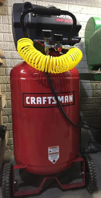

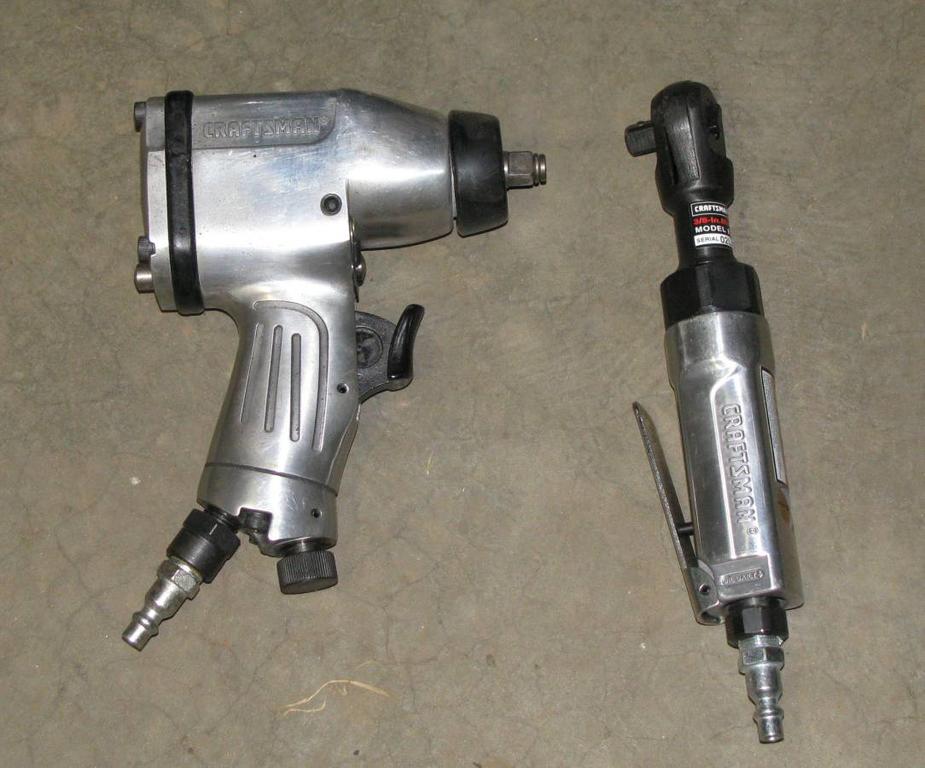

ACman 7,630 #30 Posted November 24, 2017 (edited) I still have to checkout our farm and our old AC dealership as we sold/stocked motors for farmers. Then the electric company brought 3ph power down past my cousins farm some years back but don’t know if they made the switch. They did but the newer bins near the road for a reason. This wheelchair really slows me down . So moving on back to the trade deal . I’m waiting to here back from this guy hopefully soon. If I pick this one up for $150 with tools I’ll trade it towards the big compressor and keep mine . I’ll keep the impact and ratchet for myself as they hardly look used . In my head that makes the compressor around $75-100 . It’s a 2003 model oil less 30gal. Thanks for all the help guys with your help I’ll get this figured out . Edited November 24, 2017 by ACman 1 Share this post Link to post Share on other sites
Racinbob 11,648 #31 Posted November 24, 2017 That sounds like a plan Jeff. Definitely keeping the Kobalt over that Craftsman. Apparently in 2003 Sears was still playing games with the horsepower ratings. Let's see.....6hp.........120 volts........15 amps............... They used to do that with their vacuum cleaners too. 2 Share this post Link to post Share on other sites
ACman 7,630 #32 Posted November 24, 2017 (edited) ... The guy even described how they rated things back then in his ad so I believe he a straight up guy and my son is on his way to go pick it up . Here’s his description... Single cylinder, oil free. 6 HP is peak power, but air compressors aren't rated that way anymore. In today's ratings this would fall around 1.5 - 2hp. (Nothing you plug in to a household 110 volt outlet is going to be much over 2hp, the math just doesn't work). With that out of the way, according to the markings on the tank this was made in 2003 and it has spent it's time in my basement so it's still in great shape. I used it to paint a couple motorycles and run some smaller air tools but recently replaced it with a 220 volt compressor to have more capacity. Even though my Kolbalt has a issue it does have that big cast iron lump on top which I believe is a better unit than the oil free on the Craftsman. Edited November 24, 2017 by ACman 3 Share this post Link to post Share on other sites
ACman 7,630 #33 Posted November 25, 2017 (edited) I got to say this Craftsman looks brand new ... It feels like I stole this compressor . I could flip it easy make some $ and keep the air tools . This one do doesn’t trip the breaker but it’s much louder. I may just swip swap the the pressure switch as the Craftsman has a heavier cord , nicer gauges and regulator over to the kolbalt. The guy will never know ! I talked to used industrial supplier and he said the single phase motors leave as soon as he gets one but he may be interested in the compressor . If the price or trade (this place is packed full of goodies) is right for the big one , it may just disappear. Edited November 25, 2017 by ACman Share this post Link to post Share on other sites
