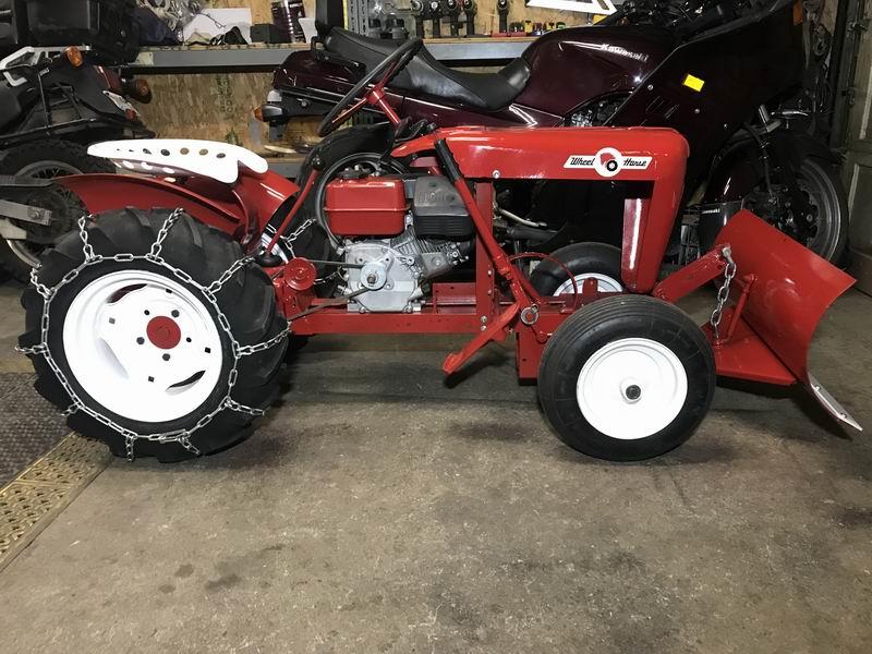

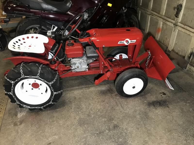

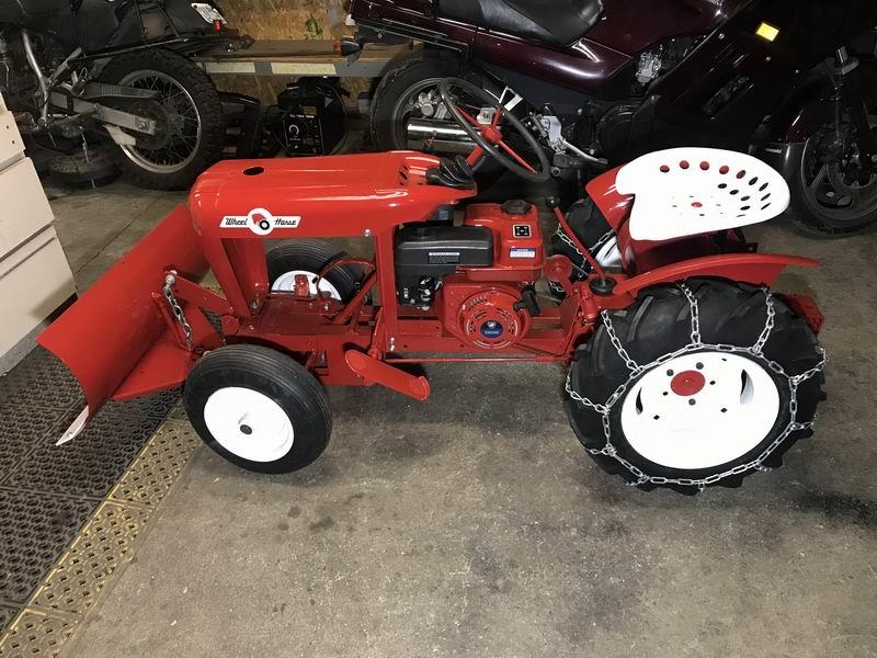

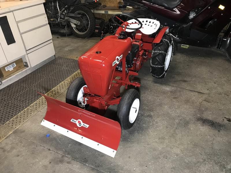

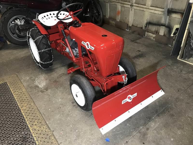

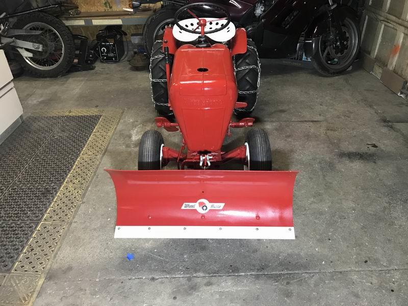

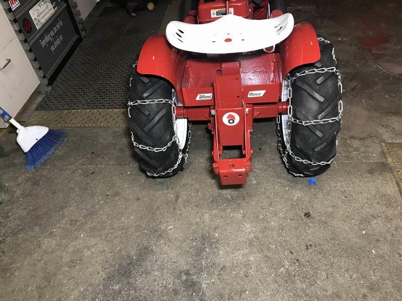

I found some midnight oil time so I stoked up the fire in the garage the other night, and the old girl is purt-neer completed - :think: Still need a couple hole plugs for the dash, and still need to get a safer pulley for the motor output.
:bow-blue: Proudly displayed the high quality decals from Vinylguy (Thanks Terry) where they belonged, and I decided to Use the cheap :roll: Fleabay decals for the plow face and cut the other up for the back.

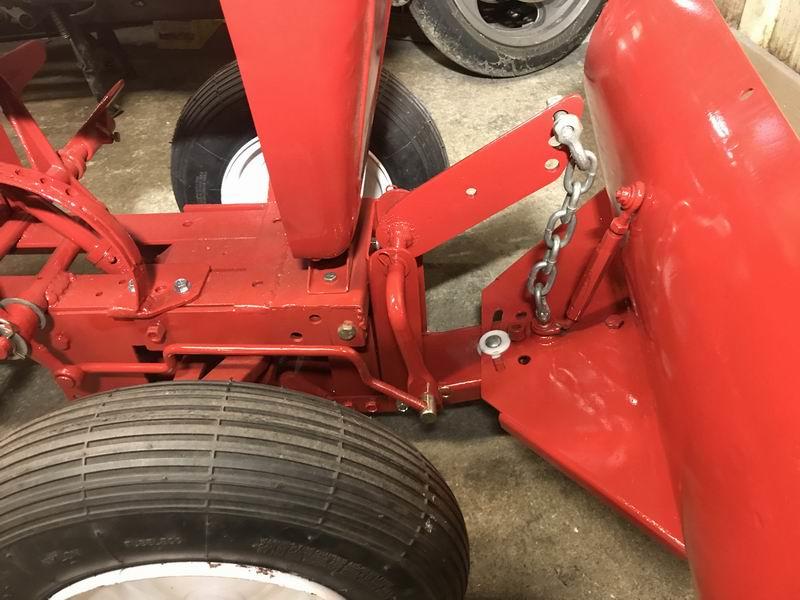

:think: The crappy old little plow came out better then I expected after :tools-hammerdrill: putting a wear bar on it (never had one before) - :text-bump: I threw in a pic of the lift linkage/ mechanism I made and forgot before.
:scratchead:I decided to paint the wear bar on the plow white to accent the wheels - Waddayathink ? :twocents-mytwocents:
:confusion-confused:  So I have a question for all of you . . . . . . . I know people name there horse's - Do you guy's name your wheel horse's? :confusion-shrug::confusion-shrug::confusion-shrug:
While admiring / marveling in my restoration results this evening. . . . . . :techie-eureka: I was thinking this old Girls name should be "PURDY" The Wheel Horse :dance:
Well enough yammering :hilarious: . . . . Here are some more pic's for your viewing enjoyment  :hilarious:
Edited by Spokane Dave
  • Like 8
SylvanLakeWH
:bow-blue:
WHX??
Didn't know if I was gonna like the frame stretch but looks good now. :handgestures-thumbupright:  Not a big fan of the wheelbarrow fronts tho they might skid too much?? What's your thoughts on the rears being backwards? Better in snow?
Spokane Dave
Thanks . . . . .There was a bit of a snaffu in supply when I went to get the front tires, so I settled with the WB fronts - I to was thinking they may slide steer, so was thinking of whipping out some mini chains for the front.
As for the rears . . . just a 50% chance of mistake (it was Eye crossing late when they installed) and had not noticed  . . . is there really any difference / benefit to turning them backwards ??
