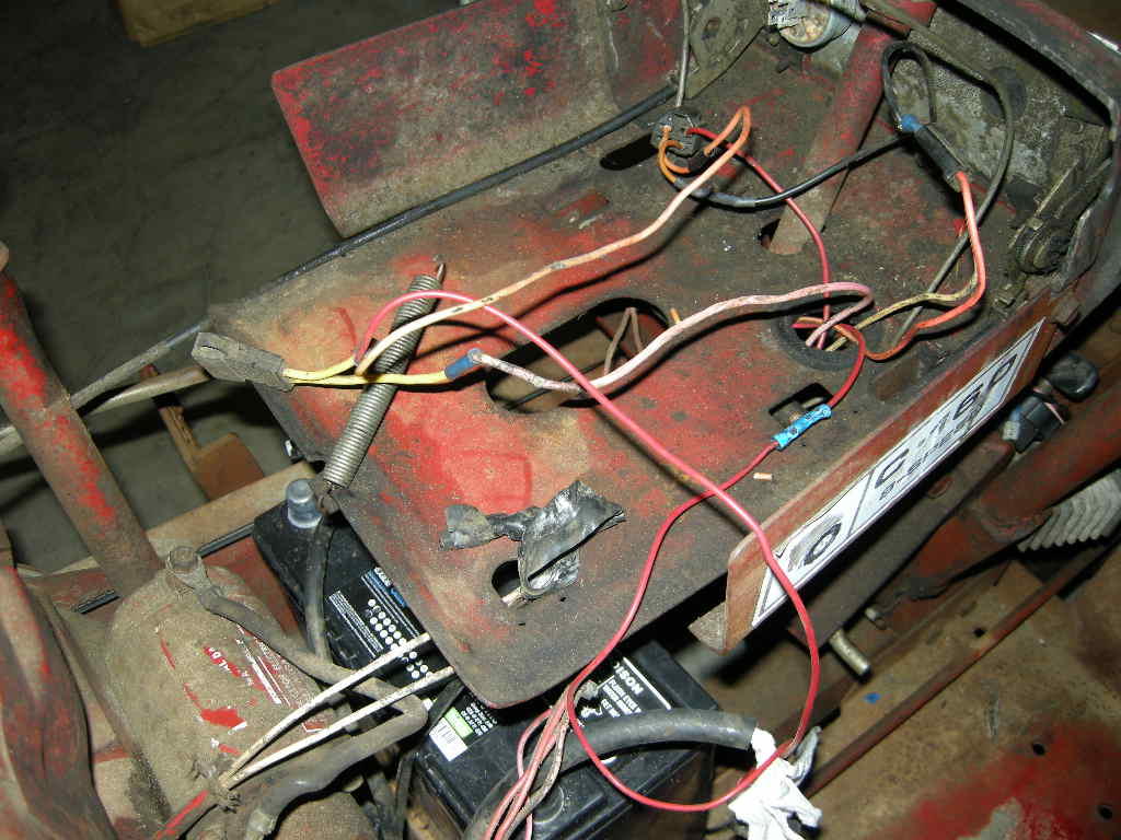

So I started digging into a C-100 I acquired over the weekend and I have found two issues. One of which I am curious if anyone else has seen and the other I suspect the solenoid is toast.

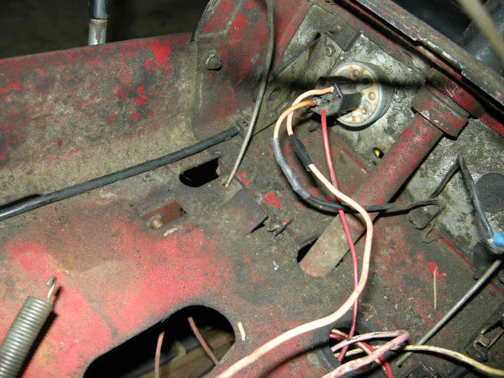

I was not getting any power to the solenoid when turning over the key. Surprising enough both the clutch and PTO safety switches work (I wonder for how long), yet I was still not getting power at the solenoid. After working from the live hot wire on the solenoid I discovered the voltage was dropping from 12.5V to 3.4V across the Ammeter. After bypassing the Ammeter I got power to the ignition switch then to the solenoid when cranking. Just curious if anyone had seen something like this and where could I find a decent quality replacement, any suggestions?

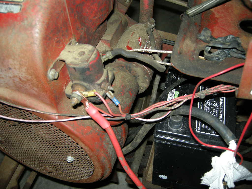

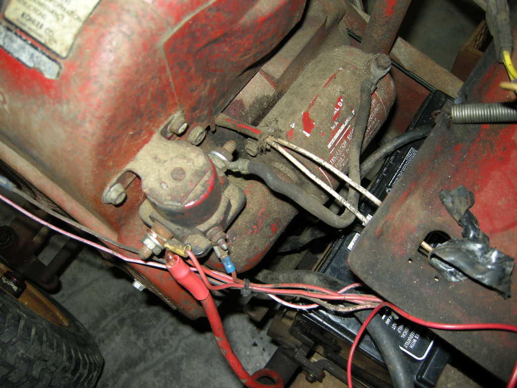

Now that I got power to the solenoid, there was a loud click but the starter did not budge (I have not confirmed the starter is free not did I confirm power was passing through to the starter). However I observed that the power was continuing as if I was holding the key to the crank position. I am just curious if the solenoid is fried such that it is somehow sticking and jumping power? I checked the ignition switch and it is checking out fine as I would expect.
