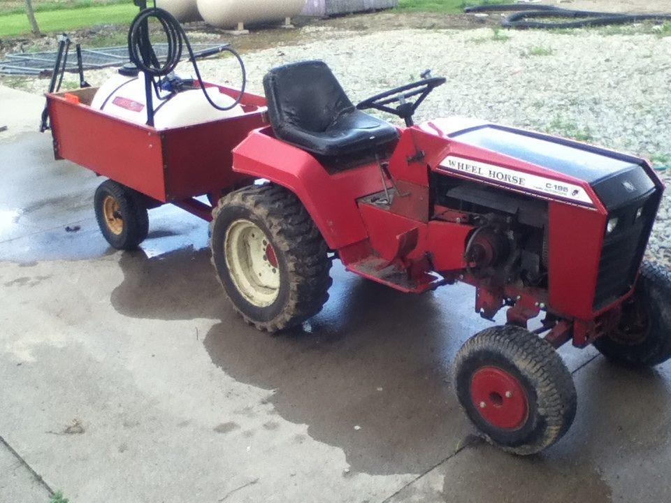

I love my foot pedal on my c195!

Agreed Mastiff, I have got one on both my 520 and 416 and nothing like it. I wanted a buddy @Achto to put one on his 520 but I understand  he had  a bad experience once with a foot control!  :lol:

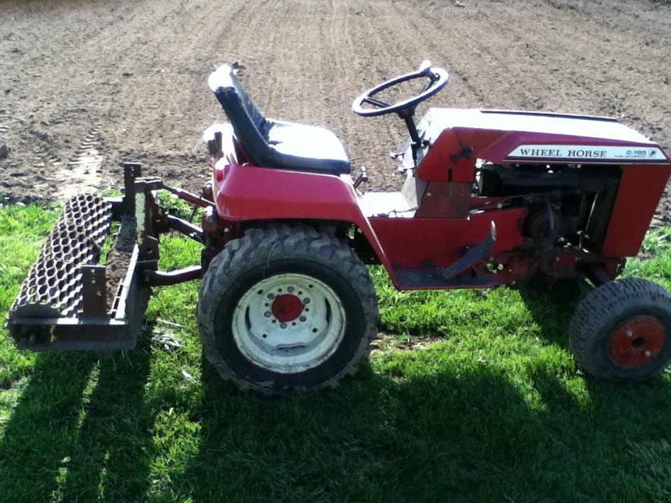

Nice tractor Adams! Make that one yourself? Or is that the wheel horse kit I've heard about?
Jerry, it a nice modification for sure. Go for it when you can.
WHX12, yeah I couldn't get the steering wheel off so I pulled it up as high as I could and wiggled the motion control lever out by twisting it forward and across the front of the steering wheel shaft and pulled it through the top half of the steering wheel. It slipped right out.
Thanks. Carlisle Tru power on the back and another brand on the front. It would badder if it was 4x4. ;) ;)...

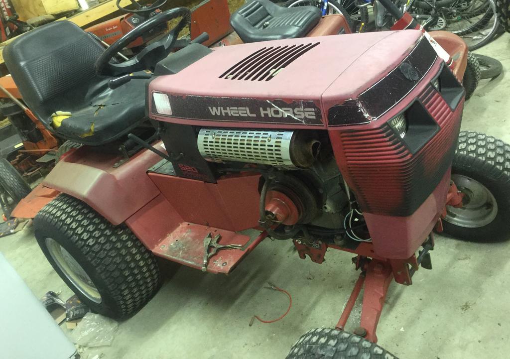

 Doc, my 520h is 1990 and it was left outside for a while before I saved it.
 She was a liiiiitle rough. lol- It's not surprising that I couldn't get it off. Plus I didn't want to make any more of a day of it than I already did. I dn't know how I could have gotten a seized steering wheel off the shaft while it's still on the tractor anyhow. smh.
This was at the PO's yard...
WHX??
Wow if the PO had a deck for it he sure didn't use it. You did a bangup job on cleaning it up tho. :handgestures-thumbupright:

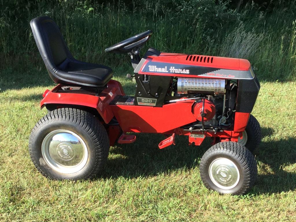

@Mastiffman I’ve been wanting to do a pedal kit on my 95 520Wheel-a-matic but I’m going to have to add a 3/4” bar to relocate my front foot pads. She sat out in the open for years too but it cleaned up well and thanks to Terry it’s a one of a kind. If I can come up with some wheel spacers I’ll run my 26-12x12 ags off my Kabota and put trailer hubs on the front to run some skinny tri-ribs . I really like the ags on yours. Hope we can meet up sometime. Here’s my before and after pics.
Duramax7man7
Yeah that looks real nice! I didn't do a restore on this one yet. I just threw some new sheet metal on it and made it functional again. Hope to do that one day.
 Yes that would be pretty sweet with the Kubota rears and trailer hubs. I'm in the process of collecting materials and parts to build a custom tractor with a beefed up, stretched frame, 4x4 and a 3 cylinder diesel based off of a wheel horse 520 setup.
 I want to make it full loader ready as well. I'm aiming for a BX - B series Kubota without all of the extra overhead costs while having fun and learning along the way and maybe opening up some cheaper ideas for others wanting to make their wheel horse full blown 4x4.
It will take some time finding parts but I picked up a 93 Toro Groundsmaster that will provide much of them. if I could have found Groundsmaster 4x4, that would have been ideal.
