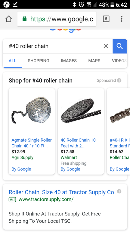

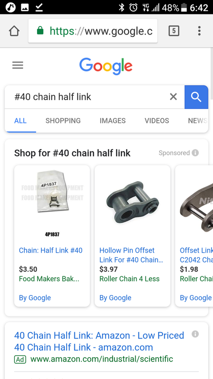

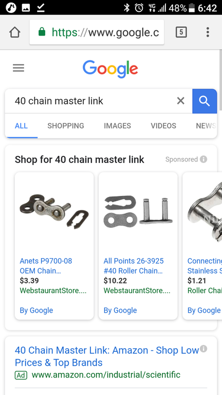

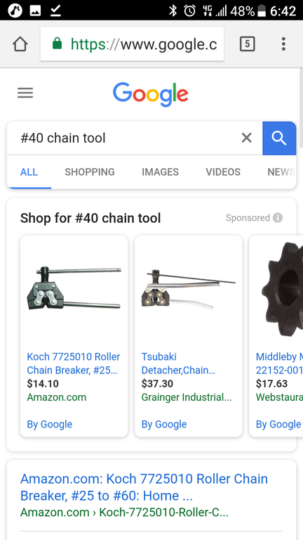

#40 roller,  buy bulk 10'+ makes about 3, then you'll have spares for later, but you will also need some master and half links to attach the ends together and a chain breaking tool, Jeff.  Then use the old one for front tire chains.
