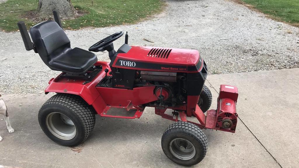

Al C.
This is the solution I used.  Cost nothing and it is very effective.

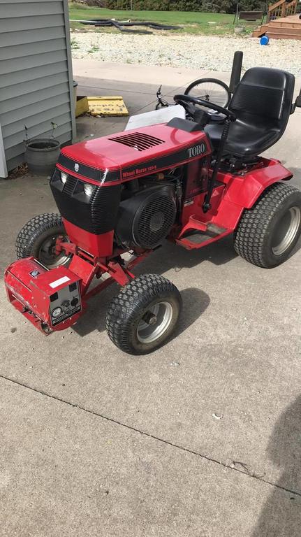

c-series don
Looks like you already have the solution, put a 5000W generator on the front!!!
Adams94
That does work! but the hood hits the generator haha and when it goes back to mowing duty the hood stops on the mule drive and wth nothing on the front it will almost touch the ground

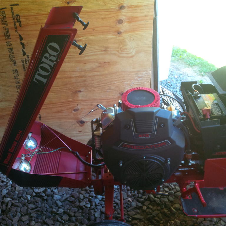

fast88pu
I did this. With a piece of cable.
Adams94
Looks like that works good!
