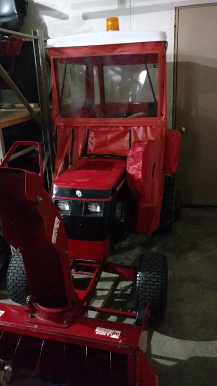

Wheelie horse 90 #1 Posted October 30, 2017 (edited) After an hour of figuring the cab out in the garage I got it all put together and on the 416 and it's very nice, seems to get pretty warm inside as well. Winter will be the true test of that though Edited October 30, 2017 by Wheelie horse 9 1 Share this post Link to post Share on other sites
Ed Kennell 39,593 #2 Posted October 30, 2017 Looks great, you will enjoy blowing snow in a nice warm cab. Looks like that rear cylinder will pump some heat into the cab. Share this post Link to post Share on other sites
Wishin4a416 2,191 #3 Posted October 30, 2017 (edited) Looks good . Definitely a plus in wet windy weather. I actually have to open the door once in awhile to cool it off. I have a flexible dryer pipe coming off of the cylinder block fins near the exhaust valve area for heat. Kohler 16 model. Nice and toasty. You will like it. Edited October 30, 2017 by Wishin4a416 3 Share this post Link to post Share on other sites

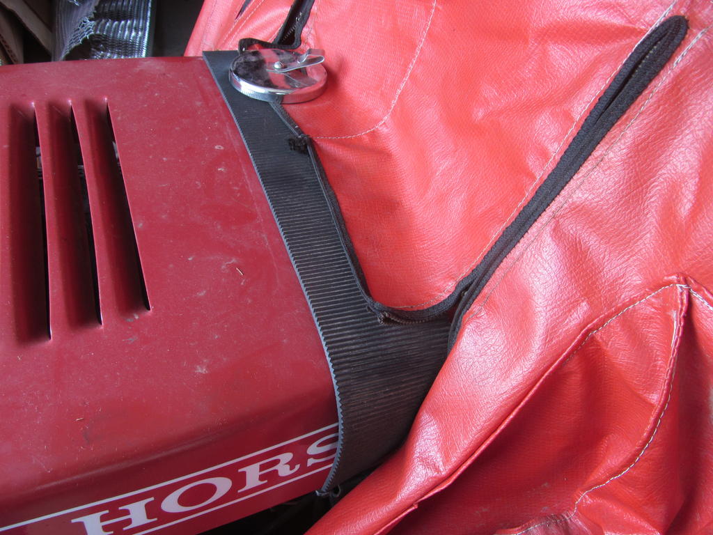

MalMac 1,332 #7 Posted November 5, 2017 Word of warning, the flap over the hood will actually wear and scuff the paint. Especially when it gets cold. The vinyl will become real abrasive. Also the zippers on the flap will scratch up the hood decals. Using “Mothers Back to Black” helps keep the vinyl soft and ply able when it gets cold and does not attract dust. 1 Share this post Link to post Share on other sites
Ed Kennell 39,593 #8 Posted November 5, 2017 4 hours ago, MalMac said: Word of warning, the flap over the hood will actually wear and scuff the paint. Especially when it gets cold. The vinyl will become real abrasive. Also the zippers on the flap will scratch up the hood decals. Using “Mothers Back to Black” helps keep the vinyl soft and ply able when it gets cold and does not attract dust. I attach a strip of rubber with magnets to protect this area where the cab rubs the hood. 5 Share this post Link to post Share on other sites

Ed Kennell 39,593 #12 Posted November 21, 2017 Here is a pic of the rubber strip I use to keep the cab from rubbing the hood paint. The round thingy is the magnet that holds it in place. 1 Share this post Link to post Share on other sites
