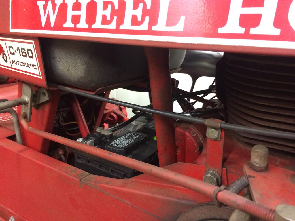

Can anyone please help with the following questions:-
1) Should the clip on the throttle cable bolt to the nut and bolt on the left of photo 1?
2) The spring in photo 1 doesn't appear to do anything - is it correctly located?
3) Where in photo 2 should the spring on the motion control lever be fitted?P1010268.JPG.1259b65ada32e82f9482c082629be46a.JPGP1010267.JPG.1f212c6ea33ab78a59232b6ffc9049bf.JPG
rmaynard
1. Yes, the clip is attached to that bolt and nut.
2. The spring (as far as I know) is to keep the arm from rattling.
3. Someone else will have to answer that one as I don't have that model tractor.

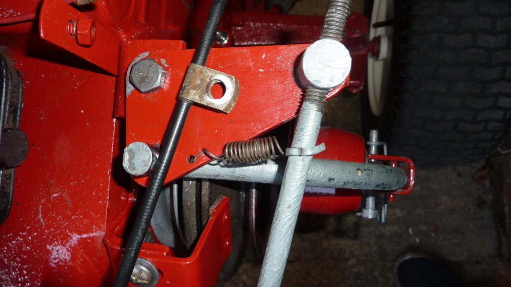

rj35hunter
The spring in the first photo is for the PTO arm and lever just like mine in the photo

Thank you Hunter for the very clear photos - I can now make a little more progress with my rebuild Can I ask you another 'obvious' question namely is it possible to fit the belt guard without removing the fender.
