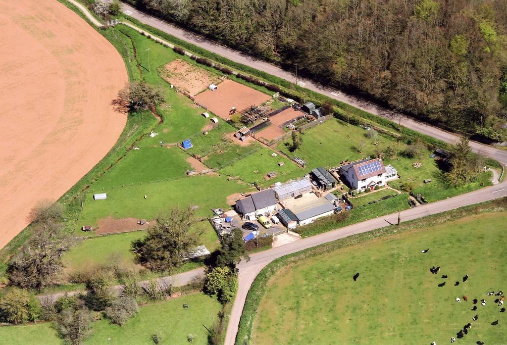

Poppa T 8 #19 Posted November 1, 2017 Ok so this is our place - half way between Crediton and Sandford. It's the whole triangle - about 2.5 acres. sorting and dragging the lambs and doing what small boys do best....riding on uncle rob's Kubota. 3 Share this post Link to post Share on other sites

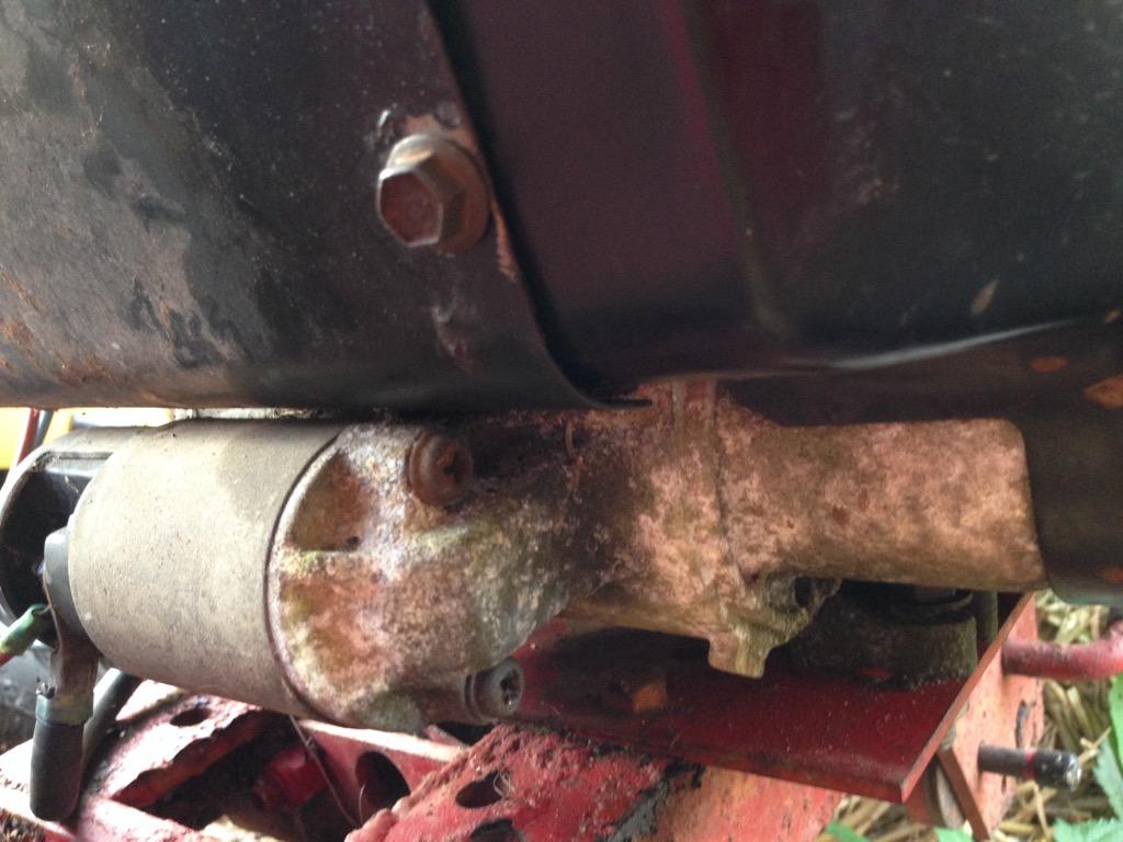

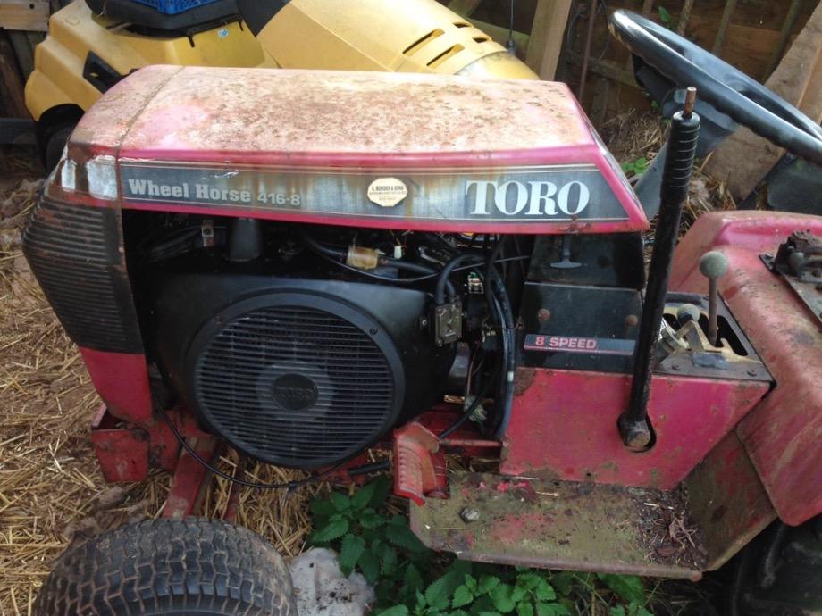

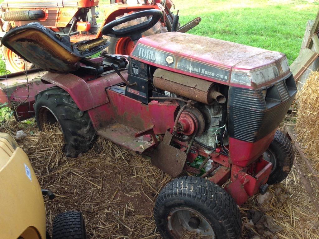

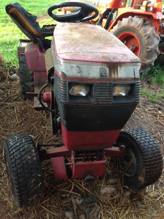

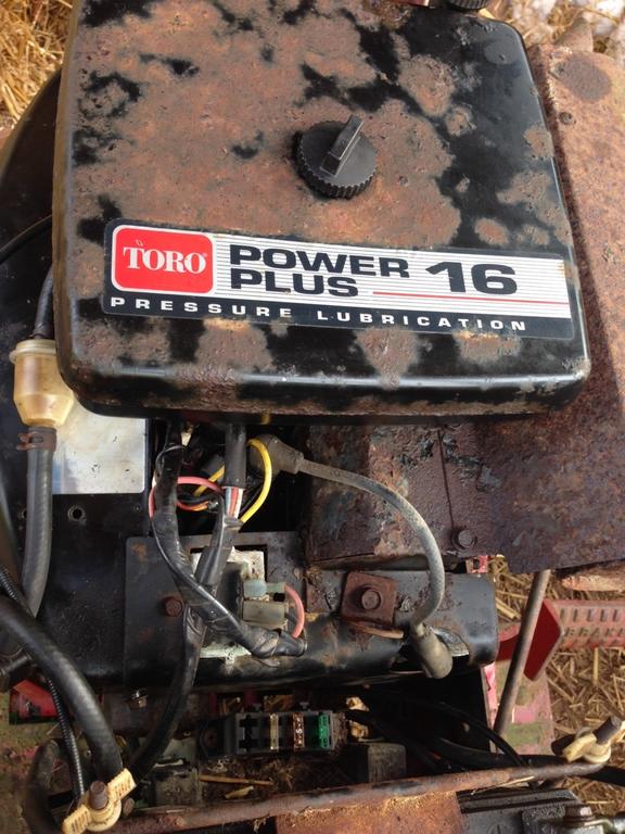

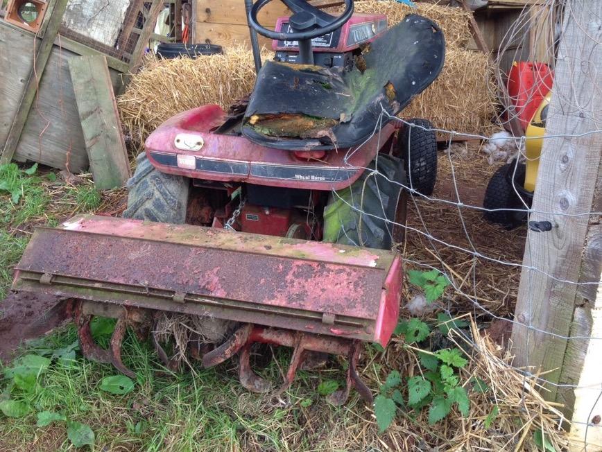

Poppa T 8 #22 Posted November 2, 2017 Ok here are a couple or so pics of the 'find'. In the side view showing the range lever can you tell me if the button on top should press down because mine doesn't. I haven't really started stripping it down yet. Also the starter motor looks fairly corroded. Share this post Link to post Share on other sites
Stormin 9,983 #23 Posted November 6, 2017 (edited) Poor old thing looks in a sorry state. But I've seen worse. Being all there is a good thing. In the side view photo 3 that is the lift lever for raising/lowering attachments. The button should press down to enable the lever to be moved. Take the rotovator off to take the weight off the lever. Pull the lever back if you can, then press the button. If the button will not go down, give it a good soak with penetrate fluid. The black hand wheel next to it, is for adjusting the movement of the lever. I hope my rather poor description helps. Norm. Edited November 6, 2017 by Stormin 1 Share this post Link to post Share on other sites

ohiofarmer 3,323 #25 Posted November 7, 2017 there are some ATC fuses in the vicinity of the battery and also a safety switch in the linkage of the PTO engage lever. They will need penetrating oil by the looks of things.Under the seat deck where the frame tunnel ends, the metal is often cracked. That can be a big deal if it makes the seat fall off when you are on an embankment. Not so much if all your land is flat. Pay attention to the idler pulley on the transmission. The swing arm of the idler is supposed to be surrounded with a [plastic I think] bushing. The swing arm can cut an egg shaped hole in the frame if that bushing fails The way the tractor looks, i would say all these things deserve your attention. Now go forth and restore that beast.... Share this post Link to post Share on other sites
