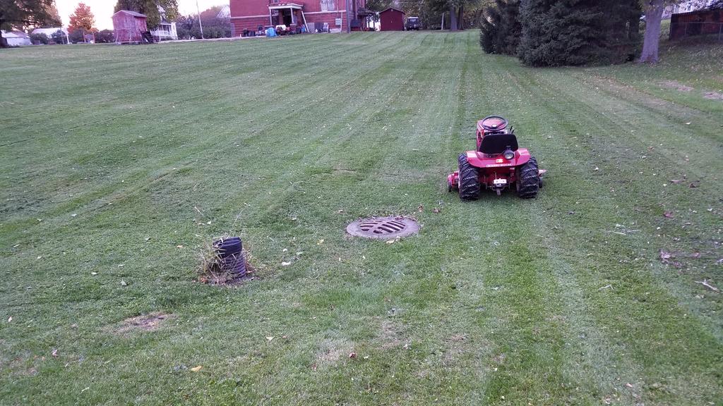

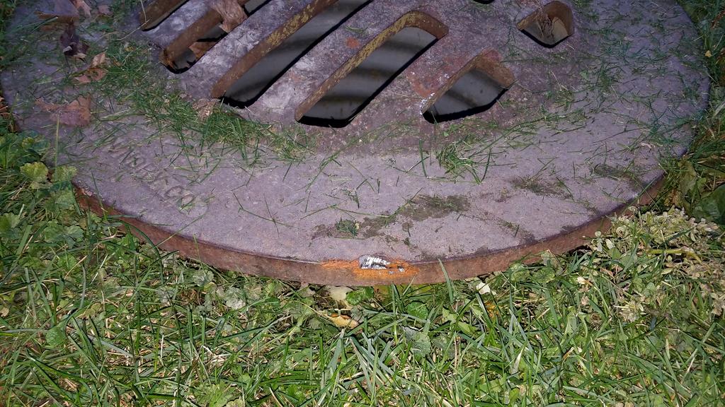

Went pretty well , the old Kohler rattling along and barely ever touched the governor - until I just barely caught the drainage inlet in the lower back yard - the ground has sunk this summer from some really heavy rains/flooding and the cover is sticking up more than usual . That was a bad hit and it caught both blades on the discharge side - cast iron versus hardened steel at high rpm is never a good thing ....
Can't believe the blades actually cut a notch out of that 60lb cast iron cover - those things are very tough and designed to withstand heavy equipment running over them .

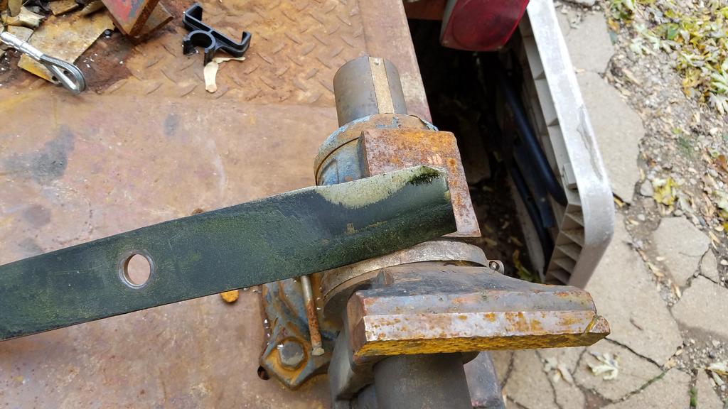

What is even more surprising is it did not damage the spindle - it still runs dead true with zero wobble . The hit did bend the deck housing slightly just inboard of the spindle - a few choice whacks with a 4lb hand drill and a block of wood fixed that - it was trying to hit the blade tips to the center spindle . Deck still cuts nice and flat now , just as it always has - amazingly tough parts . Both blades suffered some pretty heavy damage but luckily didn't break or shatter as they sometimes do - I was glad of that . Caused a 20 minute delay swapping the blade set for some old used ones ( I always save a couple old sets) and fixing the bend in the deck shell . Finished the rest of it in the dark and it looks great - temperature dropped 38* last night and today the high is 43* with high winds , again . Glad I got it done , hauling out the load to the storage unit later today .

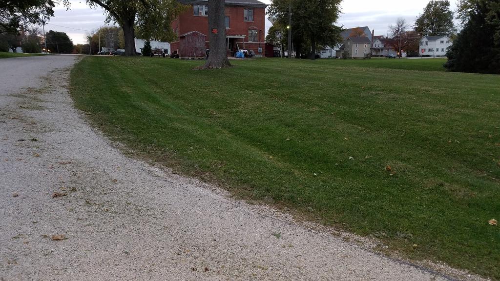

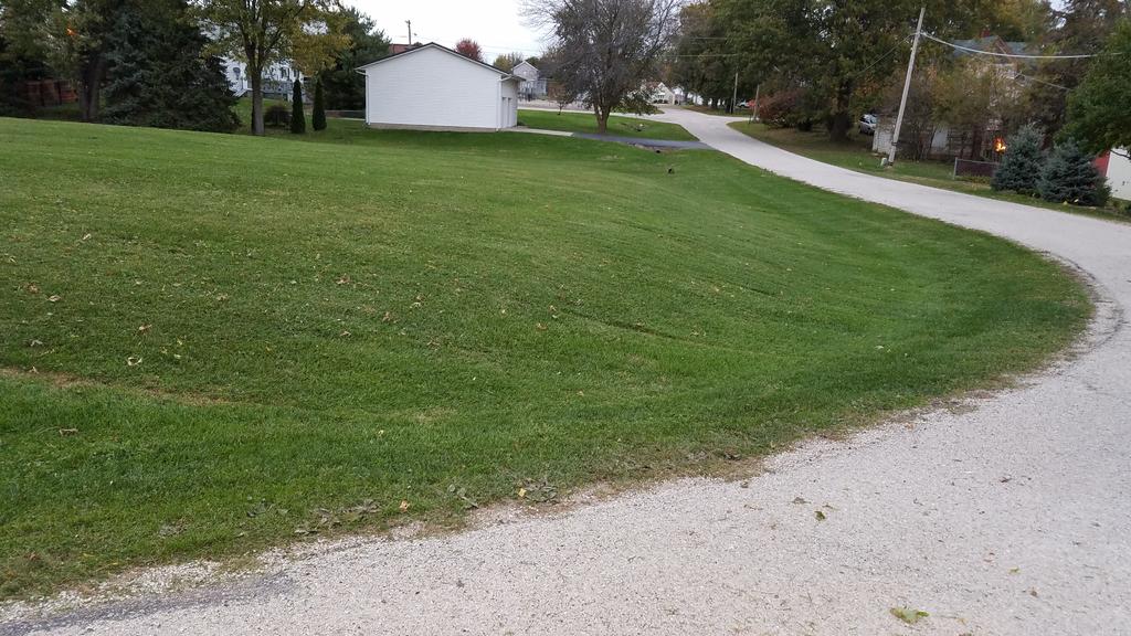

Here's the crazy property I mow where we rent - lot of hills and holes and places where no Kohler K series should ever go except up/down , never side hill it when mowing .
I'll have to grab a pic of the one blade that got the worst of it - held up amazing well against that cast iron .

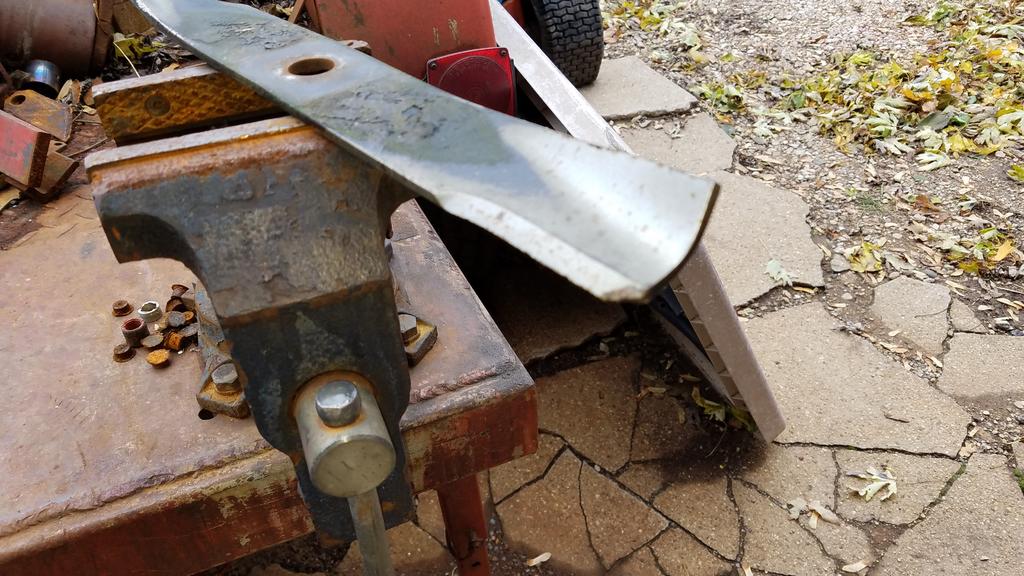

Surprising how little damage was done to the blade - I expected it to be broken off as they do most of the time but it just took a chunk of the end and rearranged it -
Worst part was this set was just put on this last spring so they've only been sharpened twice this year - no fixing this one . The spare I put on to replace it was worn down almost 1/4" already and it had to be ground again to get a good edge - but it leaves no lines in the grass which was a surprise . 20 minute repair and the Horse is no worse for wear - I love this beast . If I had hit that with the little Deere lawn tractor I'm sure it would have shattered the spindle at least and probably bent the deck shell into a pretzel - those newer spindles that JD used are really thin and weak in comparison .
