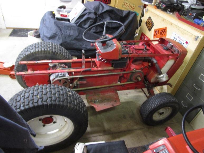

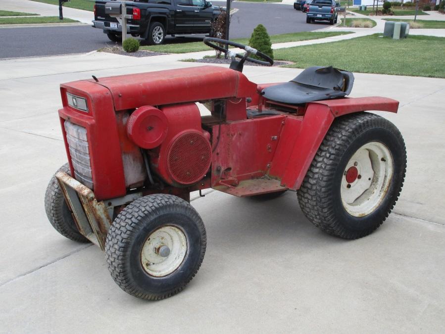

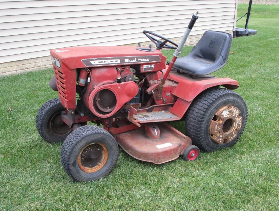

dtallon 320 #1 Posted October 22, 2017 Seeing some other GT14 threads on here inspired me to get started on my next project tractor. It was neck and neck between this and a Lawn Ranger 8-speed project, but this one has been waiting it's turn longer, so I figured I should get started before I loose my motivation. It's hard to believe, but I've had this GT14 for almost 2 years already. It was going to be my project last summer, but other projects kept coming up and taking priority. My plans for this are to use it for a custom 1/2 scale tractor project. I don't want to reveal too much yet because to do what I have planned will push the limits of my skills, and probably my patience, so there is a risk that part won't pan out. Before getting into the customization work, my focus is on getting the base tractor healthy. I changed the fluids and got it running shortly after I first got it, but I'm almost embarrassed to admit it had been long enough ago I forgot the specifics of how it ran. Fortunately, the engine started this weekend remarkably quickly after an almost 2 year slumber. There seems to be no issues with the engine, but the transmission is another story, and where I could use some guidance. Going forward is no problem. It won't quite pull the front wheels off the ground, but it will snap your head back a bit if you quickly switch from reverse to forward. At half throttle it will spin both tires pushing against a fixed object. Reverse though, seems pretty weak. Reverse speed seems only about half what it should be, and it will just barely, even at high idle, pull itself up the slope in my back yard. On the fixed object test in reverse, it just stalls out. I tweaked the neutral adjustment to try to get more out of reverse, but it only improved things a little. It also seems to want to coast forward downhill pretty easily, although it is hard to push forward and reverse with the tow valve closed. I saw a suggestion on here to use the hyd lift to help tell if the pump is OK. I stood on the 3-point with a 50lb. weights in each hand (~300 lbs total) and it lifted me without any trouble. I plan to check pressures once I get a gauge to test with, but since my problem seems mostly isolated to reverse I don't think it's the pump or motor. My next step will be to go through the valves and see if something is bound or if there is a broken spring. I'll need to split the trans eventually to fix the parking brake pawl, but would like to rule out the "easy" stuff before I get to that point. Any other suggestions would be appreciated. Dave 6 Share this post Link to post Share on other sites

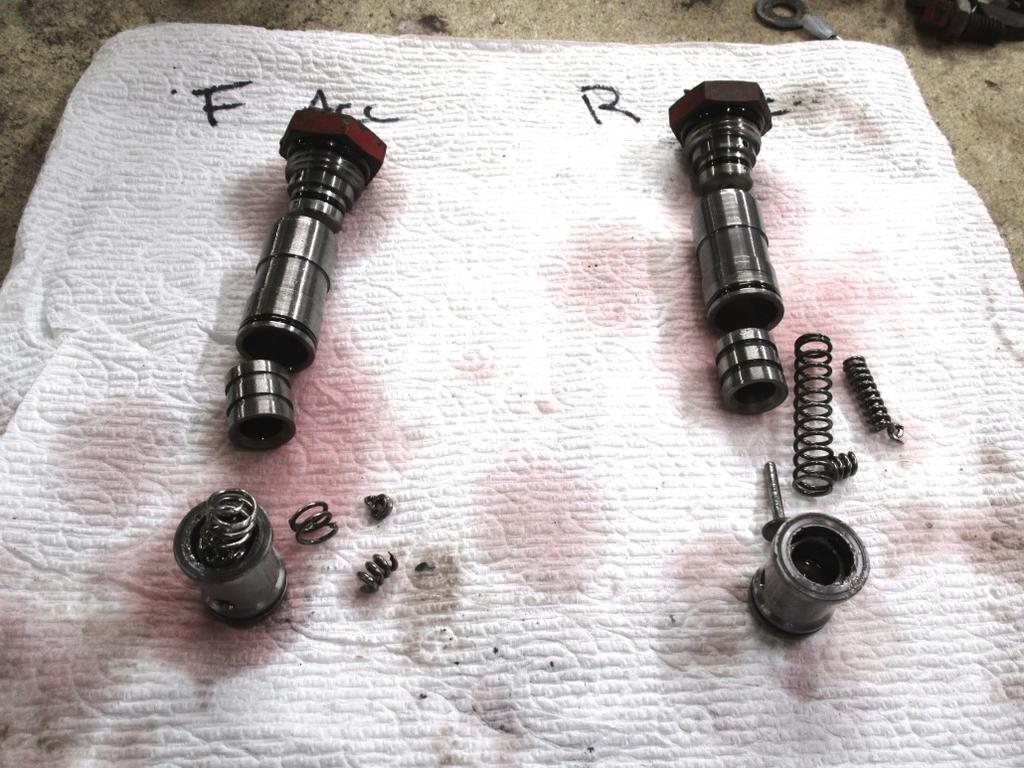

953 nut 56,057 #2 Posted October 22, 2017 When a Sundstrand Hydro works well in one direction but not in the other it is probably an acceleration valve or the associated springs. The valve near the front of the transmission is the reverse valve. Check the manual and it has good detailed information on them. 1 1 Share this post Link to post Share on other sites
R. L. Addison 299 #3 Posted October 22, 2017 I may have a few valve parts, as I think that is a hydrogear unit> 2 Share this post Link to post Share on other sites
Aldon 4,827 #4 Posted October 22, 2017 Nice looking GT14! A custom GT14 project will certainly test all of your patience and skills. But they are such a nice platform once you get it all ironed out. Good of luck and keep us posted. p.s. I similarly seem to delay a couple years before starting the projects in earnest and due to work and weather delays it seems it routinely takes me 18-24 months to reach the goal. Usually another 6 months to work out issues that surface once you get it done. I must have already assembled and broke down my GT14 8 speed project a half dozen times and I am guessing I'll do so 2-3 more before it's finally done. 3 Share this post Link to post Share on other sites
wfrpalm 218 #5 Posted October 22, 2017 That is a cool looking tractor, good luck. Share this post Link to post Share on other sites
19richie66 17,526 #6 Posted October 23, 2017 Ill be interested to see what it looks like. Hope you don't have to cut it too bad to achieve your final goal. Looks like a good stock tractor. Then again, who am I to be talking about not cutting up a tractor? 1 2 Share this post Link to post Share on other sites
dtallon 320 #7 Posted October 23, 2017 4 hours ago, 19richie66 said: Ill be interested to see what it looks like. Hope you don't have to cut it too bad to achieve your final goal. Looks like a good stock tractor. Then again, who am I to be talking about not cutting up a tractor? I'm still a little conflicted about modifying it the way I plan to. It's definitely a restorable tractor, but it's condition also is what makes it a good candidate for what I want to to. For the most extensive changes, I plan to remove the original parts and make new ones to bolt on, so if my plan doesn't pan out I can put it back to stock if I need to. I started the process of inspecting the valve last night. It's amazing how Wheel Horse could make the GT14 bigger, but yet there seems like there is less room to get to parts to work on them than the smaller models. It's definitely a different animal than the rest! 2 Share this post Link to post Share on other sites

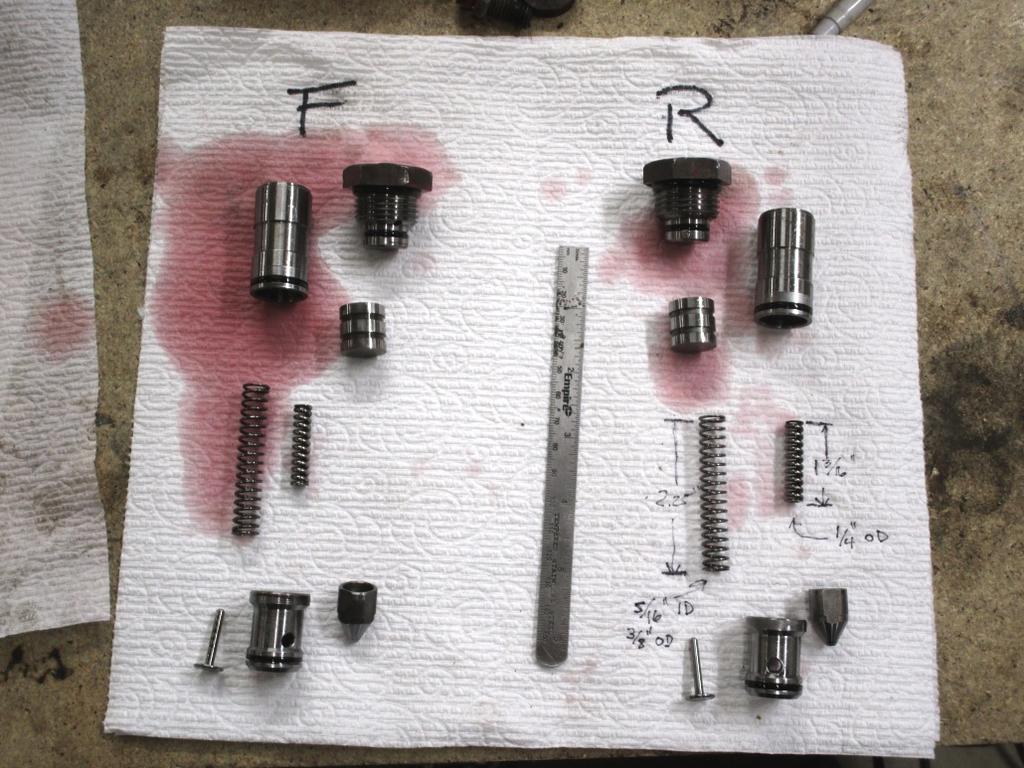

dtallon 320 #8 Posted October 24, 2017 It's a wonder it even moved at all! I got the valves removed for inspection last night. The check valves were in good condition so I cleaned them and put them back in. The acceleration valves however, are a different story. Since my problem was with reverse, I checked the reverse valve first. The most obvious problem was the small spring was broken. Inspecting closer, I could see the spring seat was slightly bent, and the cone had worn a lip into the seat and didn't want to come out. Feeling a sense of satisfaction in finding what I thought was the problem, I figured I should go ahead and check the forward valve while I was at it just in case. Oh my! The piston didn't want to come out by itself, but fortunately the sleeve did. Once I got the sleeve out, I could see the piston was hung up on a lip it had worn into the sleeve. The springs were both a jumbled mess, with parts of them and the spring seat packed into the valve seat. I ran out of time to do any further inspections, but it's already aparent that most of these parts are pretty bad. I'm concerned what collateral damage might have been done elsewhere in the system. Going forward, I have three options at my immediate disposal that I could consider. Option 1 is I have a complete pump/motor unit from a C-160 Auto. I bought it from a guy who said he was using it and he heard a pop and then it wouldn't move in either direction. He took it apart to try to fix it, and taking it apart was as far as he got. I'm not sure of compatibility, but it is available to steal parts from, or see if I can find the original problem and swap in the whole pump/motor unit. Option 2 is a complete pump/motor/trans out of a C-120 Auto. It came out of a tractor I parted out and I know it works other than the tow valve being stuck, but I kind of was keeping it intact as a back-up for my main mow & snow C-160. Option 3 is to go with the Richie plan and install a 520H pump/motor/trans I got out of a tractor with a blown motor. It seemed to work OK before I parted that tractor out. Of course Option 4 could be to punt and go hunting for parts and/or a whole different pump/motor/trans. I've been toying with the idea of ditching the 15" wheels and swapping in 5-bolt hubs to use 12" rims with some Interco Interforce 27x10-12 tires, so shorter axle length might not be a deal breaker for me. Suggestions and opinions are welcome... Dave 2 Share this post Link to post Share on other sites

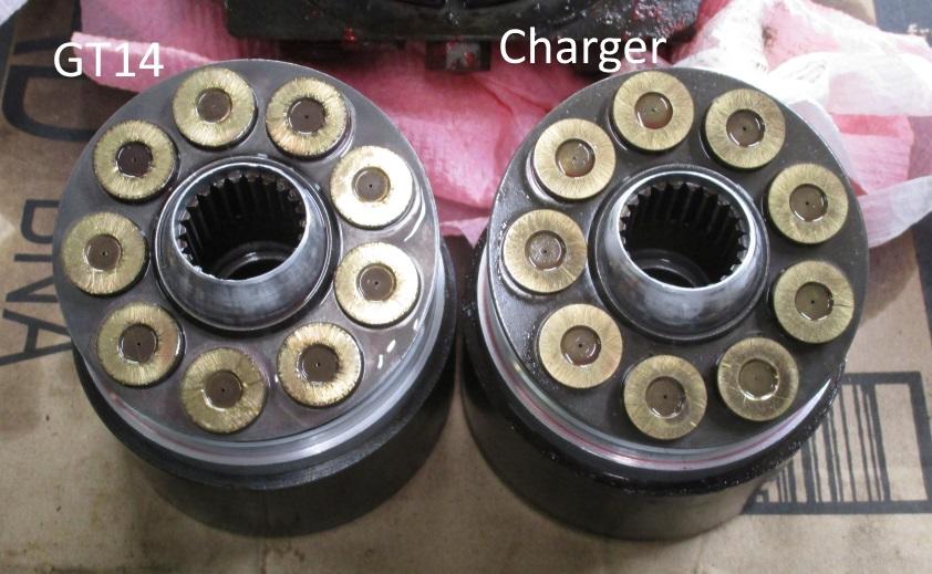

dtallon 320 #9 Posted October 30, 2017 (edited) It's far too soon to declare victory, but I do feel like I should buy a lottery ticket... I debated the best course of action for my GT14 hydrogear. Option A was replacement parts I found from local sources, but they weren't exactly cheap, and there was a risk I would put them in and find something else wrong. Option B was try to find a parts tractor with the parts I needed that was cheap enough that I could sell the parts I didn't need and recoup all/most of my expense. I took the gamble and decided on Option B. I scoured Craigslist for a parts tractor and settled on a well-used Charger. As seems to commonly be the case with these, the seller had sentimental attachment to the tractor but started using something newer and after going a season without using it, decided to sell it. Although it had the right parts, it wasn't running and the condition was kind of rough. I noticed some issues with the tractor overall, but it had good resistance trying to push it in either direction with the tow valve closed, and did what it was supposed to pushing it with the tow valve open. I decided to take a chance that at least the parts I needed were good. I don't know if I am the only one that does this, but as I started working on the tractor, I began to construct a bit of it's life story. The seller mentioned something about a front weight his dad used with the snowplow. I pictured a counterweight on the front of the tractor, but gradually pieced together from the lift handle extension and the brackets on the plow they mounted it on the blade. Not surprisingly, the additional weight and associated forces caused other issues. The hole cut in the hood for gas tank access wasn't just for convenience, the pedestal was cracked in several places, and pulled forward to the point that the hood was pinched closed. Also, I've seen cracked transmission mounting plates on frames before, but this was by far the worst. The tractor also had it's share of cracked sheet metal, brackets, and guards, and (yikes!) a makeshift cover on the air filter that clearly let unfiltered air into the engine. Aside from the abusive operation, the tractor revealed a few other interesting details from it's past. The Charger was missing a number designation from it's decals. It had a K301 on it, so I assumed the "12" had simply worn off over time. I noticed the oil drain was sticking out from the front of the engine, but assumed the engine had just been removed at some point for a rebuild and the oil pan just got put on backwards. Then I noticed a rectifier bolted inside the pedestal, which seemed odd since the engine had a starter/generator on it. Looking up the model number from the serial tag revealed that the tractor started life as a Charger 9, and the engine, or at least the engine covers, from a Charger 12 got swapped in at some point in it's past. So, back to the opening line of this post... In spite of it's appearance, with a good battery, clean points, and a new spark plug, the engine actually ran pretty well. The hydrogear functioned better than the one in the GT14, but still not as strong in reverse as some of my other hydro tractors. I wasn't sure if it was something internal, or similar to a thread I recall on here were flexing from a cracked trans mounting plate affected hydro functioning. After finding all the abused, broken, and worn parts on the tractor, I feared the acceleration valves would be no exception. To my surprise, I pulled them out and found all the parts intact and moving freely. Success! Of course the fun is only beginning. I now plan to pull both hydrogear units off the tractors and inspect the pumps/motors to decide which set to use. The GT14 pump seemed strong, but with the acceleration valve parts in so many pieces, it surely has had a fair amount of debris go through it. If I go with the one from the Charger, I understand I will have to swap the transmission input gear, but have already seen some good instructions on here for that part. I will post another update when I make some more progress. Edited October 30, 2017 by dtallon 3 Share this post Link to post Share on other sites
953 nut 56,057 #10 Posted October 30, 2017 5 hours ago, dtallon said: To my surprise, I pulled them out and found all the parts intact and moving freely. Success! Glad to see you kept the forward and revers valves identified. The passages in the forward valves are larger allowing for higher forward speed. 5 hours ago, dtallon said: I understand I will have to swap the transmission input gear, but have already seen some good instructions on here for that part. If that is the one I posted a few years back it was a bit of a leap of faith to do it, but worked out well. 1 Share this post Link to post Share on other sites
Sarge 3,464 #11 Posted October 31, 2017 Read up a bit on rebuilding those pumps - the early hydrogear is basically a non-rebuildable unit due to how it's pump is designed . Later model piston-to-piston pumps are much easier to work on and some resurfacing work in a few places makes a huge difference - there are also parts available from LJ Fluid Power in Michigan . The nice part here is the later model pump will fit in place of the original hydrogear - many dealers changed them when a problem arose or the original pump committed suicide internally - which happened to quite a few . It's a serious upgrade in comparison . Also , you can do the same with that Charger - find a later model C rear end or at least the pump/motor section and bolt it on - it will also be easier to add a hydraulic lift option if it doesn't have it already . The rear plate can be replaced by any good welding shop - just be sure they understand not to change the length of the frame overall to where the transmission attaches or the original linkage/belts will not work correctly . The breaks in those are quite common - the one in my 1277 has broken at least twice and it now shattered like that Charger - it's getting a new one when I can get some time . The reason I bring this up is that Charger is one of the wood grain hood models - one of my personal favorites and it's in at least a repairable state - not many left . I rebuilt a '68 for my brother in law and it's an excellent tractor with it's limited slip rear diff - traction is awesome . Sarge Share this post Link to post Share on other sites

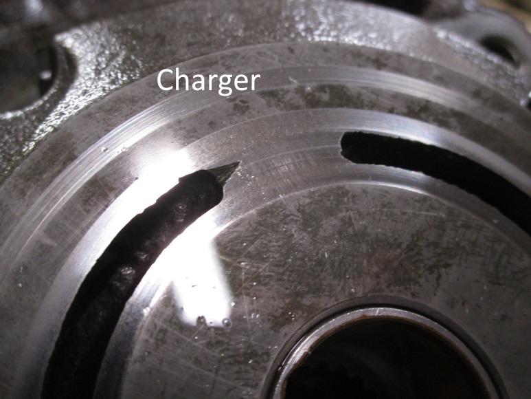

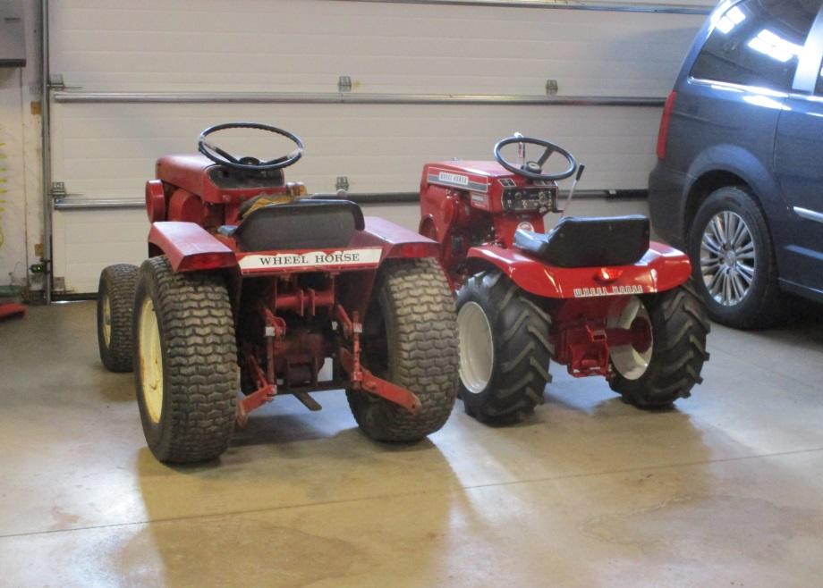

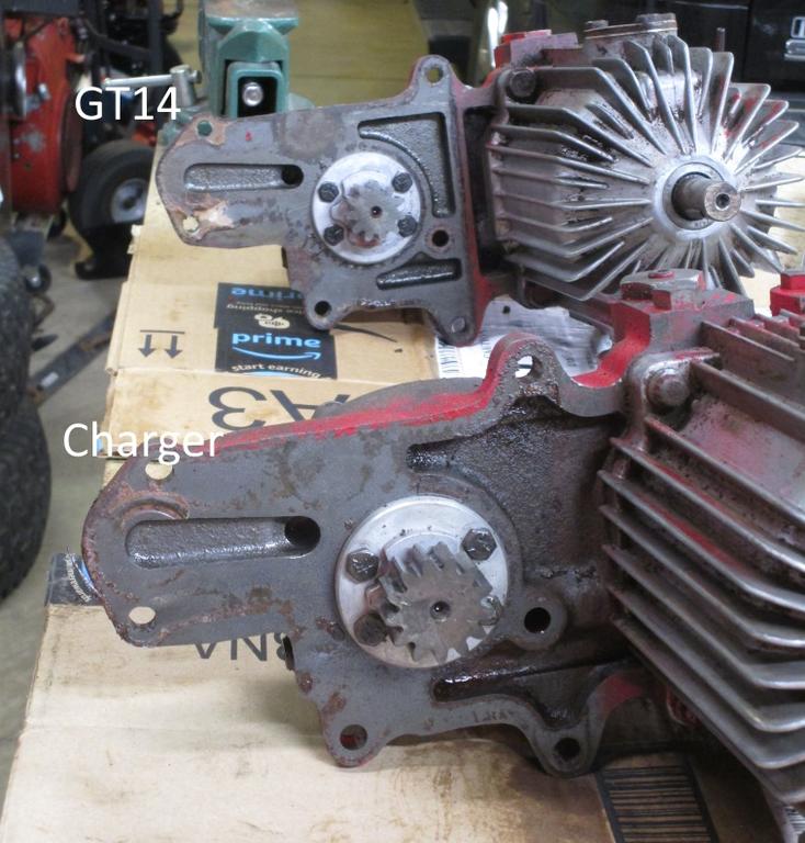

dtallon 320 #12 Posted November 3, 2017 The woodgrain styling IS kind of growing on me. Unfortunately, I am at max capacity for tractor storage, so it is either the Charger or the GT14, and I've already mentally committed to the GT14 project. I do feel remorse when I part one out, but find solace that the parts will help revive another one. I did say it was too early to declare victory, right? Removal of the pump/motor on the Charger revealed only remnants of an inlet screen. Thankfully the screen cap was still inside the transmission case, but I'm assuming that pump/motor had at least some screen material and shards of the typical non-functional parking brake pawl go through it. It also wasn't a total surprise based on other abused parts that the axle and hub keyways were heavily worn. At least when the axles can spin inside the hubs, the hubs come off easy. I put the Charger valve parts in the GT14 valve body to give them a try. I still need to drain and split it to fix the parking brake, and see if it has a screen, but figured it doesn't hurt to see how much improvement the valves make first. Hopefully this weekend I will get a chance to test it again. 1 Share this post Link to post Share on other sites

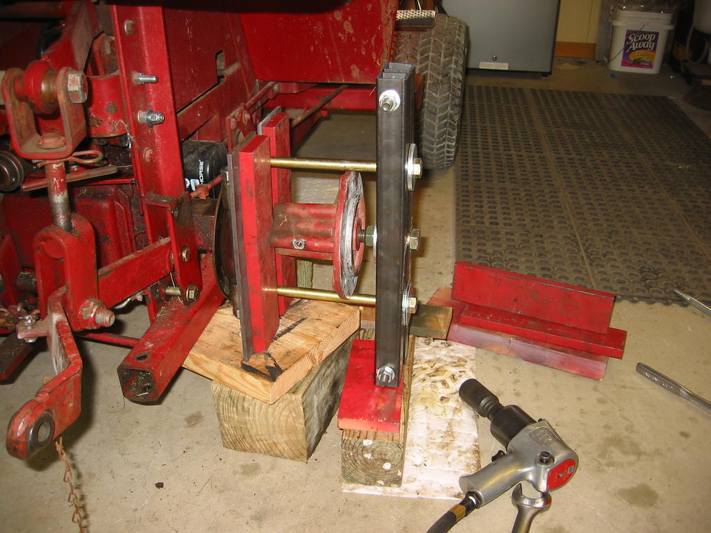

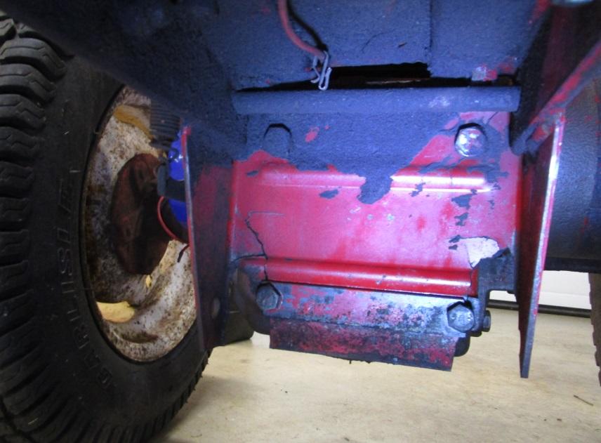

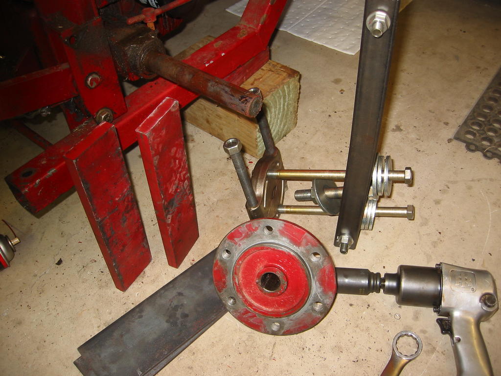

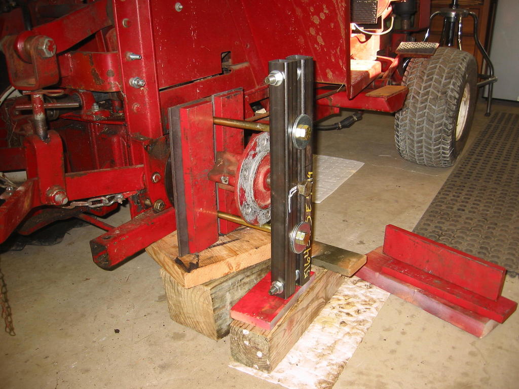

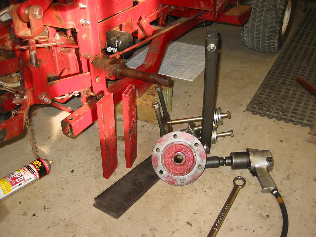

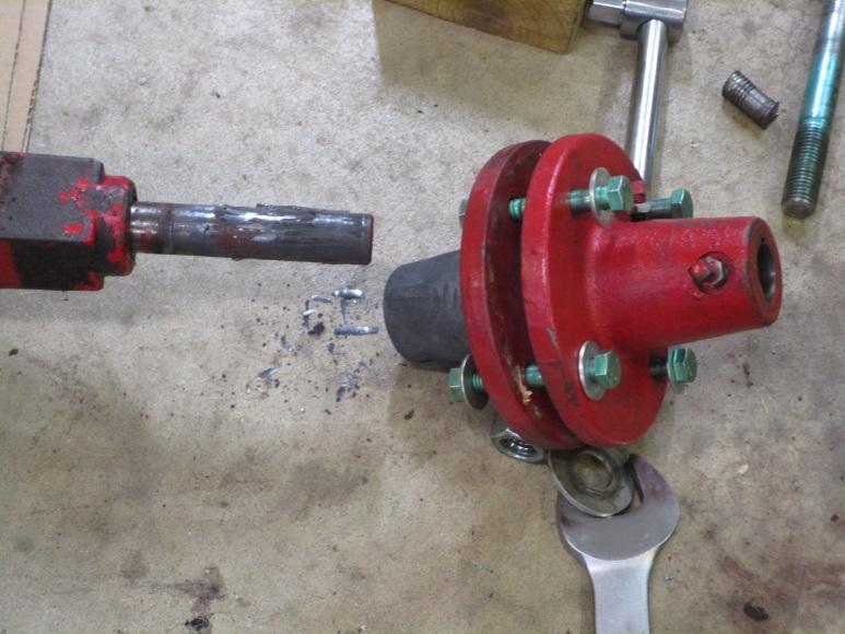

dtallon 320 #15 Posted November 7, 2017 One step forward, one step back... Work on the GT14 continued yesterday and tonight. The right hub came off with very little trouble. The hub actually would turn just a little on the axle, but I don't see any obvious wear on the hub or axle, so hopefully a new key will tighten things up. The left hub, on the other hand, is being very stubborn. I'm alternating heating, pulling, and soaking with penetrating oil, so hopefully it will give in sometime this week. While waiting on the left hub, I decided to pop open the transmission case. The little aluminum fan inboard of the pulley sticks out just far enough to interfere with taking the right half of the transmission case off, so I had to pull the pulley/fan off first. On my first attempt, my gear puller took a small chunk out of the pulley. I think I could probably get by with still using it, but I will see if I have any other pulleys that will work. With a little more finesse, I was able to get the pulley off without any further damage. With the fan/pulley out of the way, I was able to take the transmission apart. I was glad to see the screen still in good shape, and no metal pieces lurking in the bottom, but when the intermediate shaft came out, so did some needles from the bearings on each side. So, obviously both of those will need to be replaced, but I think the needles stayed in there until I took the shaft out. In checking the bearings for the input shaft, I turned the shaft, which was still engaged with the motor, and noticed a sort of ratcheting, pulsing sensation coming from the motor as it turned, which I think may be the "click-click-click" I heard before. The motor out of the Charger doesn't seem to do that, but I'm not sure which is the "right" way it should behave. For sure the parking brake needs to be repaired/replaced. I'm 3 for 3 on transmissions of this style being worn down. Work will continue as the week goes on. I'm pretty sure the pump/motor will have to come off to replace that intermediate shaft bearing, and it will probably be easier to replace if I uninstall the other half of the transmission from the chassis. Why do I feel like I"m going backwards on getting this project completed? 3 Share this post Link to post Share on other sites

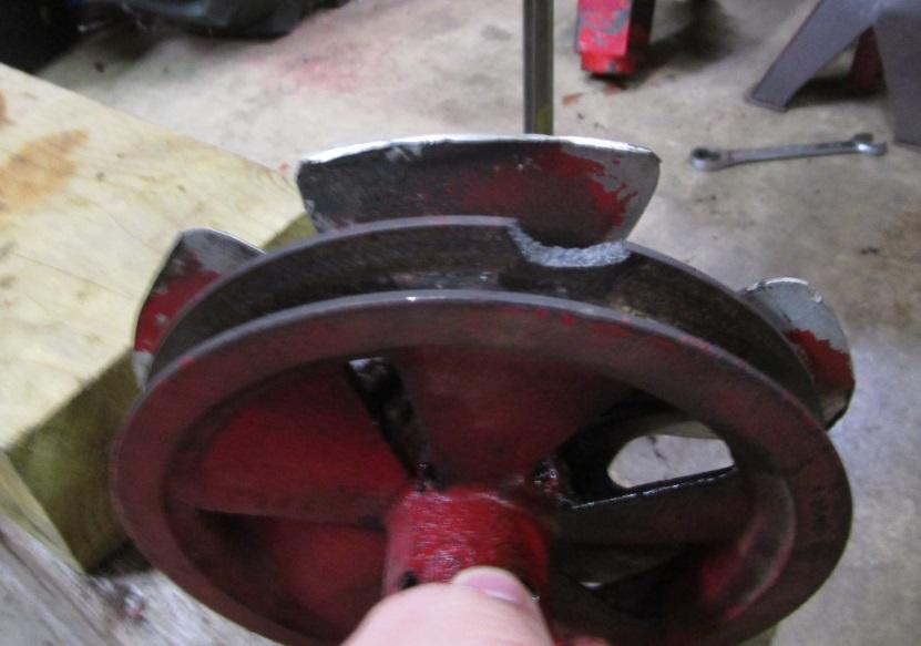

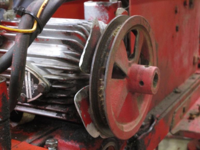

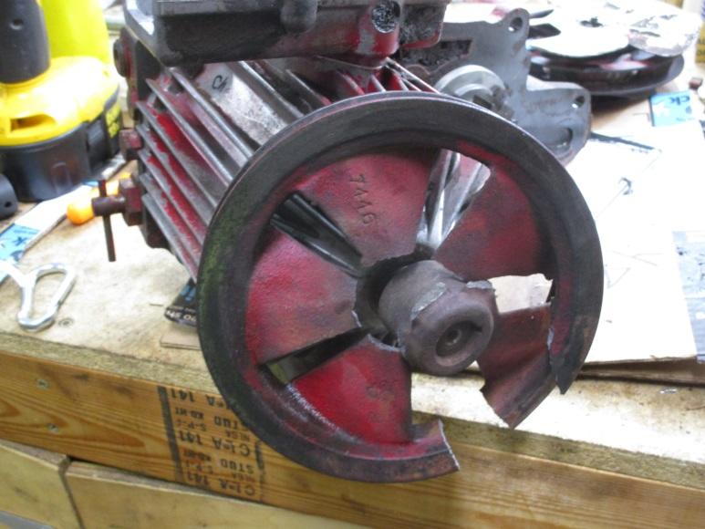

woodchuckfarmer 333 #18 Posted November 8, 2017 Have that chip brazed back on that pulley. It will save a lot of wear on your belt. Wayne Share this post Link to post Share on other sites

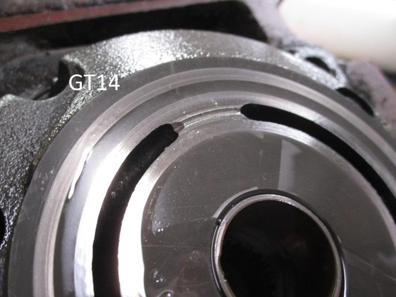

meadowfield 2,614 #19 Posted November 9, 2017 I had the same bearing fail, if you work out what the clicking is then there is a another thread on a c-160 that clicks... I suspect it is the pistons slapping on the thrust ring, I've never listened for it on either of my GT14's 1 Share this post Link to post Share on other sites
Lee1977 6,856 #20 Posted November 11, 2017 There was some one who a clicking in there transmission a few years ago. It was the dip stick been hit by something. The picture above with that dip stick leaning forward it could be the same. Share this post Link to post Share on other sites
dtallon 320 #21 Posted November 13, 2017 (edited) I'm not totally sure I have solved the mystery of the clicking, but at least have a theory. As I said, I didn't notice it when I was driving, but did when I was pushing it around the shop. That moving it around and turning the motor by hand was after I had drained the fluid. The Charger wasn't as noticeable under the same conditions, but as I started taking things apart further I found out that the Charger motor had more fluid left in it, whereas the GT was mostly empty. I'm wondering if it isn't normal "gear noise" (or at least normal for a nearly 50 year old hydrogears) when the noise isn't dampened by fluid. Progress has been a little slow on the GT14 project. I'm still fighting with the LH hub. I've fought hubs before, but I'm not sure my little Propane/MAP torch can put enough heat into the the bigger GT14 hubs to persuade them to budge. The pulley on the Charger hydrogear was also even more stuck than the one on the GT14. Soaking, heating, pulling for a few days still didn't generate any movement, and then I tightened the puller a little too much and the fan part of the pulley actually broke off the hub. At least once the fan broke away it was easier to just cut the hub off. I hate to destroy a good pulley, but sometimes they just won't budge. With both the GT14 and Charger hydrogears off, it was interesting to compare the two. I know they are different models, but I was surprised that the GT unit has a different body casting than the Charger. The GT14 casting had a partition along where it would meet the top edge of the transmission. The Charger did not, so material could get down in there and pack the pockets between the motor and transmission. I also noticed the GT had regular hex bolts on the pump instead of 12-point bolts on the Charger and other piston/piston WH hydros I have worked on. I could also see the gasket for the pump on the GT14 had more excess sticking out than the Charger. It makes me wonder if the GT14 pump has been removed before. There were also other differences in the GT14 valve body in some port locations and sizes, and the acceleration valve caps did not have set screws, where the Charger ones did. I decided to take apart both pumps to see which one looked in better condition. First was the Charger. I was glad to see the slippers didn't look too bad. Some scratches, but none so deep that I shouldn't be able to remove or improve them with some polishing. The GT pump was definitely worse than the Charger. The same could be said for many other parts of the GT14 hydrogear, not a total disaster, but definitely worse than the Charger unit. So, the plan is to swap the Charger hydrogear for the GT14. Of course, that requires swapping the drive gear from the GT to the Charger unit, plus the hydraulic lift parts. Oh, and that stubborn hub still needs to come off. I've heated it up enough that I'm sure the axle seal on that side isn't good anymore, so just leaving it on there probably isn't a good option. Edited November 13, 2017 by dtallon 2 Share this post Link to post Share on other sites

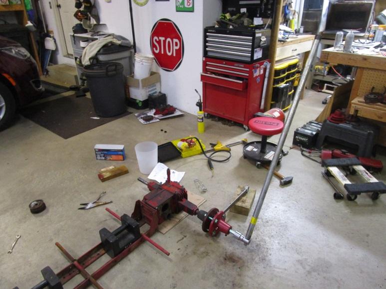

Sarge 3,464 #22 Posted November 13, 2017 Looks like it's time to invest in a good quality bearing splitter and the correct puller stinger - https://www.amazon.com/dp/B0002SR47M/ref=psdc_15708881_t1_B000X1E3F4?th=1 These tools are designed to fit into tight places behind objects and put the force in a straight line - which is really key to getting this stuff apart . If you ever want to tackle a manual transmission - they are a must . Never met a hub I couldn't get off yet - but I do have a large Harris gas ax as well as two large demolition torches . Heat is not a problem , melting parts is ....lol . If you run into a problem , hunt around for a welder with a portable torch - for a small fee they will stop by and heat up the part while it's under pressure , makes a big difference when you can heat a part very quickly . Sarge 1 Share this post Link to post Share on other sites
pfrederi 17,953 #23 Posted November 13, 2017 This set up worked on my recalcitrant D200 hub. Key here is to pull on the back the hub not the flange it will break. Note the square tubing is bent that is not an illusion that hub did not want to come off but it did finally and in one piece 4 Share this post Link to post Share on other sites
ztnoo 2,298 #24 Posted November 13, 2017 The right side hub on my GT 14 was the toughest thing I have ever encountered working on a lawn tractor. A real test of time, energy, patience, not to mention persistence and the usage of graphic language. Few things compare to the degree of difficulty which can be encountered with wheel hubs. Share this post Link to post Share on other sites
dtallon 320 #25 Posted November 14, 2017 Good suggestions from all of you, but I'm happy to report I finally bested that hub, and fortunately didn't break it (or anything else) in the process. I decided to throw the kitchen sink at it. I had been going at it with the LH of the transmission still bolted to the tractor, so I took it the rest of the way off and put the RH half back on to better support the axle. Then I bolted it to a spare frame I had sitting around, but upside down so I could put weight on it to keep it from moving. I set it back up using the RH hub and a 7/8" bolt as a puller. I heated it up with the MAP torch like I had been, but then got myself an early Christmas present of an Oxy/MAP kit. It's more set up for brazing and cutting, but so long as I kept moving it around it heated up the hub without damaging it. Finally, that got enough heat into it that with a 3/4" breaker bar and a 4' cheater pipe it started to move. Once I got it to move about a 1/2", it started moving easier, although I wouldn't say it moved easily until the last 1/8" or so. It was quite a satisfying feeling to get that hub off. Still a ton more to do, but it was a nice little victory to cap off the weekend. 1 1 Share this post Link to post Share on other sites
