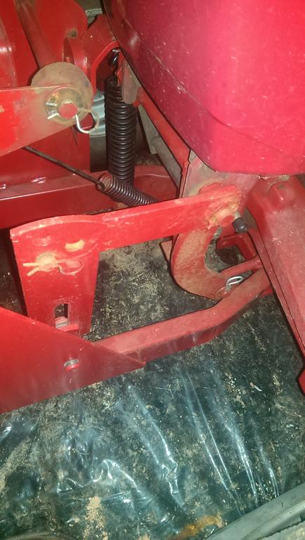

Just picked up a 2 stage blower which I have never owned before.  While looking at the lift rod it just looks bent.  I need to know if the bend in the rod is normal or did it bend from stress or running into something in the past.  See pic

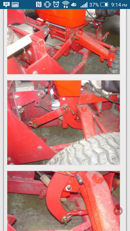

I believe it should be "straight", Jeff.Screenshot_2015-10-20-21-14-41.png.f6f81dc3cfbe116bbe76624cbd58edc6.png

Thanks for the pics Jeff. It is definitely bent
wallfish
looks like the piece it's connected to is bent as well. It should be connected to a curved piece but that curved piece should be flat.
(does that make sense?)
grinchsr
Yes it does John and thanks.  That whole area was mangled for what ever reason but last night with the help of a torch I managed to straighten it all out.  I will find out more when I get it mounted which looks like a major under taking.
