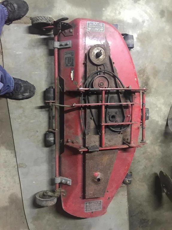

I need the middle spindle shaft for this deck, is there a manual or parts manual on here. I want this deck for my 520-8, I believe the bearings are good.  The key way on the shaft that goes in the pulley busted so the shaft is junk.
