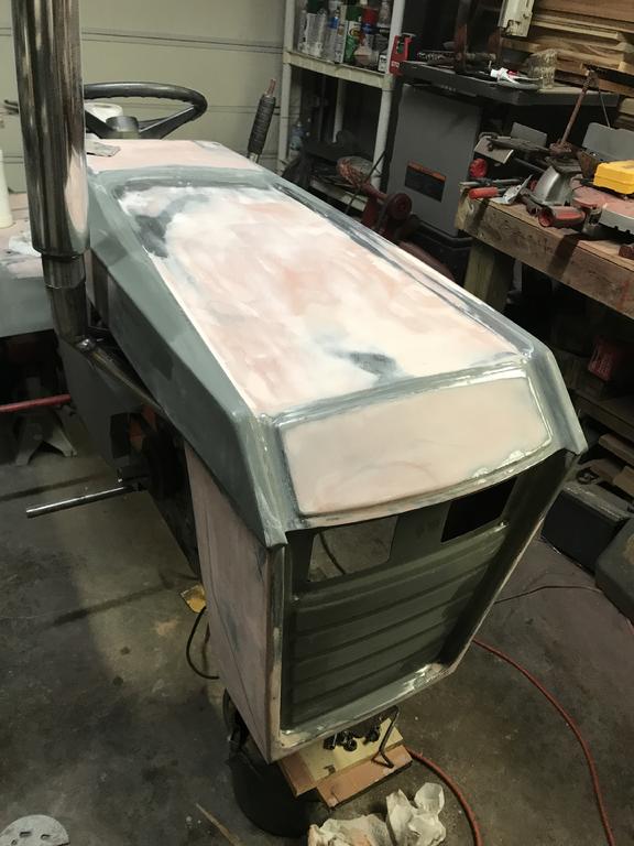

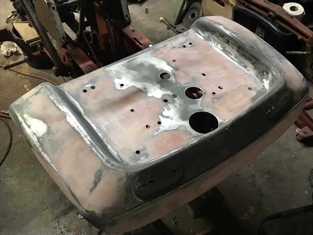

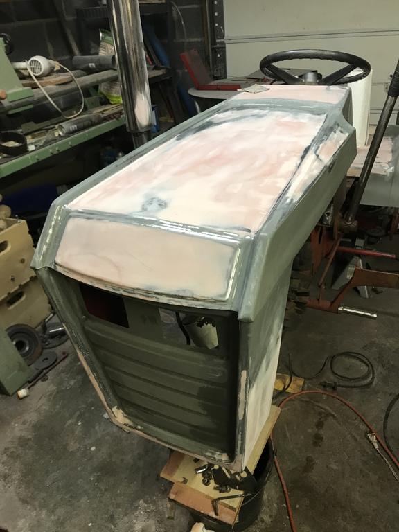

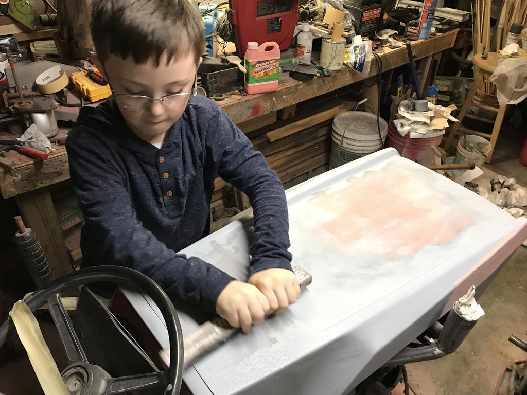

Well, I've been busy rubbing bonds and block sanding.  Finally, I think I'm ready for the first coat of filler primer.  It'll be late Sat. before I get to try a coat.  I have to work a pancake breakfast at school that morning.  I hope to get the first coat of metallic black on the hood soon.

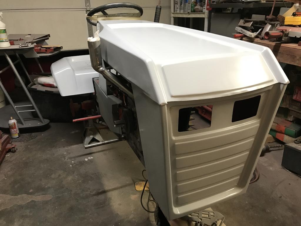

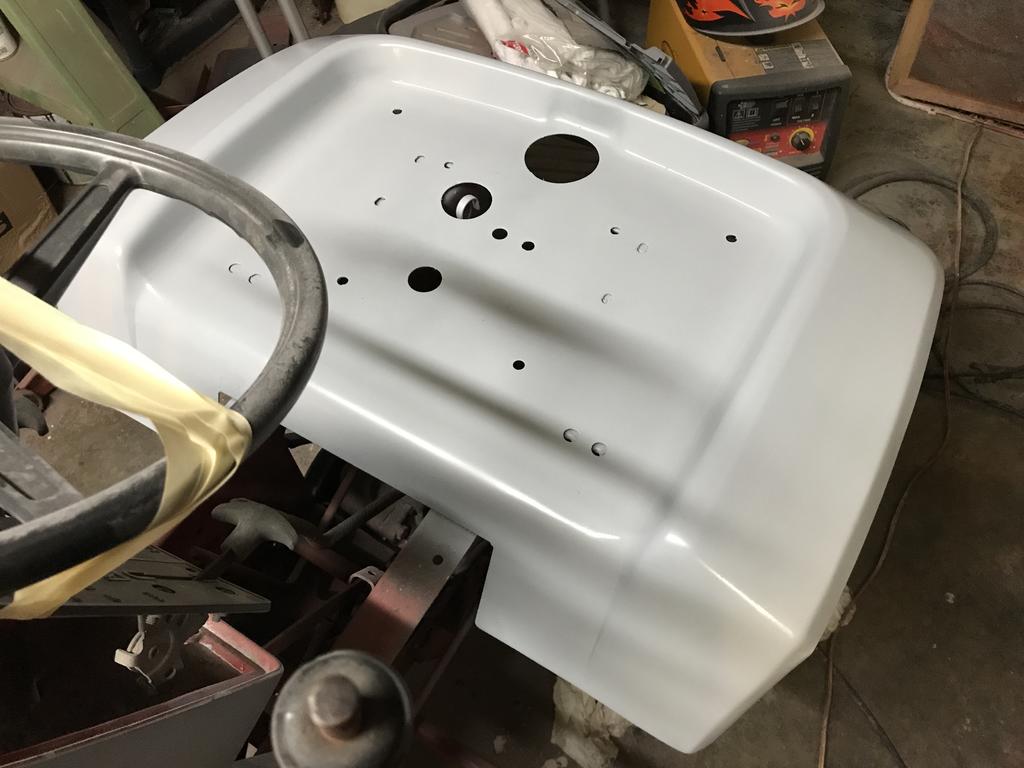

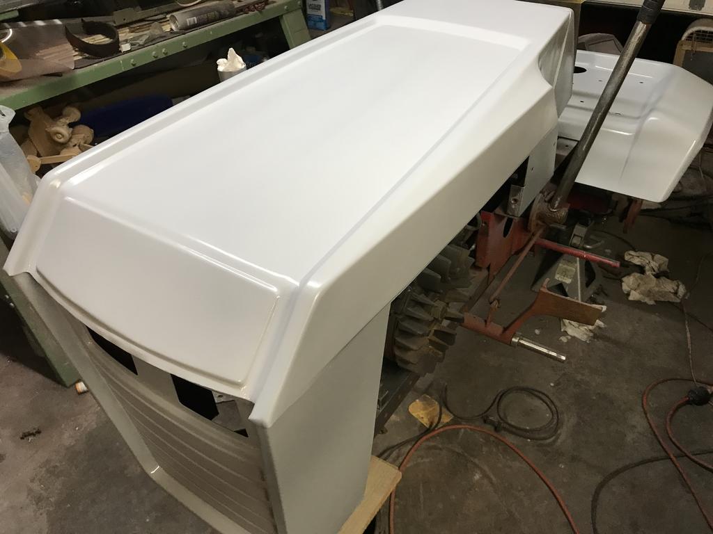

Shot the first couple of coats of high build primer tonight.  Found a few dents on the right front corner that will need to be addressed.  All in all I'm pretty happy.  Hopefully the next pics I post will be of the metallic black sometime early next week.

Look at Emory using that hand/arm :handgestures-thumbupright: ... That’s some good occupational therapy right there and he doesn’t even realize it . He’s a little man on a mission making sure it’s nice and straight. :woohoo:

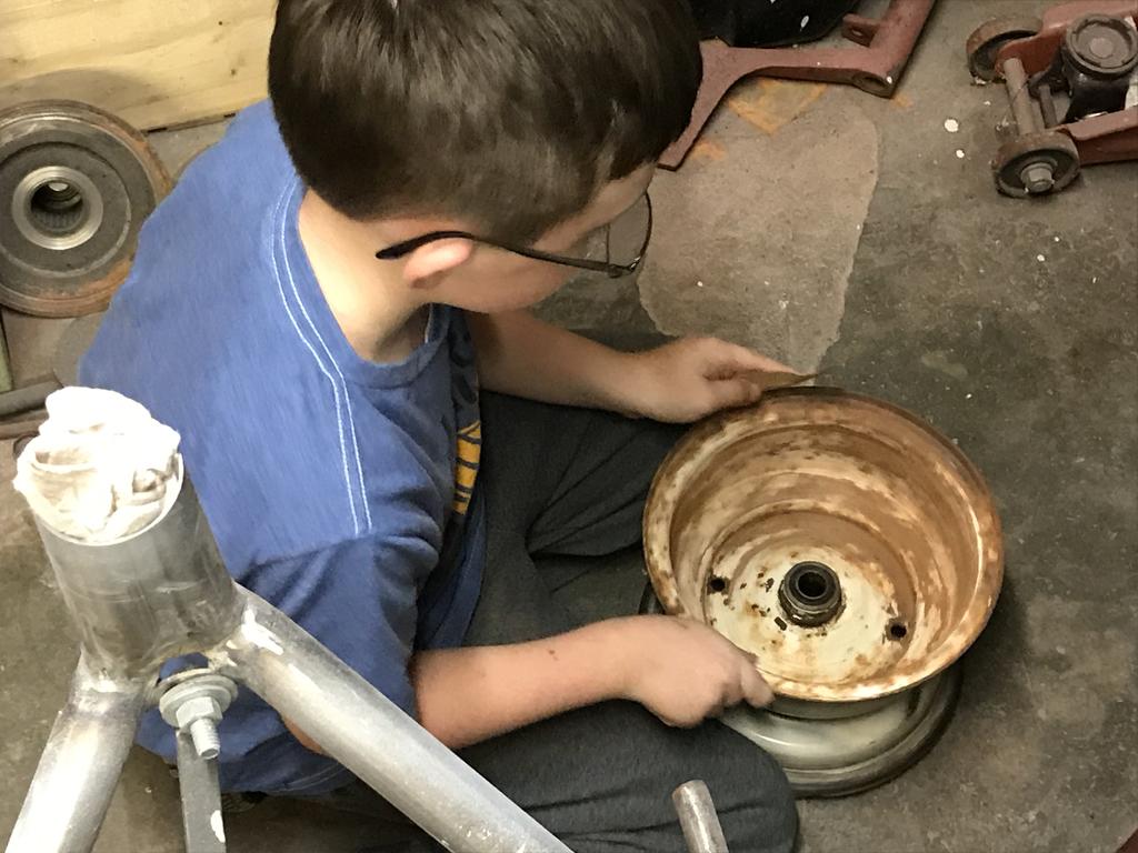

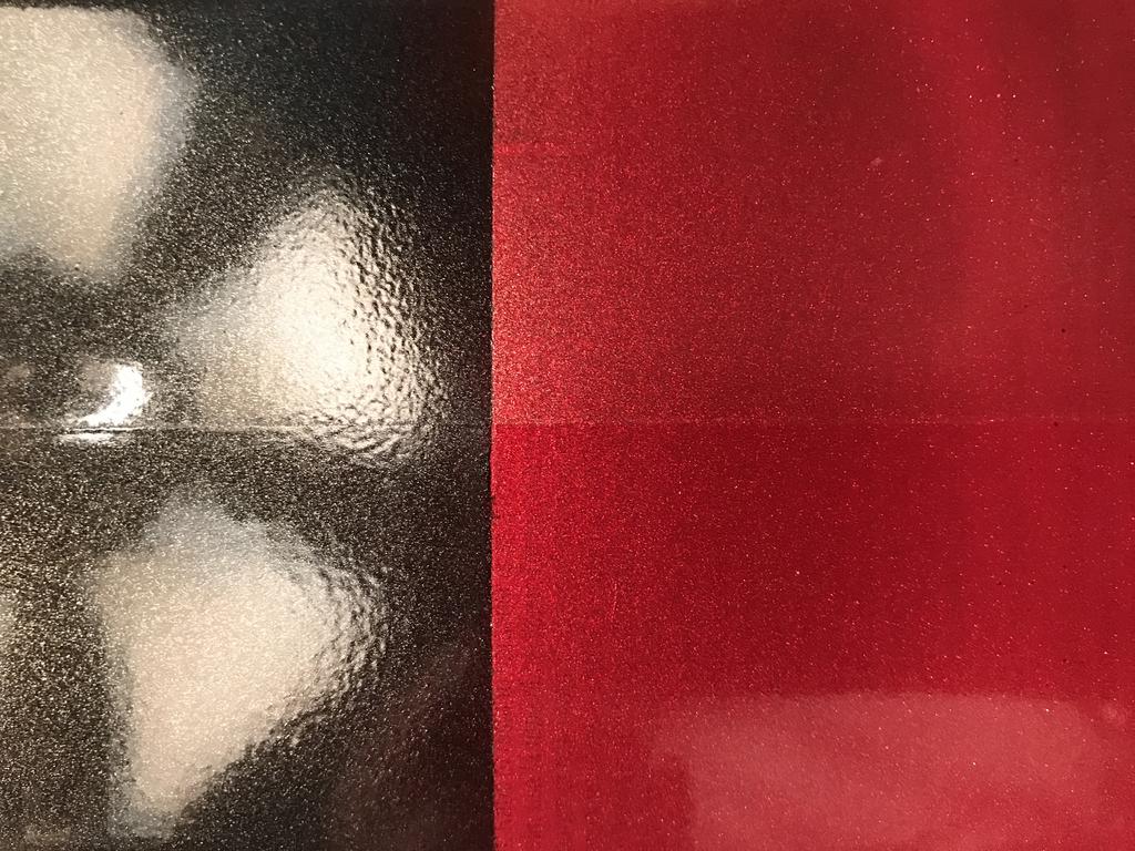

Got a little more done today.  Emory and I sanded his front rims, I primed the wheels, and sealed the seat pan and hood.  I also sprayed a test of the color combo - metallic black and Rustoleum red speck metallic.  After clear (bottom of the picture),  they'll look great.  Ignore the reflection, that's the lamp I took the picture under.

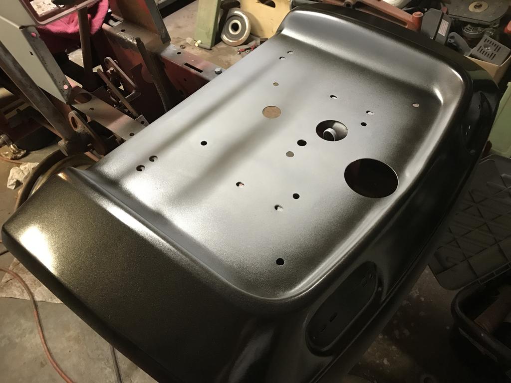

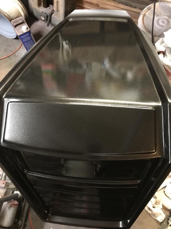

Came in with a pounding headache, but needed to get the metallic black laid down since it is lacquer based and has to go down before the red and clear enamel.  Now to try to mount the rear tires if I have enough energy so I can paint the rims (I'd mar them up if I painted them before mounting the tires).  Oh, there's a rear fender surprise coming - a little twist on Terry's flat black fender decals.

I like the black paint , are you going to use the red as accent ?
dells68
On the hood I'm going to paint everything else with the red metallic, just the original recessed area will be black.  On the rear fenders, I'm going to carry the black insert idea over to the fender tops.  I'm going to wrap the black all the way around the fenders across the taillight area in the back.  I plan to use the black on the shift plate/cover and the vertical piece under the dash.  Just trying to make it a little different for Emory, so it will be all his.  I also had @Vinylguy customize a set of his carbon fiber look decals for me and they are awesome!  Terry's work never disappoints!

Thank you.  I'm very pleased with how smooth the hood came out, but am a little disappointed with the fender pan.  There are a couple of spots that you can see my bodywork.  Honestly, I think I missed it because I spent so much effort on the hood and got careless.  At least it's not up there on that big ole flat hood!
Skipper
You are probably the only one that will ever notice it, so do not sweat it ;-)
