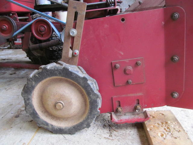

Ed Kennell 41,556 #34 Posted October 13, 2017 (edited) I hear ya Eric. I don't have a steering problem on the first pass in new snow when the pressure is equal on the blower. But after that, the blower tends to keep going toward the wing that is cutting the new snow. And with my steep driveway and stone road, I have to lift the blower to back out and realign. Of course when you lift the blower, you loose traction on the rear wheels. I have added wheels to my blower that should help it to track in a straight line, but we haven't had a good snow to test it in for a few years. Maybe this will be the year. BTW Eric, we lost the football game last night. Edited October 13, 2017 by Ed Kennell 1 1 Share this post Link to post Share on other sites
ericj 1,579 #35 Posted October 13, 2017 51 minutes ago, Ed Kennell said: But after that, the blower tends to keep going toward the wing that is cutting the new snow. And with my steep driveway and stone road, I have to lift the blower to back out and realign. Of course when you lift the blower, you loose traction on the rear wheels. I don't have the problem with pull on the 2 stage blower so that makes the difference, and I'm sure the hill and stones makes a difference too. Lifting the that hulking 2 stage blower takes weight off the back tires, that is why I do run chains on my blower tractors. if we get some snow this year I might get to try the single stage blower more. I do remember running a single stage blower on my C120's and having the problem of the blower pulling in on the side of the snow. eric j 1 Share this post Link to post Share on other sites
