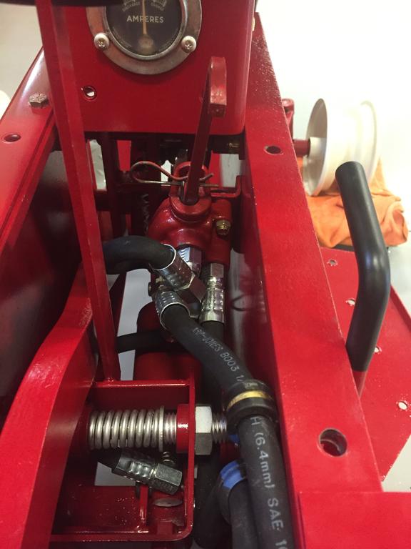

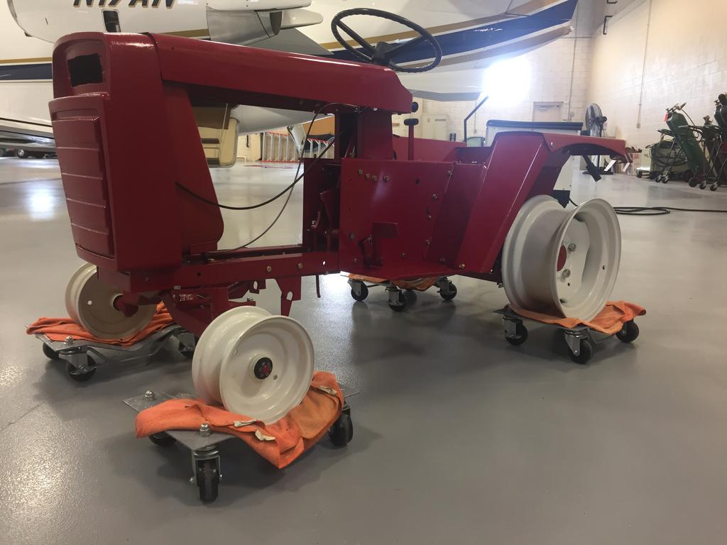

Try to route those hydro lines as far as possible from that direction control linkage - it moves quite a bit in that area . That's going to be one sweet GT-14 for sure , can't wait to see the finished result . Always kind of wanted one myself , but every one I ever found close by was either overpriced by a mile or in such bad condition it would be easier to build one from scratch .
Sarge
p38js
Thanks Sarge,  believe it or not the hoses are not hitting the linkage.  Spent quite a few hours making sure nothing touches.  It was a chore because you can’t get the original hose ends that wheel horse used had to go to the next size up which made things a little more difficult.  But nothing money won’t fix.

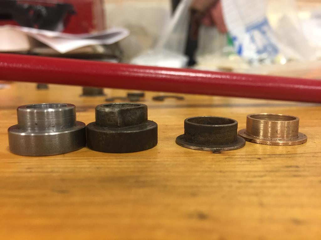

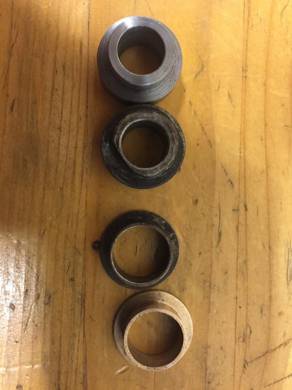

i fell in love with GT14 the first time I saw one at the big show. I had to buy two so I could make one.  I had to make all of the bushings and spacers for the old girl.  This was definitely more of a challenge to restore than the C120 I did a few years ago.
Sarge
All the early model tractors prior to '73 used a lot of very specific sized bushings - most of which aren't available new and most times not something you can get off the shelf - if you're going to work on those models you'd be wise to invest in a small lathe - which causes even more expenses , lol....
I can't tell you how many parts I've had to make like that - but the parts I've made were an upgrade by a mile compared to what was originally used and should outlive me easily . Biggest upgrades are to the front axle and all those pivot point bushings on the tractors - some of the originals were plastic where they should have been bronze or brass at least . Due to stress I've even done some of them in bearing grade steel , which isn't cheap but worth the effort to prevent and stop wear problems . I wish I had a decent sized mill - it would be far easier to set up a jig and bore out axles to fit sleeves and correct worn holes that are no longer round instead of using bridge reamers and sizing reamers to get the holes to the right size . Once done - those axles are better than new and if properly greased should never wear out another spindle - many of which are again NLA parts . The uses for a lathe are endless - not sure how I'd get anything done without mine...

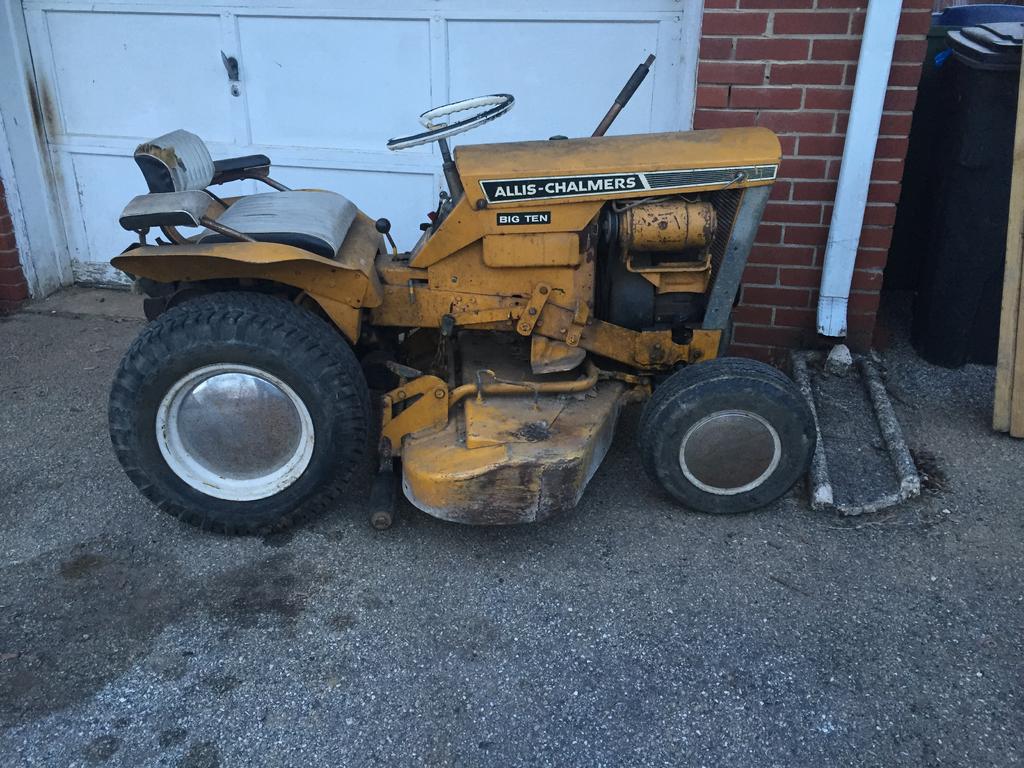

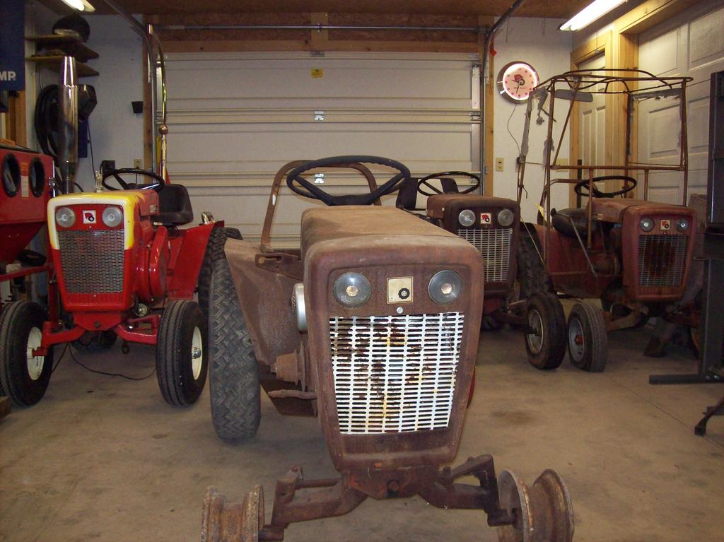

Yeah I have a slight problem so far in the barn are 2 Gt14’s, C-120 restored, C-160 worker, and an AC BigTen that was my Grandfathers.

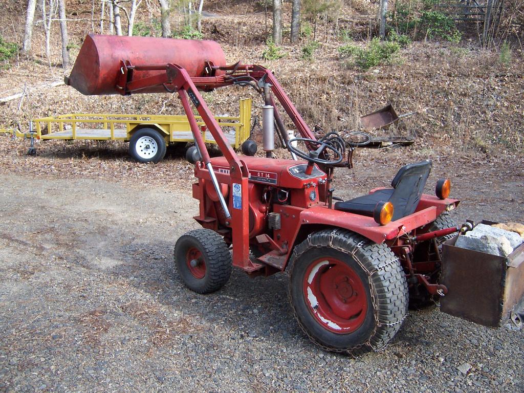

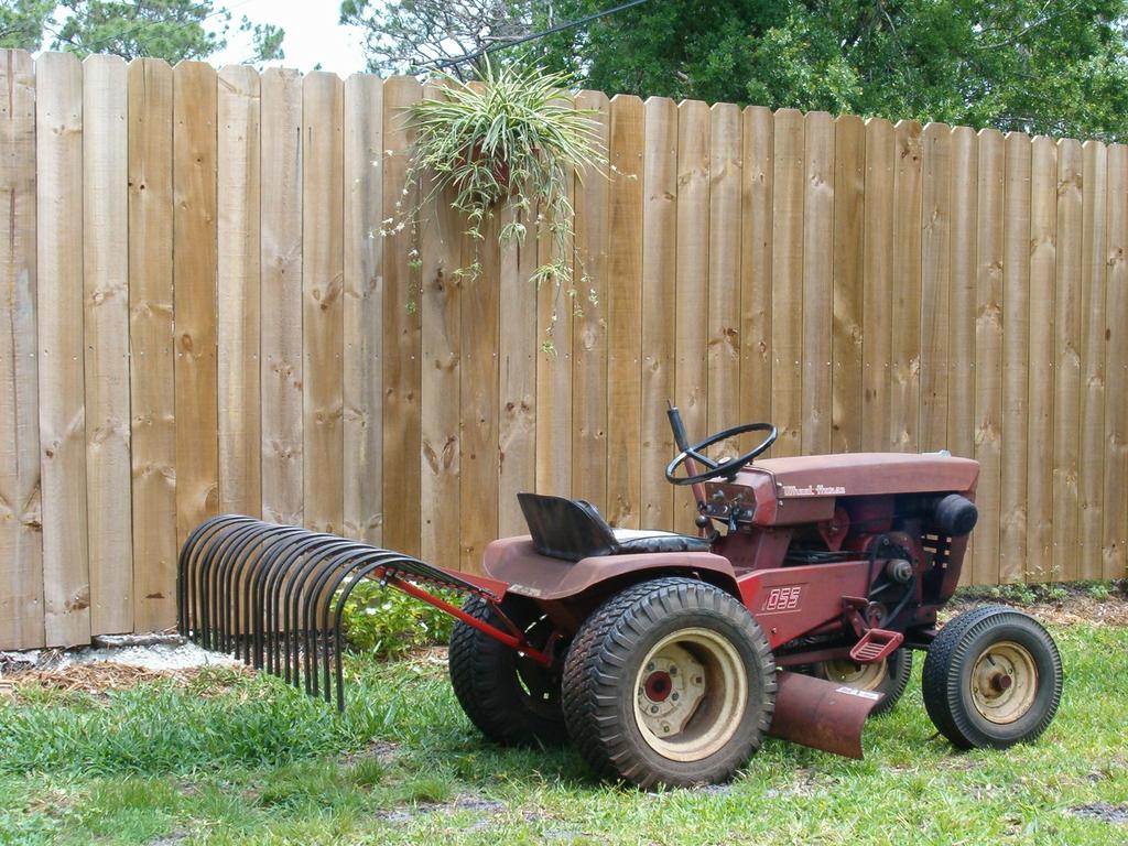

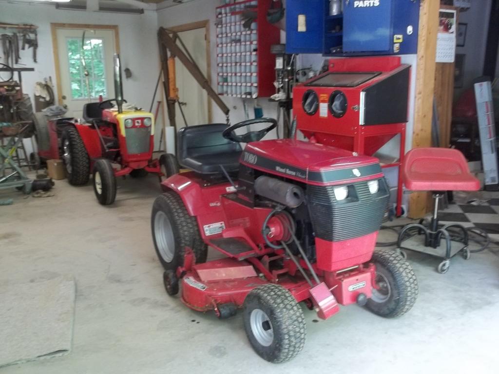

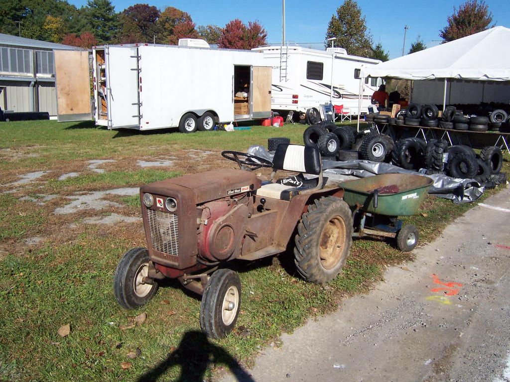

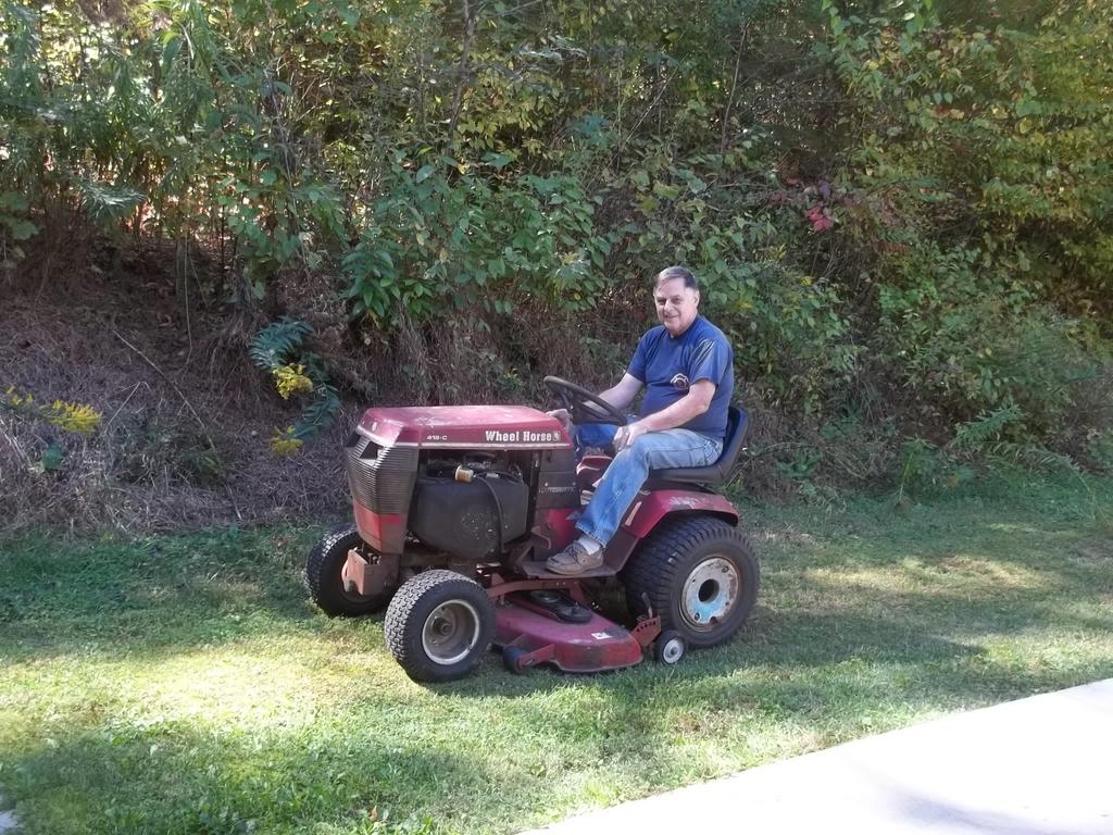

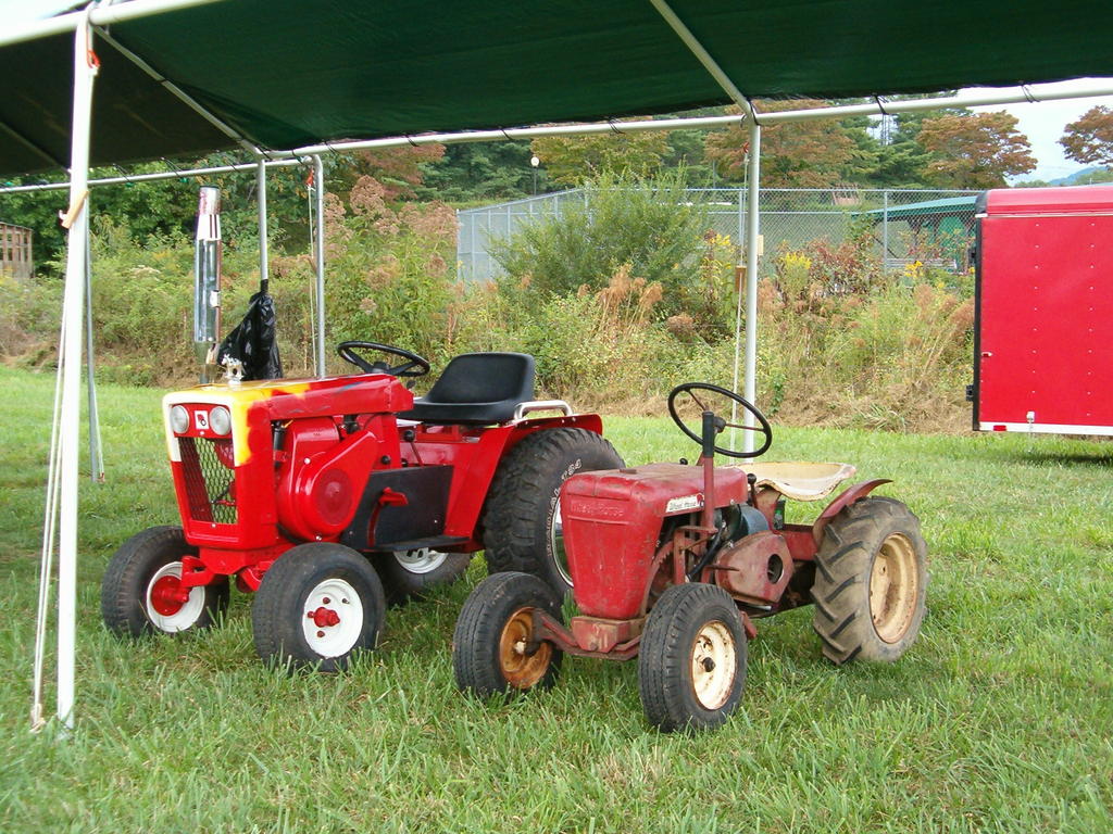

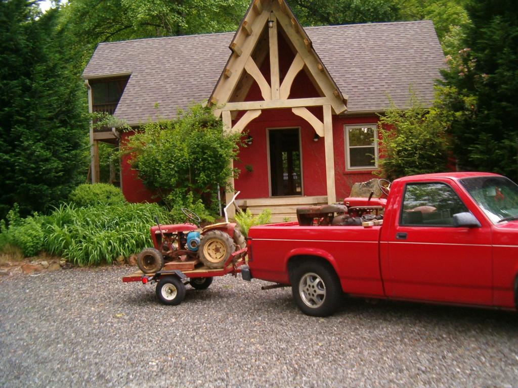

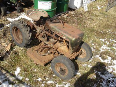

Just check my previous posts, I think they have all been there at one time or another. Here are a few.364.jpg.ffb50769bec93eacb7b7b6e00789d21e.jpg59decc31ef7b7_slevehitchlanscaperake.jpg.047aaa6b7814428557229a3772614728.jpg59decaef5cfc3_310001.JPG.c4d430d57e3e1619f18fed94db18ba00.JPG59decb6e9181d_953restoration002.JPG.d79017e18f540d7b4bdb0b9859e348f0.JPG59decb8d47406_418C001.JPG.bb0460af9647676e2b90ba0aa348baa1.JPG337.jpg.4dd5177566f4a5178edef9be8e5ebee0.jpg59decabf011ad_GT-14withFEL004.JPG.229920b9407589c9278856e7cc27e81b.JPG004.JPG.a1d2d34897408bed80288a656a5792a0.JPG125.JPG.2b47f1582a3eac65b366e3286ecca48d.JPG044.JPG.0a684b11ad0316283b17579fa253a4dc.JPG
The Suburban 400 has moved on to another owner. Couldn't find pictures of a couple,   :text-imsorry:
p38js
953 that is awesome still wondering why these little tractors are so addictive.  Once you get one it is like crack you can’t stop.  I have been waiting and watching for the right C-195 to come along I swear I have a problem.

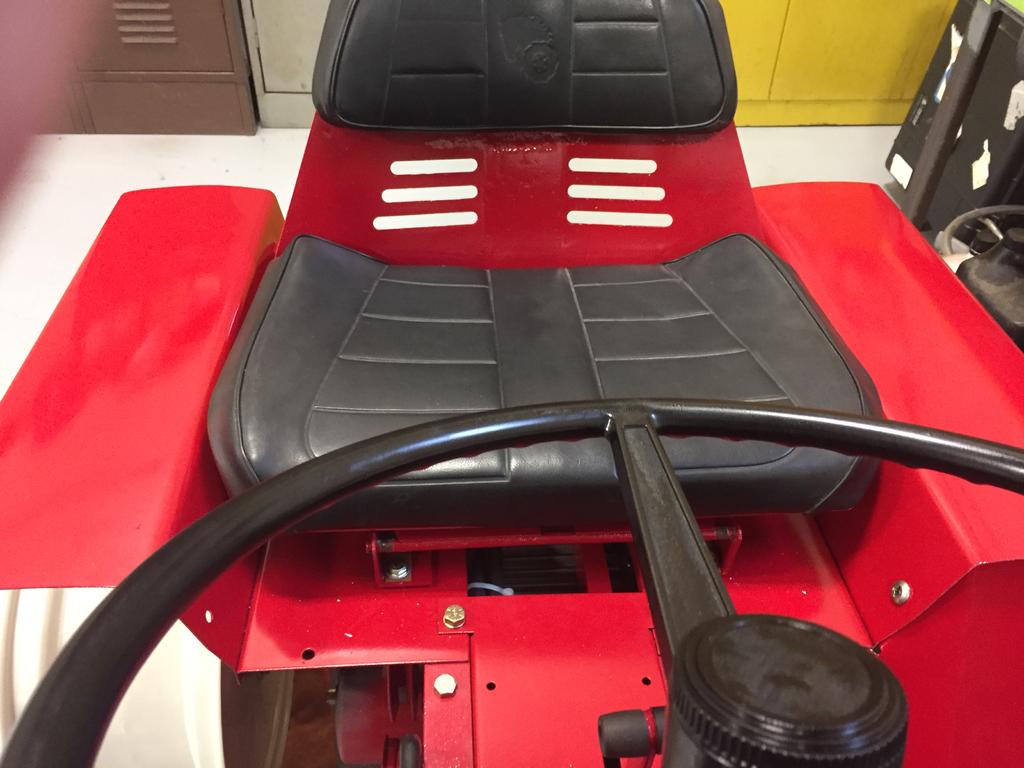

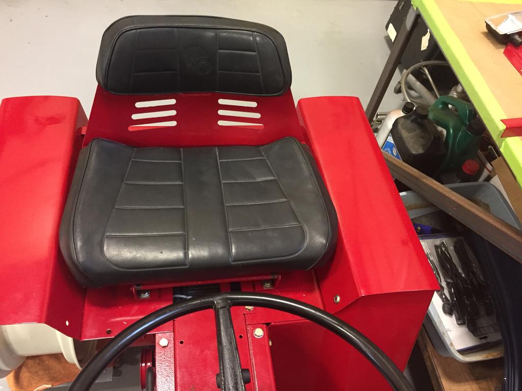

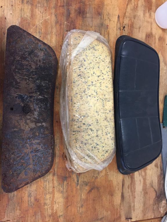

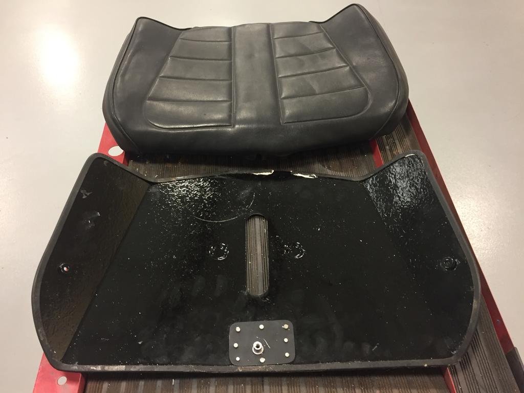

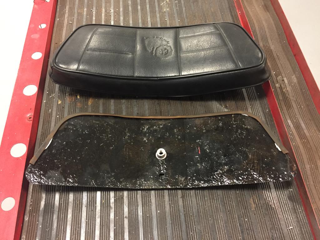

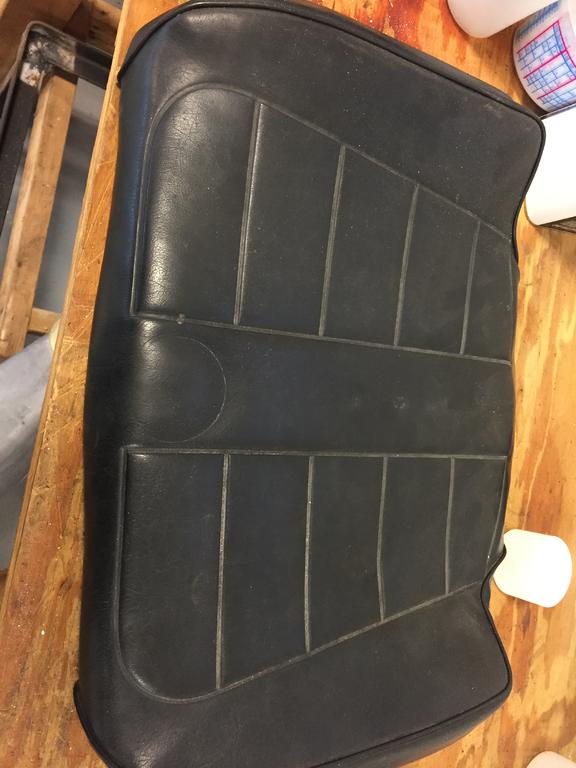

Did a little seat repair
  • Excellent 3
19richie66
Nice work!

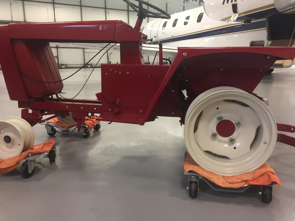

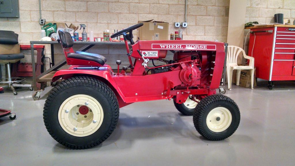

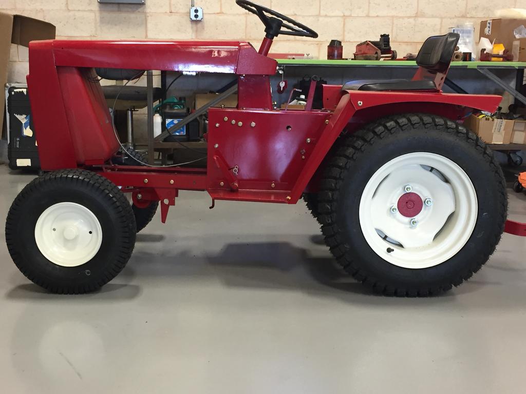

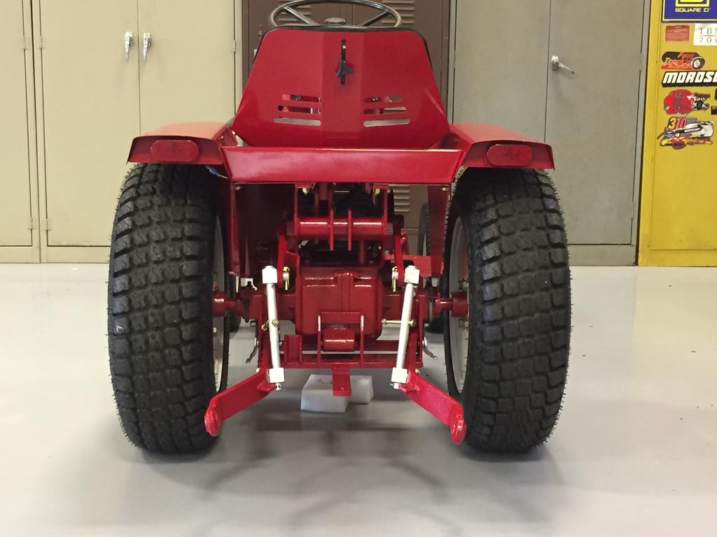

Nothing like a new pair of slippers,
Edited by p38js
  • Like 6
dells68
Those rear turfs look great.  Where did you get them and how bad is your bank account hurting?  My GT14 tires are crusty on both of my machines.
