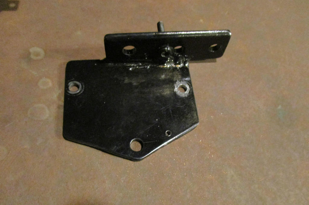

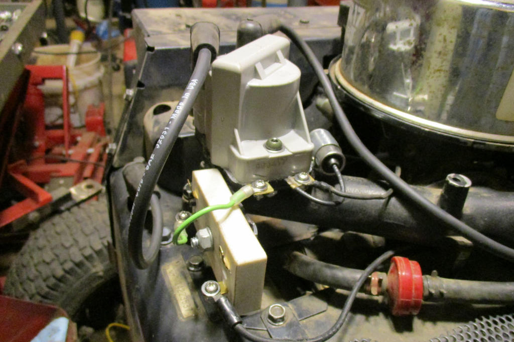

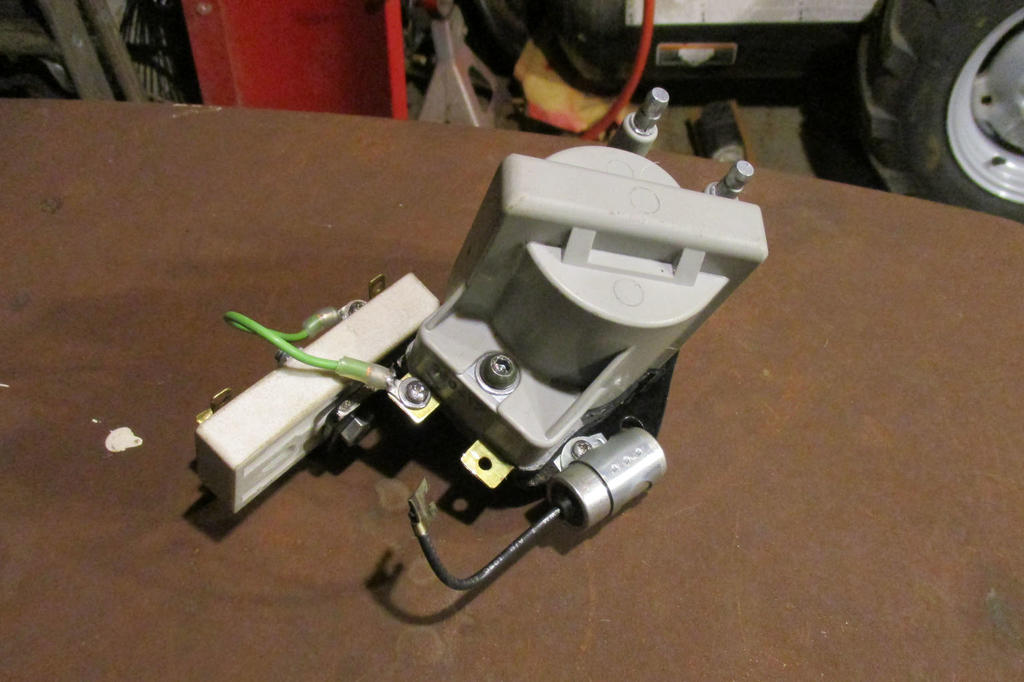

edgro 679 #12 Posted October 28, 2017 Got it running on both cylinders now. Here are some pics of GM coil install. I made a bracket to mount the new coil, condenser, and resistor to the original coil mounting location. I made an insulator out of 1/4 plastic for between the bottom of the coil and the bracket 2 Share this post Link to post Share on other sites
953 nut 57,403 #13 Posted October 28, 2017 1 hour ago, edgro said: running on both cylinders now. What was the GM coil used on as original equipment? Share this post Link to post Share on other sites
edgro 679 #14 Posted October 28, 2017 I got one that fit my car, just in case it didn't work on the tractor. 2003 Chevy Venture. They can be had for around $25 or so. 1 1 Share this post Link to post Share on other sites
953 nut 57,403 #15 Posted October 28, 2017 3 hours ago, edgro said: I got one that fit my car, just in case it didn't work on the tractor. 2003 Chevy Venture. They can be had for around $25 or so. I never would have given a late model coil pack a thought. I know that they are operated by a "Trigger" on the crank shaft and had no idea they could be hooked up to a set of points. Great information! Share this post Link to post Share on other sites
oldredrider 2,553 #16 Posted October 28, 2017 Gonna have to file this in my "must remember" brain. Great idea. And comparatively inexpensive too. Thanks. 1 Share this post Link to post Share on other sites
953 nut 57,403 #17 Posted October 28, 2017 Hope @Sparky Sparky-(Admin) or one of the other moderators can move this (post 12 & 14) to the instructional area for us. Great information and needs to be made easy to find again. http://www.wheelhorseforum.com/forum/142-instructional-threads-and-videos/ Share this post Link to post Share on other sites
edgro 679 #18 Posted October 30, 2017 I actually found this repair idea at: gardentractorpullingtips.com/ignition.htm lots of good ignition related information there also noted this page said to use two coil resistors, so I got one that had two resistors in one, but it would not fire when connected thru both of them. So it's connected to the one resistor, we will see how this works like this in the long run 1 Share this post Link to post Share on other sites

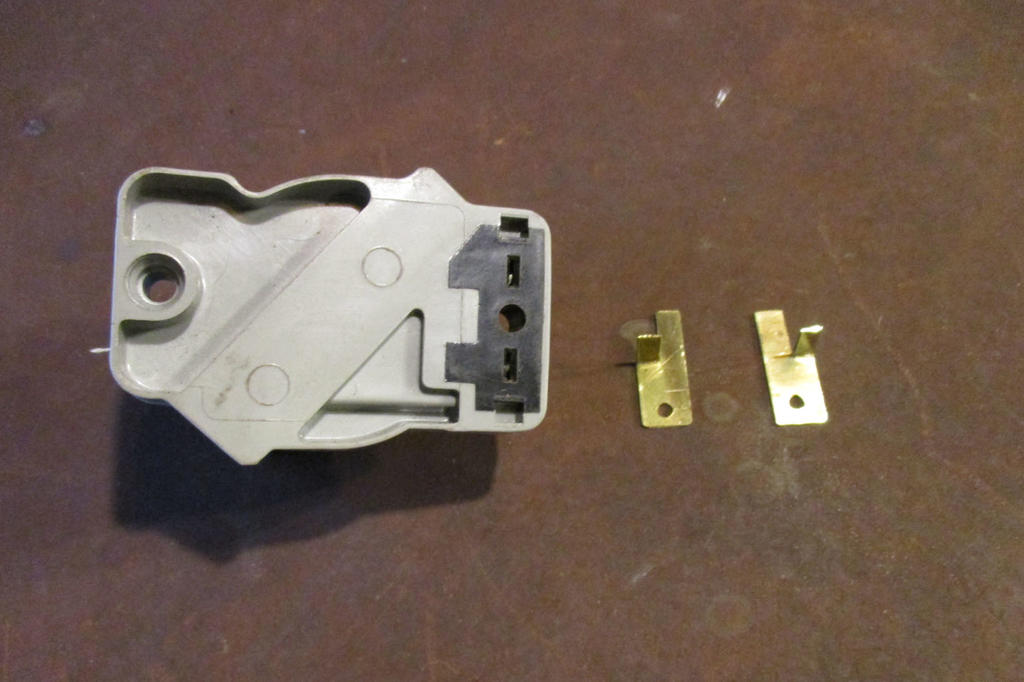

pacer 3,175 #21 Posted October 6, 2019 30 minutes ago, edgro said: ran bad, lots of popping and misfiring That pretty well describes my experience with the 2 auto coils. Would run without resistors but really poorly, with resistors ran ----- OK?? and back firing -- whoa!! til it warmed up, As mentioned when I finally got the proper coil it ran sooooo much more nicely! Share this post Link to post Share on other sites
edgro 679 #22 Posted October 7, 2019 agreed. it was very strange how this ran with no resistor. almost would have thought it was a fuel problem. I guess that shows how much ignition affects your overall performance. the last tractor I bought ran crappy, and a new condenser fixed it Share this post Link to post Share on other sites
