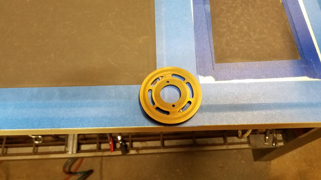

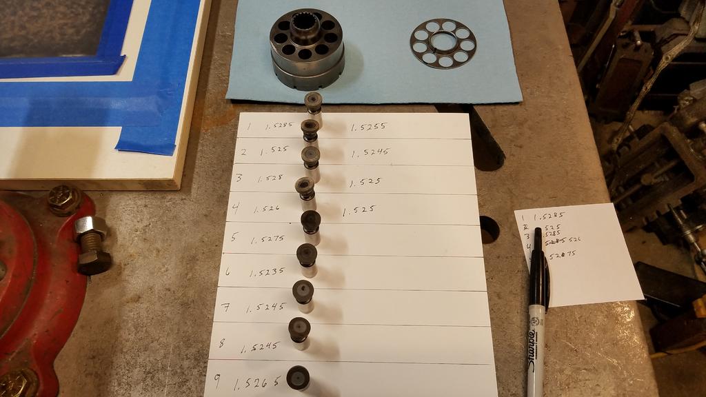

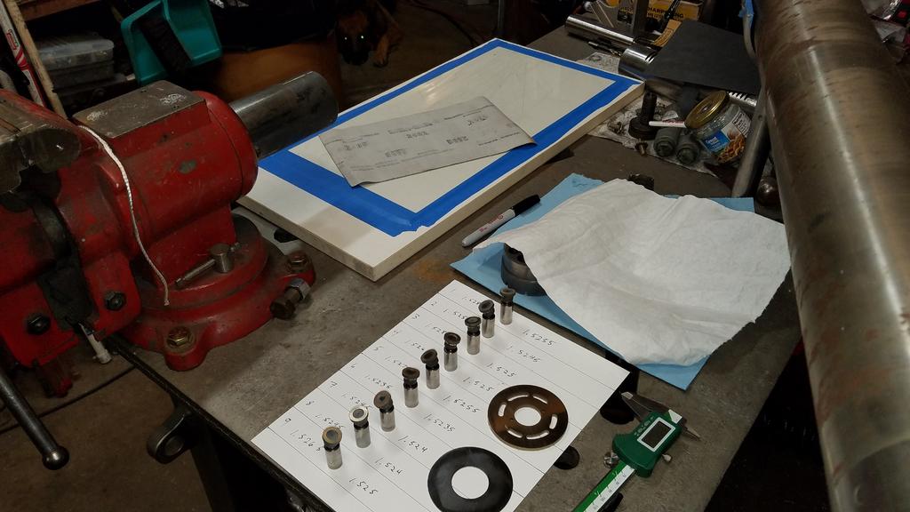

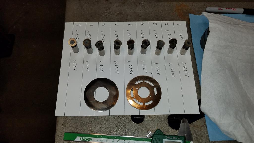

Spent some time yesterday afternoon working on the pump internals and getting everything surfaced and ready to reassemble . The pistons looked pretty good but measurements revealed a range greater than .002" - so they got surfaced down to within spec . Final finish is a 5 micron surfacing belt on a piece of glass . Valve plate was excellent and finished down to 6,000 Micro Mesh - I hate cutting bronze as it plugs everything up .
Valve plate prior to surfacing
After some hand work -

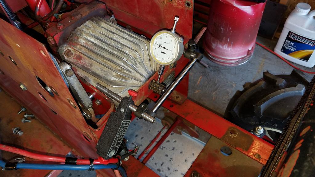

The timing light test didn't yield much for results , but a bit of adjustment on the engine mounting bolts did sharpen the image a bit - but it still leaked . Ripped back into it yesterday and set a personal record - 32 minutes and the engine was clear of the pump . Spent longer than that hunting the Mighty Mag for the indicator since i wanted to check for any bearing wear/slop in the main shaft - it was stuck to the lathe under the travel carriage , duh -
.0003" is all I could get for play in the shaft . There's probably that much along the length in the piston block and how it seats into rear bearing and charge pump . That measurement was taken after I couldn't hardly get a wiggle out of the .001" resolution indicator - so I used the finer test indicator . Seal was removed prior to measurements .
I did notice it looked like the seal's metal perimeter case was wet when removed - suspect the oil was just leaking past the case . Cleaned everything up and installed another new seal - no leaks so far . Stress testing begins later this morning with hauling some dirt fill and blade work - it's our official last good day of weather and hoping for the best . Next 3 days our high temps will change by 35*F - the wrong direction from what I'd like but it is December after all in Northern Illinois...ugh . Generally , if we're treated to days this warm we'll pay for it big later - snow predicted in late week and a lot of rain tomorrow , plus high winds again . Glad my buddy traded for a newer Kubota with cab - the D might not get much seat time this winter as a result .
