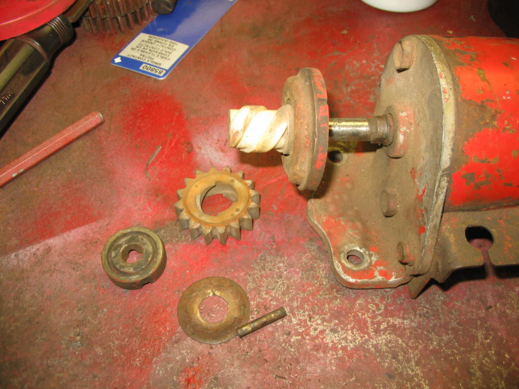

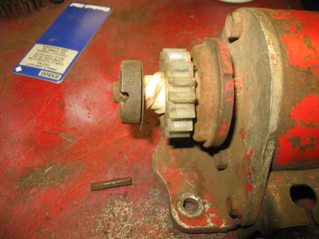

Is there a correct way round to fit 783 on to 513.

With ABSOLUTE amazement.... I was working on the exact same starter today... A briggs.  Talk about coincidence... Found o9ut that you can flip the 783 to put the worn side in..
I hasve 3 or 4 of  these in my shop...

No part No on the starter but the engine it is on is a B+Stratton 252707 0620-01, 8hp engine, the reason I am asking is I bought a new bendix gear (not genuine B+S) and it smashed up first time I used it, the company I bought it from are inferring I put it the wrong way round.

Spring is broken in this one.  I took it apart just to see if I can use the NYLON gear in others ...Yes.  Also to see if it would flip over...YES again.

 Normally you would expect there to be a hair spring between the gear and top plate to return it to the resting position, but not on this model, over here a new starter is about £50 I am not sure I would buy a second hand one.
If you turn the gear over in your picture is there a recess like there is in the retaining collar next to it?
