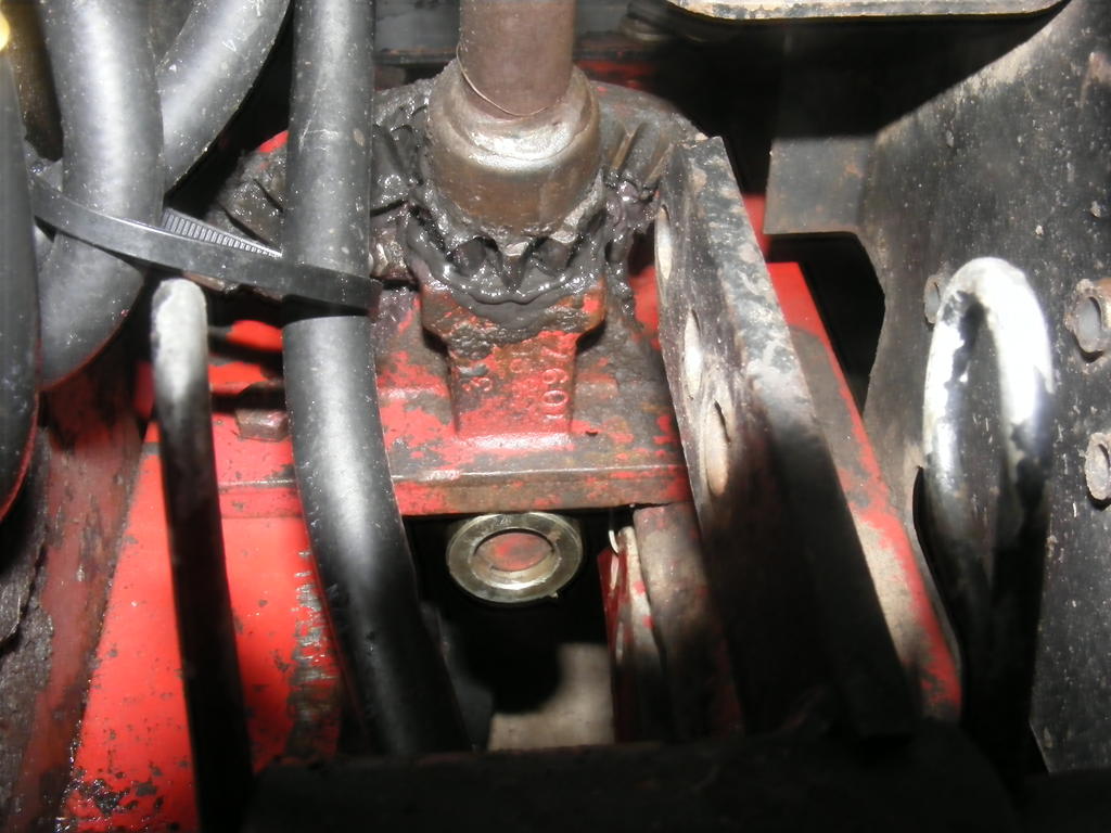

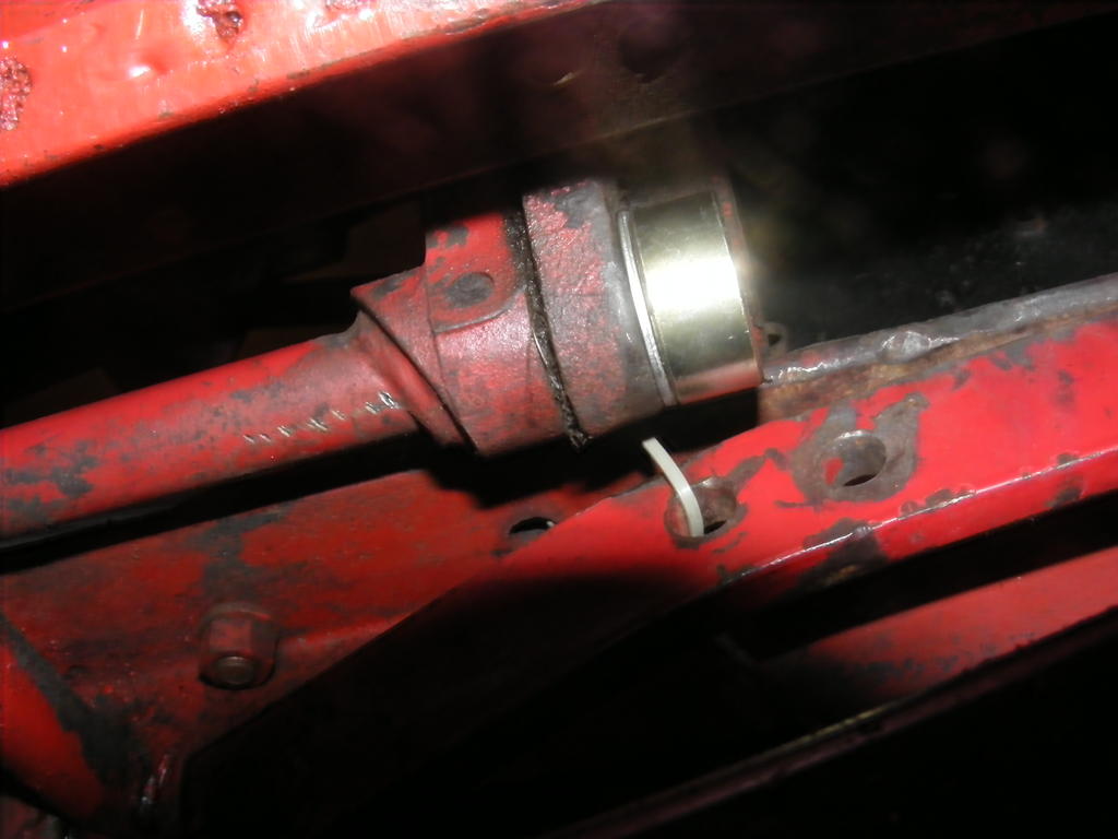

shallowwatersailor 3,214 #3 Posted October 1, 2017 Back when I owned my 1990 520-H, I had the same problem and the pictures show the old one while I was attempting to adjust it. That was the one year that had the swept front axle but not the steering reduction. The larger tires on the front probably added to the wear. It was only cured by replacing the steering block. A majority of original owners fail to grease this one zerk fitting due to the fact on some tractors it is really tucked away.and then the hole for the steering shaft gets wallowed out. Even though the steering shaft gear was worn, replacing the steering block was sufficient. Either drill the steering block to accept a sleeve bushing, or replace the block. Instead of using the cotter pin, I used a 3/4" locking collar with a set screw. I could never get the slack out by using the cotter pin. 2 1 Share this post Link to post Share on other sites
