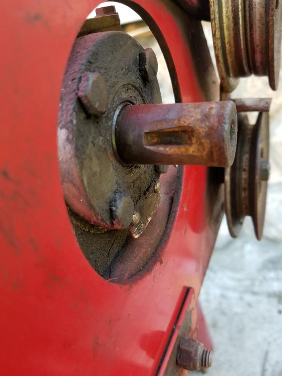

Last winter Noticed that the Drive Pully on the Blower was wabbling
This spring when I took the belt off I noticed that the Keyway on the spindle and pulley was worn.
The Key ways actually rounded
The set screw in the pully to spindle was missing.
So, what is the easy/cheap fix that will solve this issue
Thinking of mig welding the pulley to the spindle.
How Stupid is that idea?

WVHillbilly520H
I would try and find a new cutting/scraper edge unless you weld the new piece to the bottom there may be interference with the auger, as far as pulley and jack shaft, I would tear the gear box down and have a machine shop either make a new one or weld it up machine it to size and re-key it I would NOT weld the pulley to the shaft unless it was just long enough to finish out removal of blizzard, Jeff.

WVHillbilly520H
I'm cheap too but (fortunately) I'm a machinist and could do it myself, but as far as a rebuild kit for the gearbox I really have no idea, but on the flip side if there is not a lot of wear on that shaft a keyway could be cut 90°-180° from the original and with a new pulley with a set screw should fix that problem, Jeff.

roadapples
After removing the bearing, that keyway could be welded around a brass key like @Ed Kennell and others have done to axle shafts...
  • Like 2
Ed Kennell
Here is the post of the repair I made to an axle keyway.   However you decide to make the repair, I would also add a second set screw 90 degrees from the keyway.
Common size dive pulleys are available at TSC for about $20.
  • Like 1
