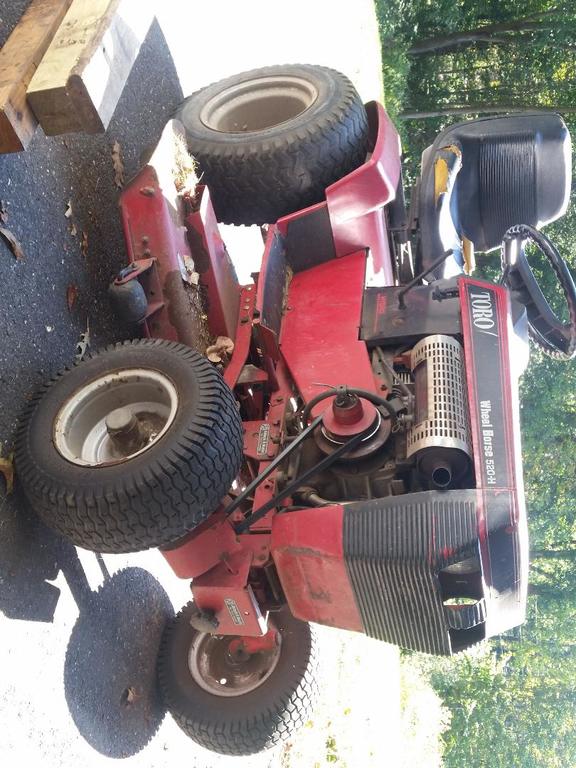

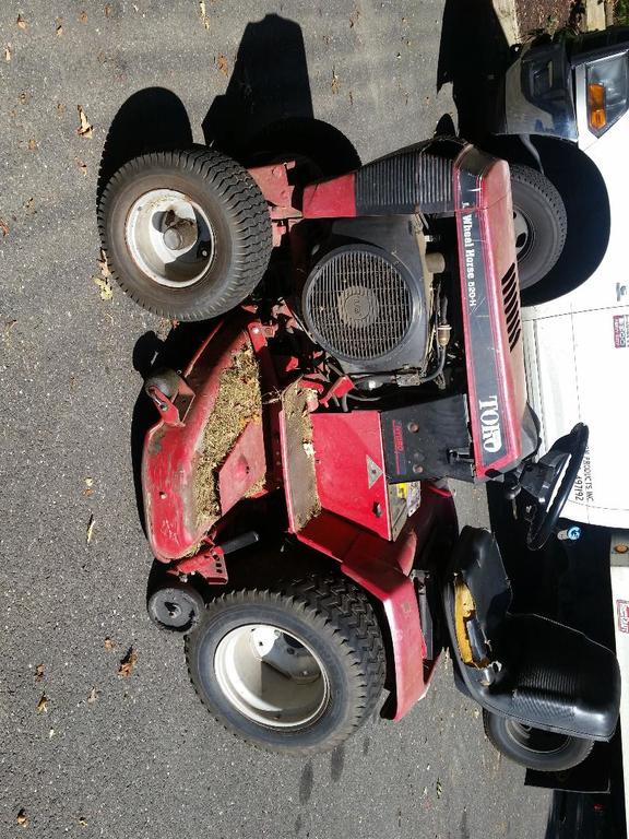

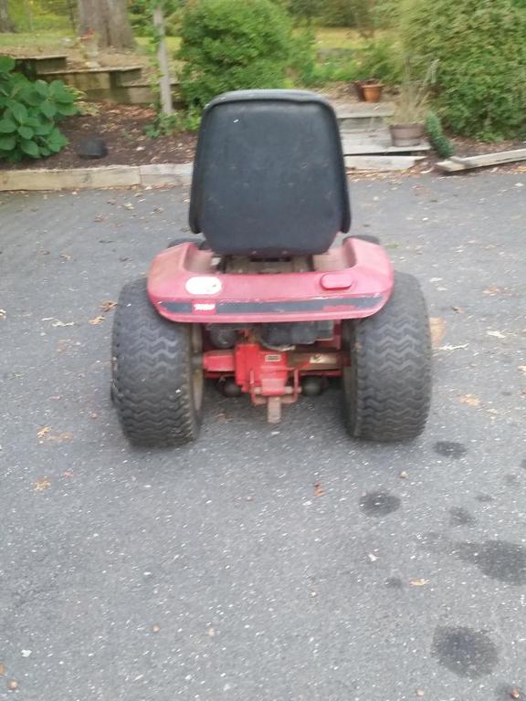

farmall450diesel 5 #7 Posted September 24, 2017 Thank you for the replies. I have attached some pictures of the tractor that I bought. A little history on this. I bought it at an auction and this machine came from an upstate NY prison and I paid $320.00. The hour meter reads 12xx hours. It is rough but it starts and runs fine, seems to cut great without any smoke and the hydraulics work as they should. Cosmetically it can use a paint job. Can you tell from the pictures what type of front axle this one has. I can get more pictures if needed. I'm still hoping to get a 60" deck. Share this post Link to post Share on other sites
Ed Kennell 40,217 #8 Posted September 24, 2017 Motion control on the steering column means it is 1990 or later which also means it should have the forward swept axle. 1 Share this post Link to post Share on other sites

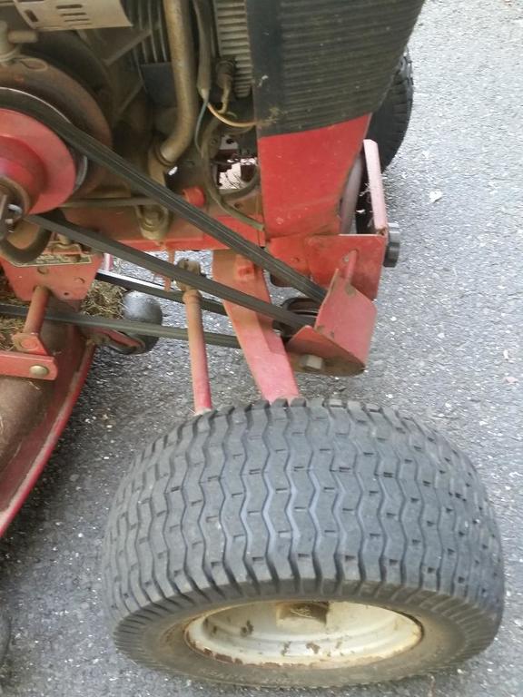

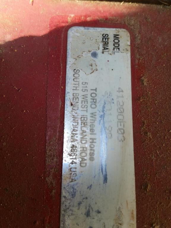

farmall450diesel 5 #9 Posted September 24, 2017 Sorry for all the questions. I attached two pictures, one is the front axle, is this a forward swept axle? I also attached a picture of the ID plate. The serial number is going to be a challenge. The tractor has a 48" deck now. Any thoughts on the HC deck with the wheels mounted on the front? I would think it is a better deck compared to the standard deck. I would like to find a two stage snow blower if anybody knows of one. Eric Share this post Link to post Share on other sites
WVHillbilly520H 10,376 #10 Posted September 24, 2017 (edited) It's the forward swept front axle but with 1200+ hrs I would still be leary of twisting a 60" deck, but that's not my decision, that 48" is plenty deck if you have 2 acres or less to mow, just my 2¢ for owning one since new in '98, good luck with your new ,Jeff. also the belt is in the wrong pulley on the engine PTO should be in the back one, the front where it is now is for the snow blower. Edited September 24, 2017 by WVHillbilly520H 1 Share this post Link to post Share on other sites

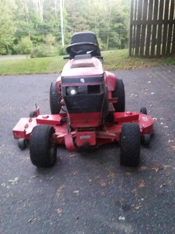

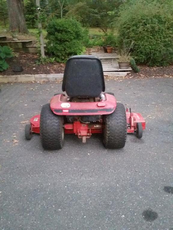

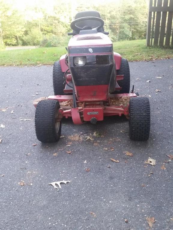

farmall450diesel 5 #17 Posted September 29, 2017 (edited) Here is an update. I bought and installed a 60" deck and used it today, I'm so glad I upgraded. I am happy that I found a deck with wheels on the front of the deck. I attached some pictures of the before and after. I do have a question, when I lift the deck it seems like it's not going up level. The front of the deck s higher then the rear, It's not level. I had the same thing happen on the 48" deck that came with the tractor. Any idea's. Now I need to replace the hood assembly. Eric Edited September 29, 2017 by farmall450diesel Share this post Link to post Share on other sites
