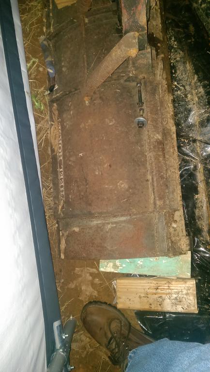

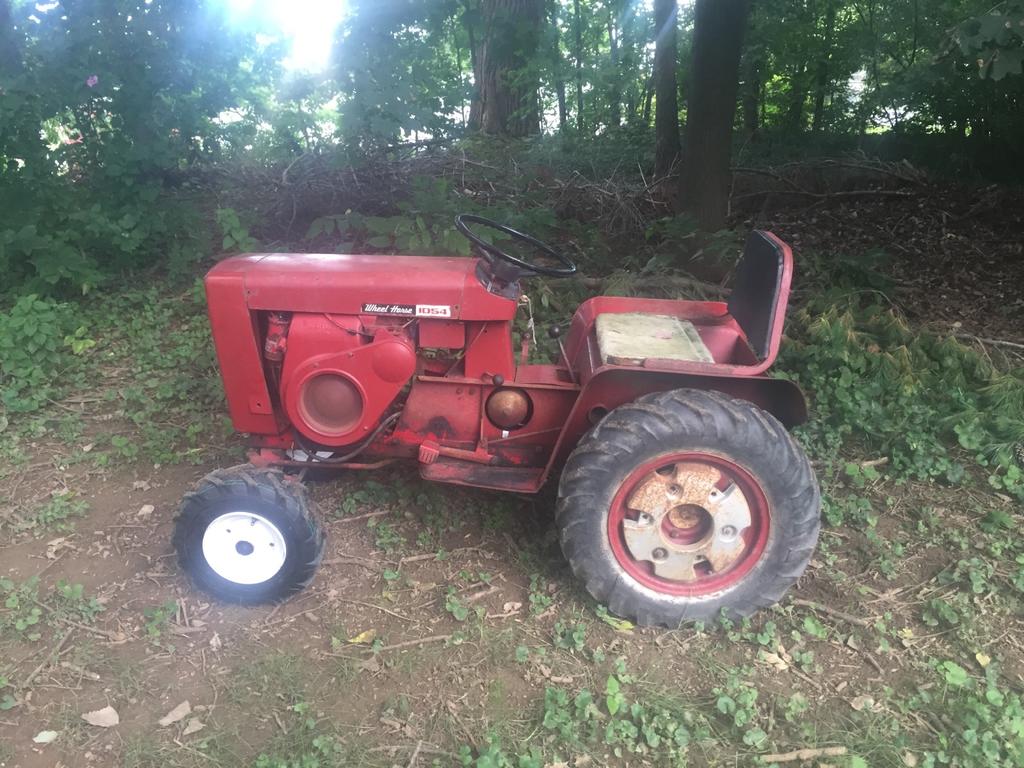

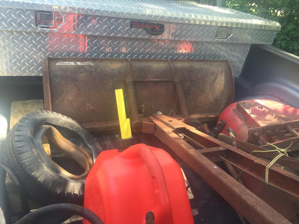

 Did any of you try widening a Snow/ Dirt Blade, mine looks like a toy behind the 1054 ? Id like to try putting 2 together ? 60 inch wide, mainly for the snow, You Wheel Horse rs have any idea's ? Id like to hear it, BRFIMG_03831.jpg.f649192cd3f15ecfe1310fb91b2b5757.jpgIMG_03931.jpg.6870f559bb73d30740c5808d633e011a.jpg

Find you "D" series moldboard they're 56" wide, Duke has/had a NOS one for sale in the classifieds, and yes I widened a 42" to 50" for my 520H ain't pretty but got the job done, Jeff.

@WVHillbilly520H,  i thought so, i'm gonna grab a 42 & go 60, hey what the heck right, LOL, Keep watchn, im posting the new addition this weekend, D200, that will push the snow Driver LOL

I had an old push blade that was bent quite a bit, so I cut 6" off of each side of the bent blade and welded the pieces to a 42" blade, making a 54" blade for my GT-14. It worked very well. And no I don't have any photos available because of the Photobucket deal!
