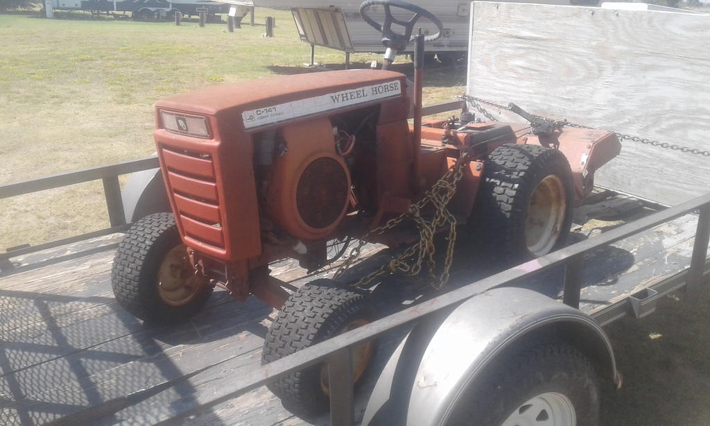

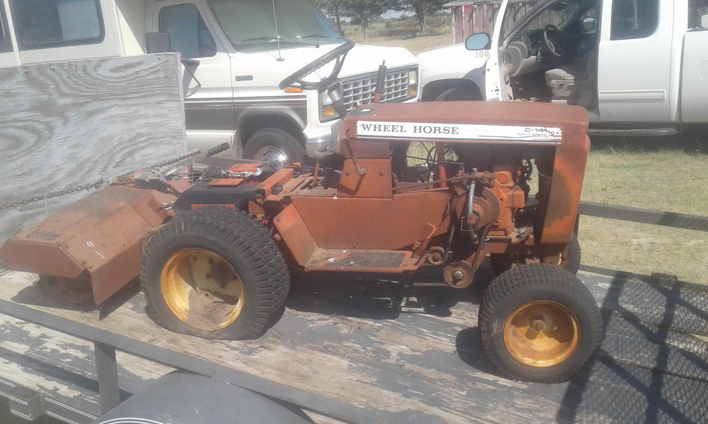

I'll try that and see what happens to at least get it moving on its own if possible, but eventually will probably tear into it for a rebuild...due to the special factor of this particular  tractor it will end up with a full no expense spared restoration...may take several years but we will eventually get there.

The RF tire will still hold a bit of air...the LF is shot it's completely flat and has huge splits in the sidewall...but no big deal there iv e got an extra set of four tires on rims that will hold air I can at least put on it to make it easier to roll around

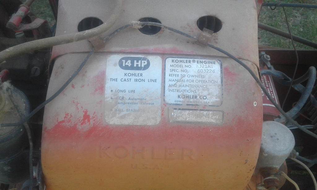

      Ii have a C141, It's my favorite Tractor. His name is Wilbur.
      Two months ago Wilbur's original muffler came off. It has rusted away into two or three pieces. I fashioned a stack-type muffler from an off-the shelf muffler from TSC. With a few elbows of black pipe, a clamp, and some pipe wrenches, I got him together. And ran great. He was very happy as I set him out to pasture and he grazed upon the three acres.
      Last week while mowing, Wilbur lost power rapidly. White smoke, sounds of 'missing', and running very roughly. I've no idea what the issue was, so I quickly got him back to the garage. And I left him. Unsure of what to do, I decided, due to limited funds, to find an engine, swap, and then later get the 14hp engine running. I'm about to hopefully gain a C160.
      Will there be any issues putting this 16hp engine into Wilbur?
      Thanks for reading.
