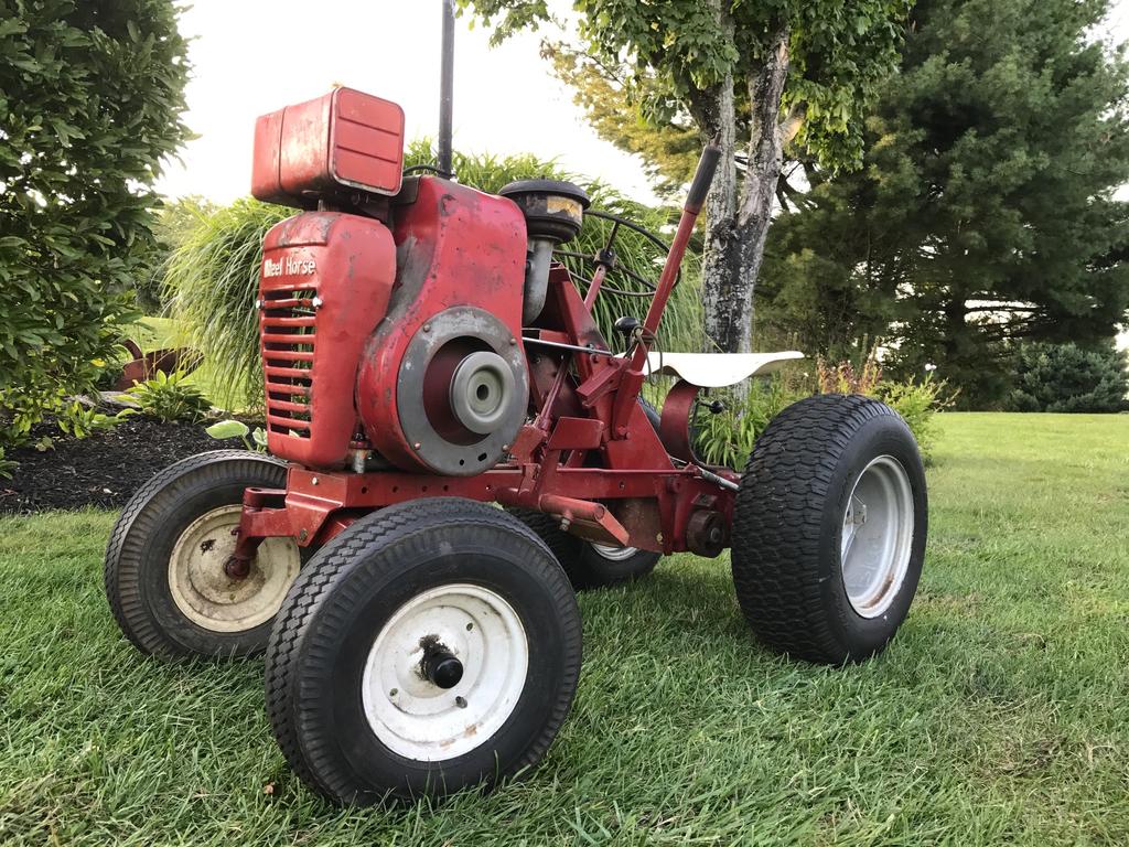

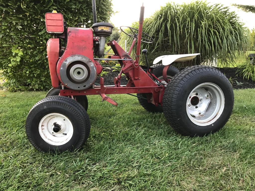

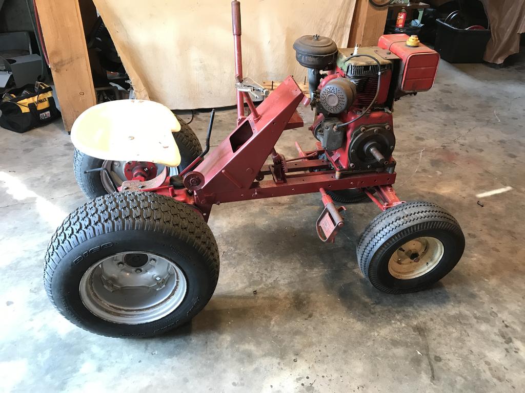

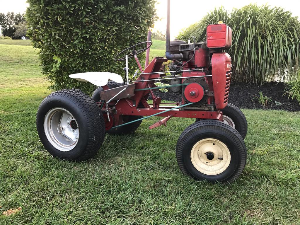

stevebo-(Moderator) 8,363 #1 Posted September 12, 2017 Another member here had a complete 704 frame that was cleaned up in the past and painted. I thought I have an 8 speed and a great running yank start Wisconsin I wanted to mount to something. Jay Paxton member here stepped up and offered a donor hood to me for free! Thanks Jay. I plan on relocating the tank and add wheelie bars. Here it is so far.. 10 5 Share this post Link to post Share on other sites
953 nut 56,164 #2 Posted September 12, 2017 That Wisconsin should provide plenty of nose weight. I think you probably need to add a piece of angle iron under the bottom of the drive belt to allow the clutch to work better. 5 Share this post Link to post Share on other sites
stevebo-(Moderator) 8,363 #3 Posted September 12, 2017 2 minutes ago, 953 nut said: That Wisconsin should provide plenty of nose weight. I think you probably need to add a piece of angle iron under the bottom of the drive belt to allow the clutch to work better. I have a retainer on the front of the drive pulley and one on the idler pulley but yes I plan on adding something else up front around the drive pulley. 3 1 Share this post Link to post Share on other sites

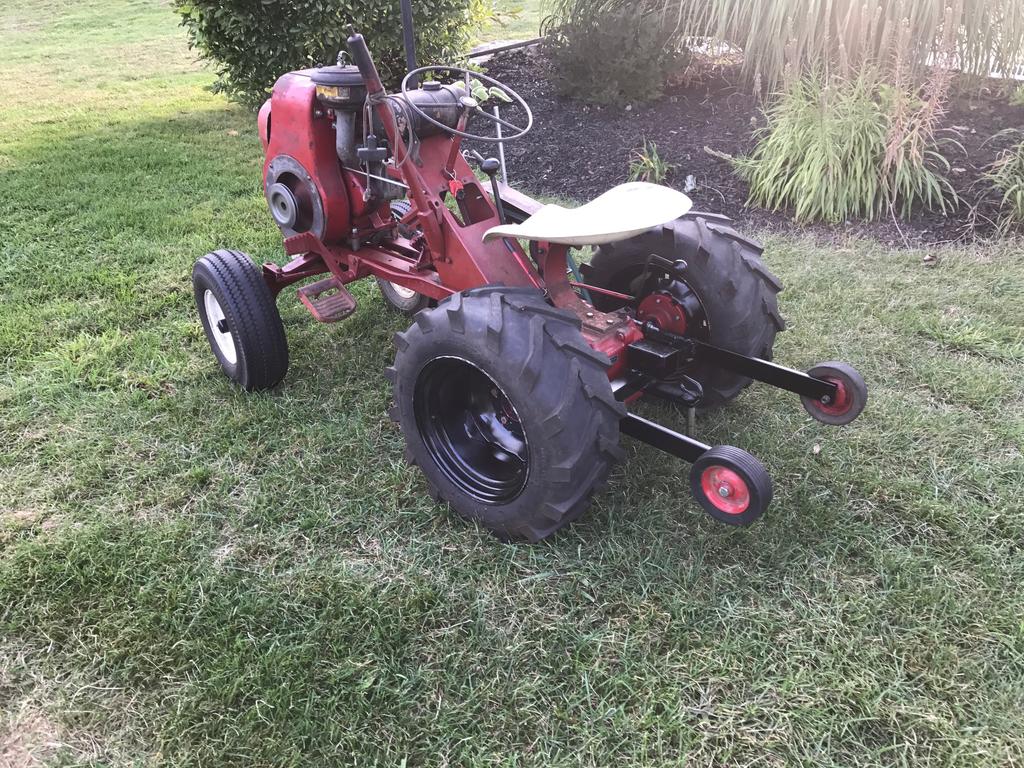

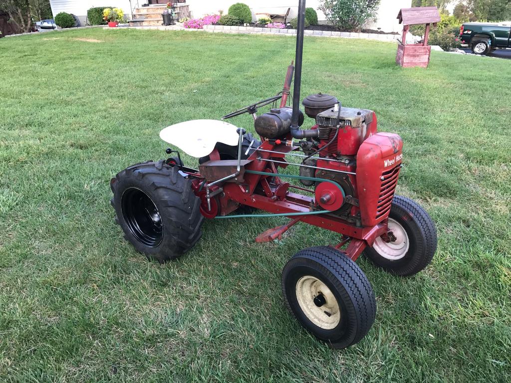

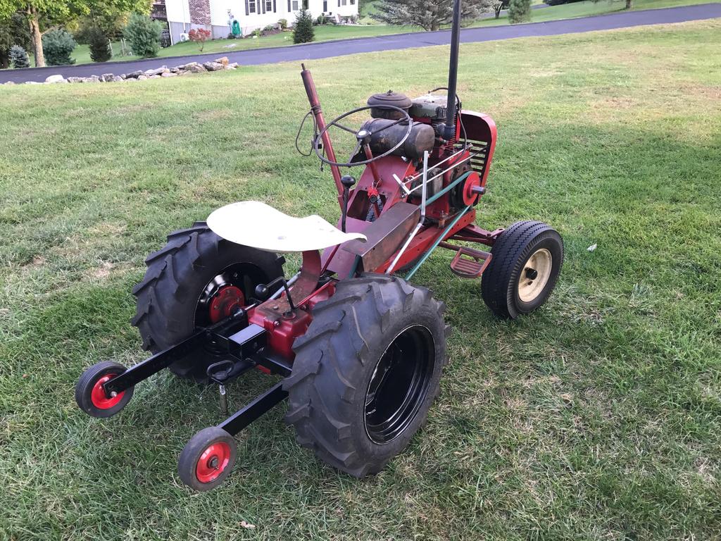

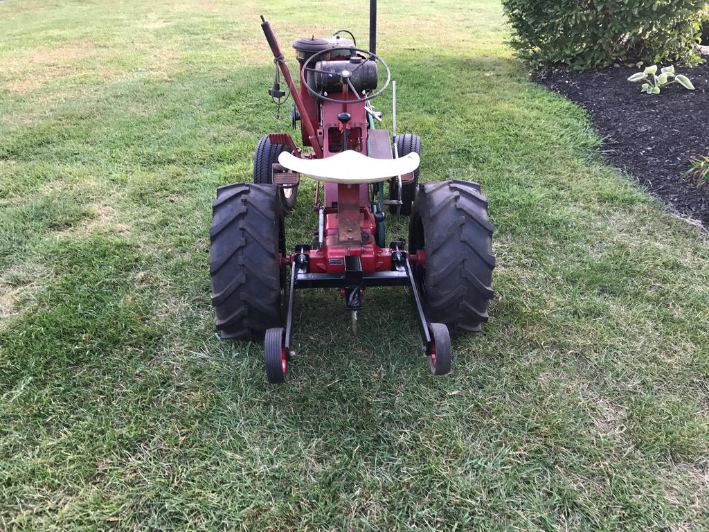

stevebo-(Moderator) 8,363 #6 Posted September 12, 2017 Found a set of carlise ags on craigslist and picked them up really cheap ($30). Put them on and gave the rear rims a quick coat of semi gloss black. Need to finish the wheel paint. Also added the wheelie bars out back and added a drawbar so I can pull a trailer. I hate to cut these machines but I did on the dash tower to fit the gas tank there. I will keep the section I cut so it can be added back with some welding. Coming along nice I think. I decided to soak the carb to be sure it is nice and clean. 5 3 Share this post Link to post Share on other sites

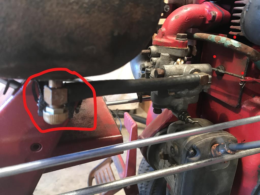

stevebo-(Moderator) 8,363 #7 Posted September 14, 2017 If there are any Wisconsin engine experts (anel) model I believe (9.2hp) there is one mixture setting for idle and only a plug where the high mixture should be. I pulled carb and cleaned it good (looks to have had a recent rebuild) and there is a jet on the bottom of the carb bowl but no needle only the plug. I looked up the diagram on line and some carbs have a high speed needle there and some have the plug. Any help would be great. Issue is that it runs rough at throttle up and anytime running higher rpm and tractor shakes it breaks up. Thoughts? Share this post Link to post Share on other sites
Ken B 3,164 #8 Posted September 14, 2017 Looks pretty cool. I was hoping you were gonna relocate the fuel tank, looks much better now. I'm not a Wisconsin expert but I can help you in naming this new tractor... "Shake-n-Break" 2 1 Share this post Link to post Share on other sites
953 nut 56,164 #9 Posted September 14, 2017 9 hours ago, stevebo said: runs rough at throttle up and anytime running higher rpm and tractor shakes it breaks up. Thoughts? Did it do this with the original tank on it? The new tank being lower may not have enough fuel pressure, might need a fuel pump. Share this post Link to post Share on other sites
stevebo-(Moderator) 8,363 #10 Posted September 14, 2017 I ordered a new elbow style screw in fuel shut off with the screen strainer. Once I get that I will remove the in line one and in line shut off. In line may be restrictive but not sure. Yes did it in both tank locations but more in this location now. 1 Share this post Link to post Share on other sites

stevebo-(Moderator) 8,363 #15 Posted September 16, 2017 I got a good nos screw in fuel shut off with strainer. I removed the in line shut off and filter. Also added a high speed needle I have and she is right now. 3 1 Share this post Link to post Share on other sites
