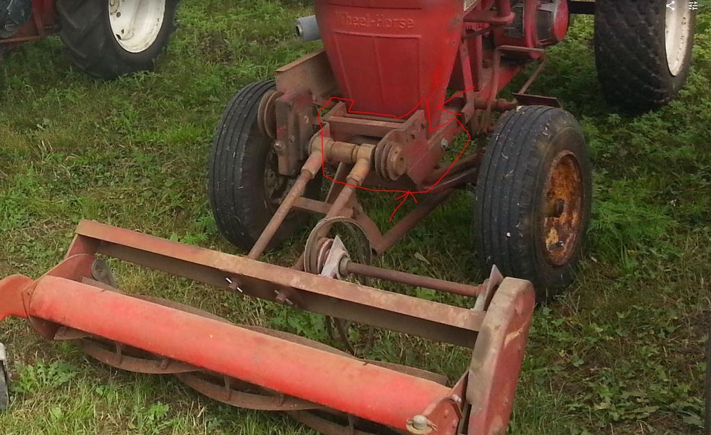

The reel itself is the same I think... just the mounting and maybe the lifting are different. To run that you'll need the extra mounting bracket that fits the front of the suburban and maybe a different lift rod. (I think? Never tried to mount this one to anything but the 'burb it came on!) Maybe that lift rod is long enough if you think about the few inches farther back it is mounted to a taller tractor frame. :scratchead:
Here's a picture of mine mounted up. I've lightly circled the bracket you need. Essentially that raises it up to about the same mounting height that would have been on the 62 tractor. I actually currently have this mounted up and could get more pictures tonight if you want some.
