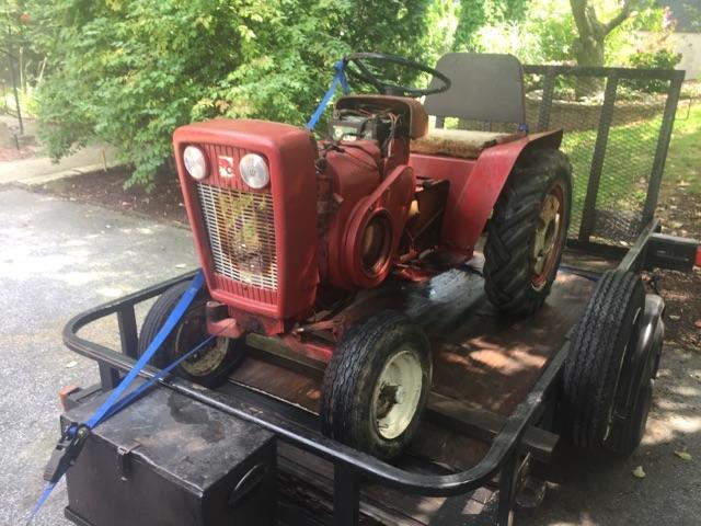

Big_Red_Fred 1,547 #1 Posted September 3, 2017 Is it possible to take a 520 Plow & frame and connect it to my 1054 for winter ? will the rear plow holder they sell on Ebay that bolts to rear diff work or must i construct a different set up ? Share this post Link to post Share on other sites
