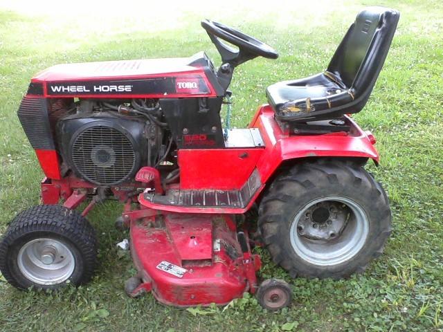

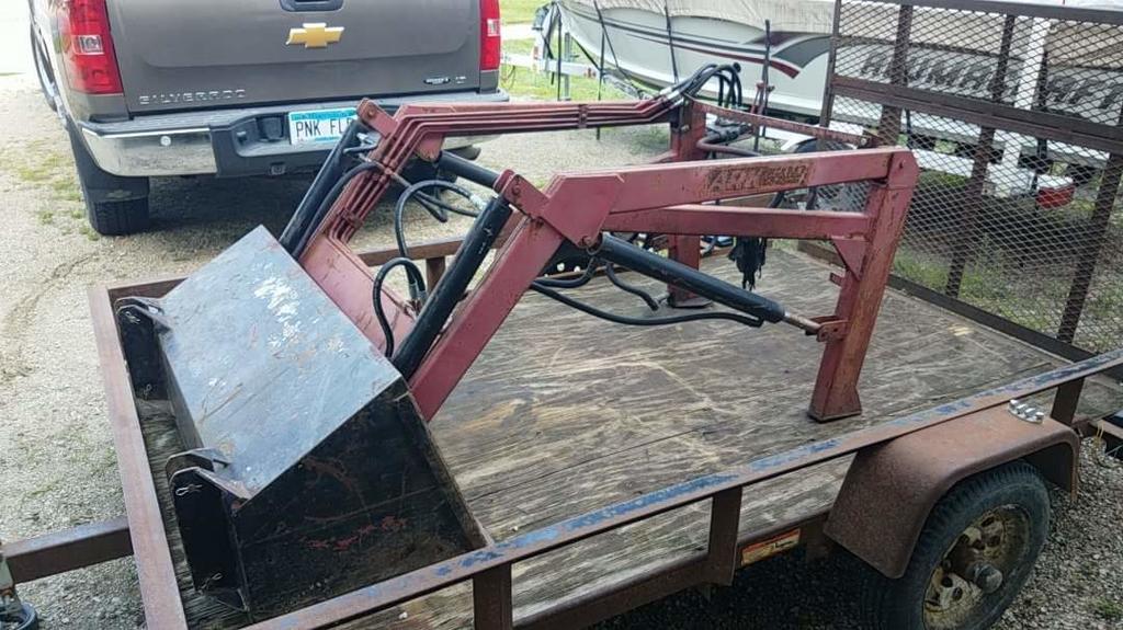

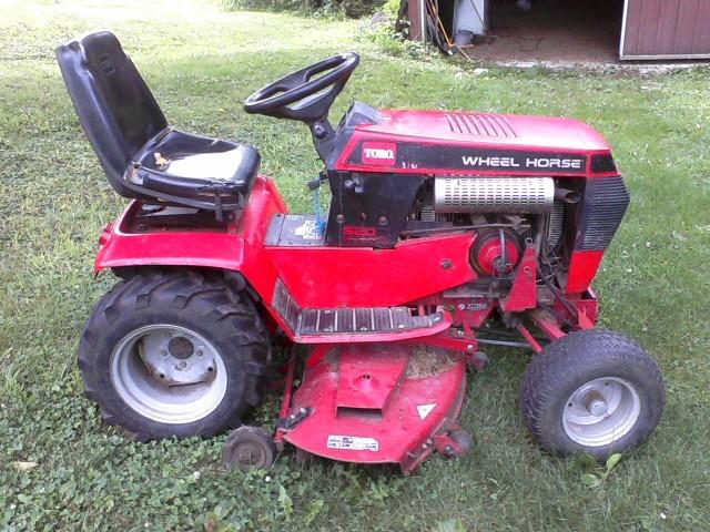

Shynon 7,470 #1 Posted September 3, 2017 (edited) I picked up my second 520 awhile back from @DeterminingFactor that had no spark. Changed out the 9 pin connector from @rmaynard as the red wire was already routed around the 9 pin. Found the coil was bad and replaced. Motor runs good and now on to the next step. PO said hydro was leaking I think I found the problem so tomorrow I will open up the hydro and replace all seals and gaskets. Plan on wet sanding all the tins and repaint, new decals will need to be ordered. Now if I could only convince @ACman to release the rights to the wheel a matic decals, other wise it may end up being the patriotic series decals. This one may take a while as still working 10hr days and Saturdays. I'll try to post as much as I can. Also picked up an Ark loader for it. Need to build subframe, new hoses and modify a few other things Edited September 3, 2017 by Shynon Add pics 14 2 Share this post Link to post Share on other sites

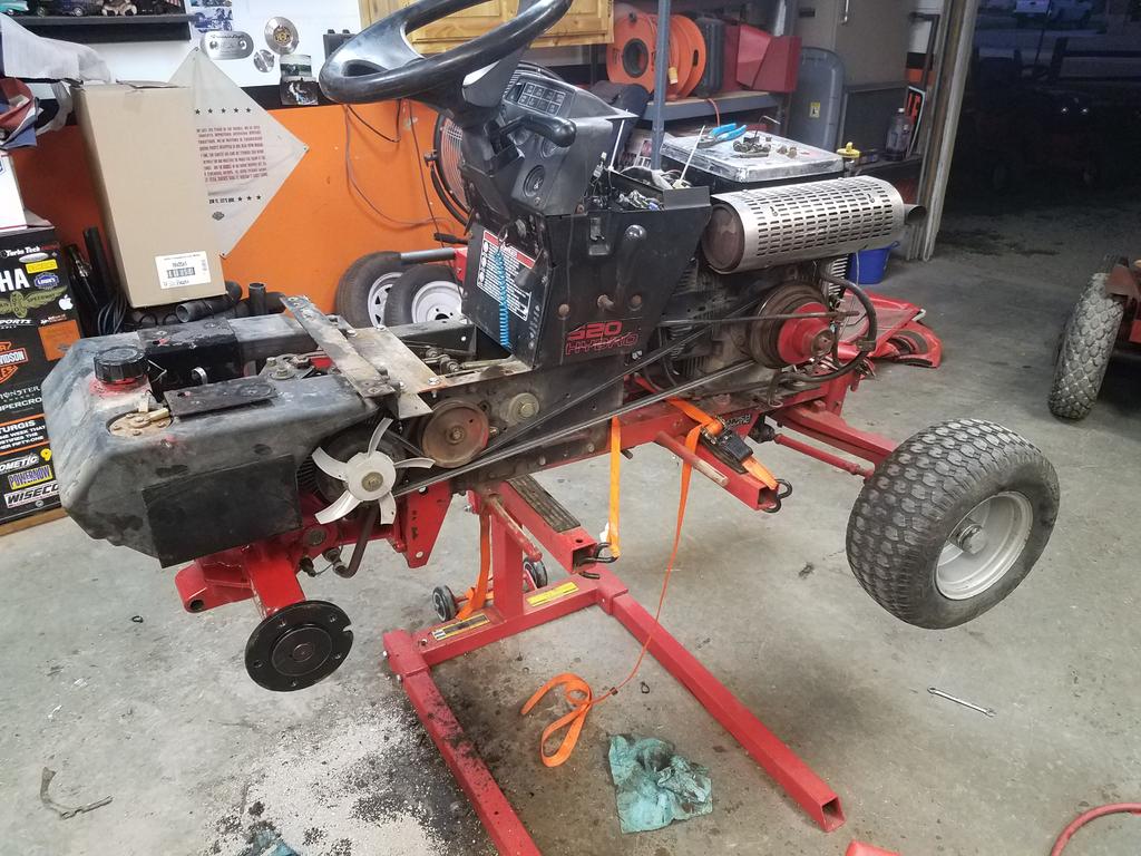

Shynon 7,470 #6 Posted September 11, 2017 Had some time this week to open up the differential and fix the leak, put in new seals. Thought I would wet sand the tins, but no had to blast some of them. Put some primer on may paint later this week. Need to get with @Vinylguy and get some decals ordered. 6 Share this post Link to post Share on other sites

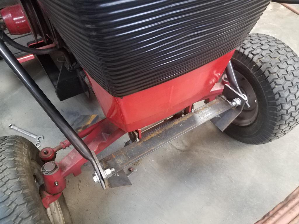

Shynon 7,470 #7 Posted November 18, 2017 (edited) Got the differential back together, painted the tins. Now on to the loader. Edited November 18, 2017 by Shynon 7 1 Share this post Link to post Share on other sites

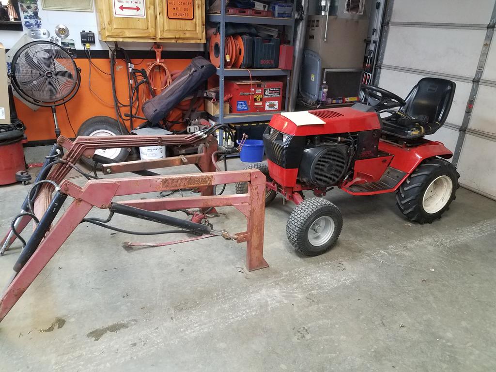

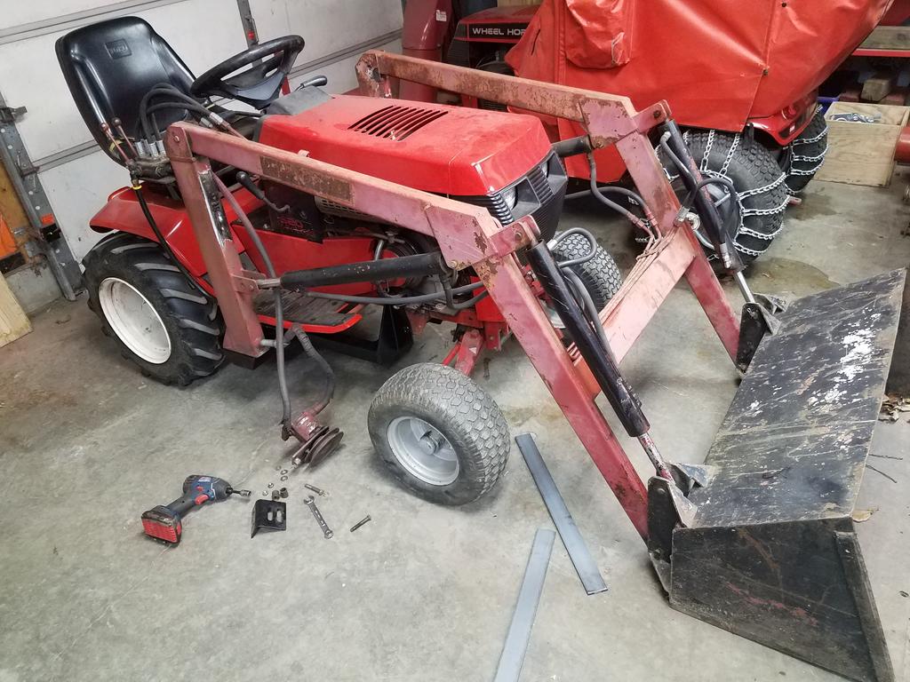

Shynon 7,470 #9 Posted November 25, 2017 Well got everything pulled out for the loader install. And this is were I left it as I am spending a few days in bed under the covers 1 2 Share this post Link to post Share on other sites
953 nut 56,164 #10 Posted November 25, 2017 16 minutes ago, Shynon said: spending a few days in bed 5 1 Share this post Link to post Share on other sites

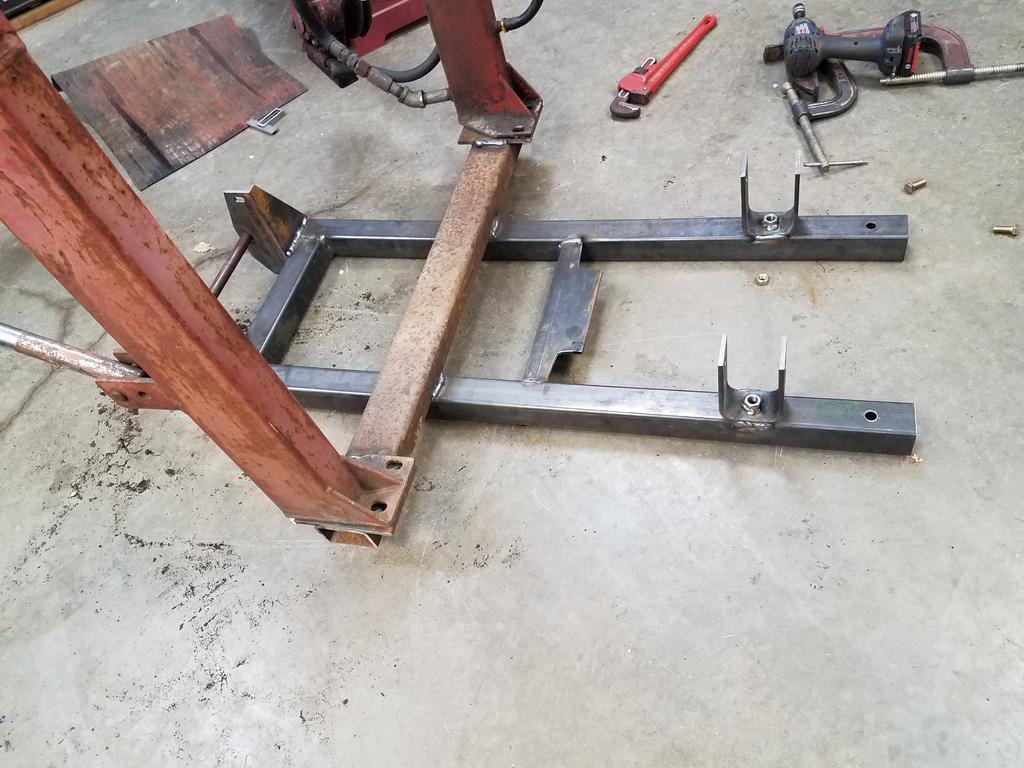

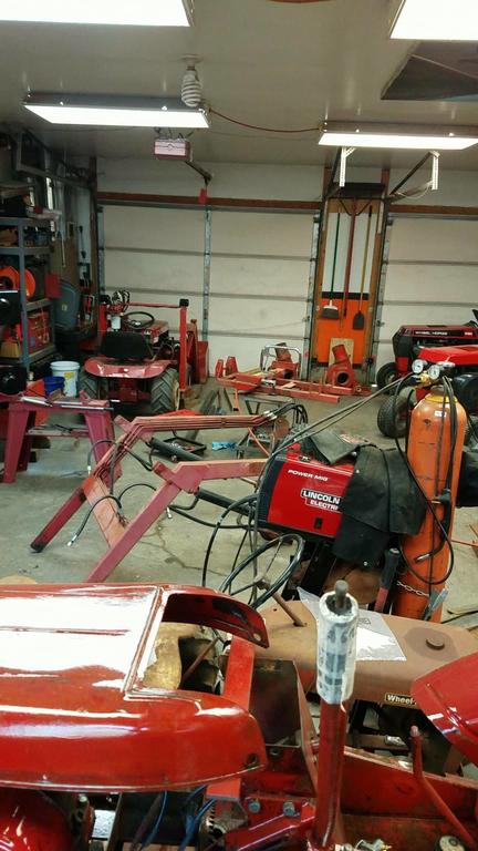

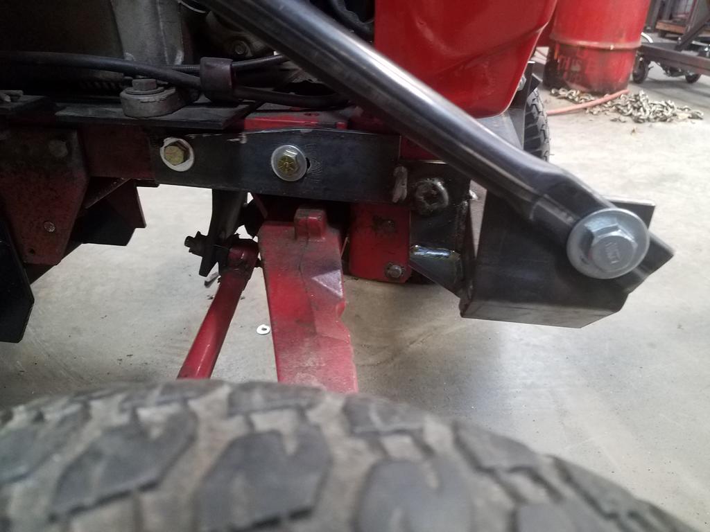

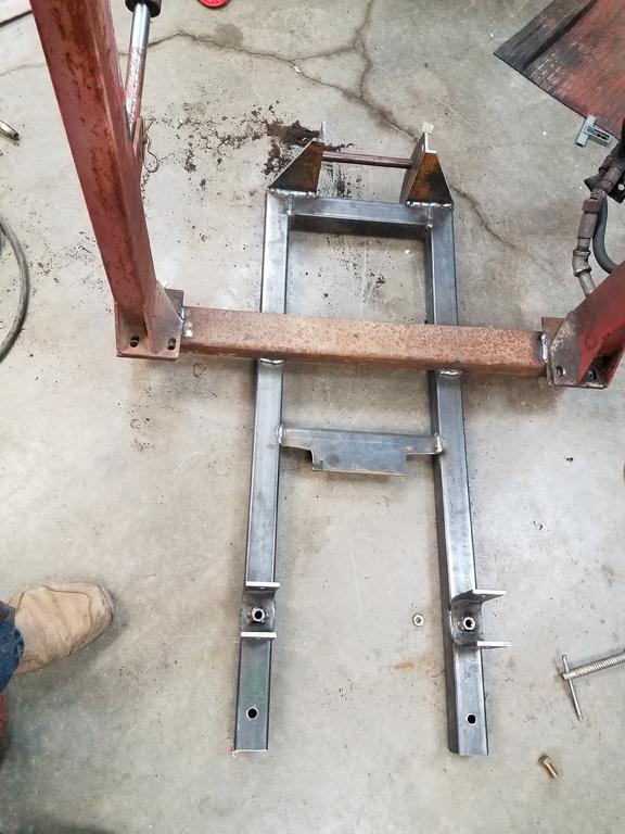

Shynon 7,470 #11 Posted November 28, 2017 Got back to it today, subframe almost done. Pretty much an exact copy of a Wheel Horse subframe. 3 6 Share this post Link to post Share on other sites
dclarke 4,046 #12 Posted November 28, 2017 Nice work, Tom! 1 1 Share this post Link to post Share on other sites
R. L. Addison 299 #13 Posted November 29, 2017 Do not understand all I see, but I will keep watching to see if the light comes on. 1 Share this post Link to post Share on other sites
WHX?? 49,486 #14 Posted November 29, 2017 Real nice work Tom ...like that rear rubber 1 1 Share this post Link to post Share on other sites

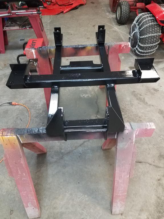

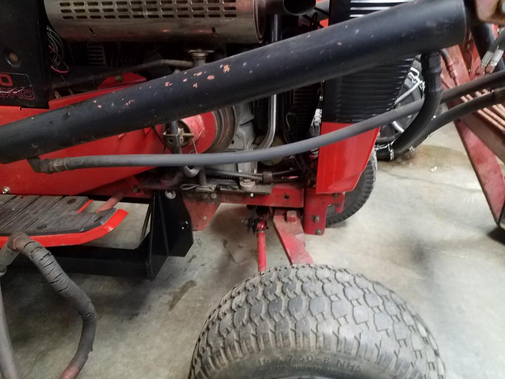

Shynon 7,470 #15 Posted December 9, 2017 Subframe completed, waiting for paint to dry 8 1 Share this post Link to post Share on other sites

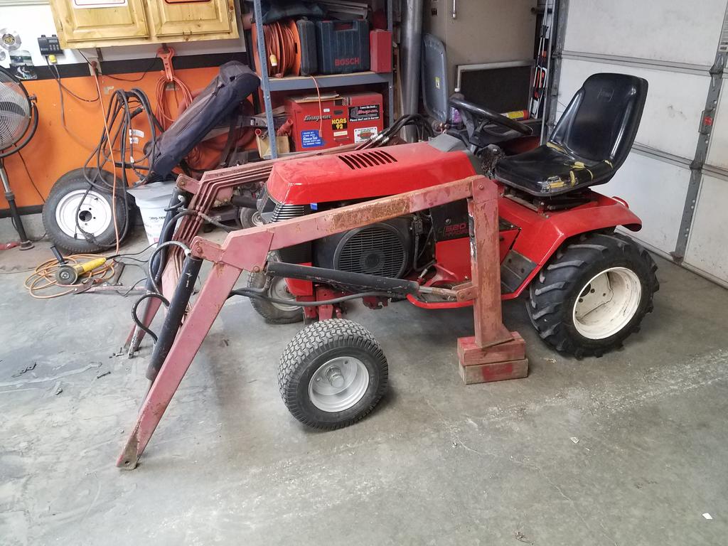

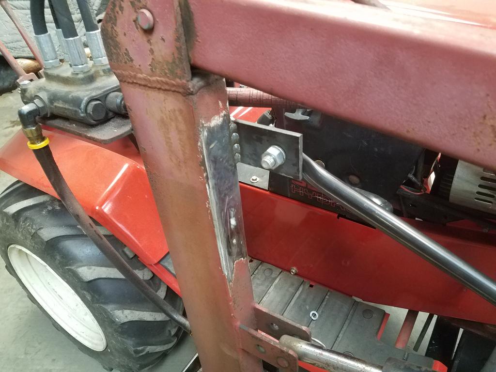

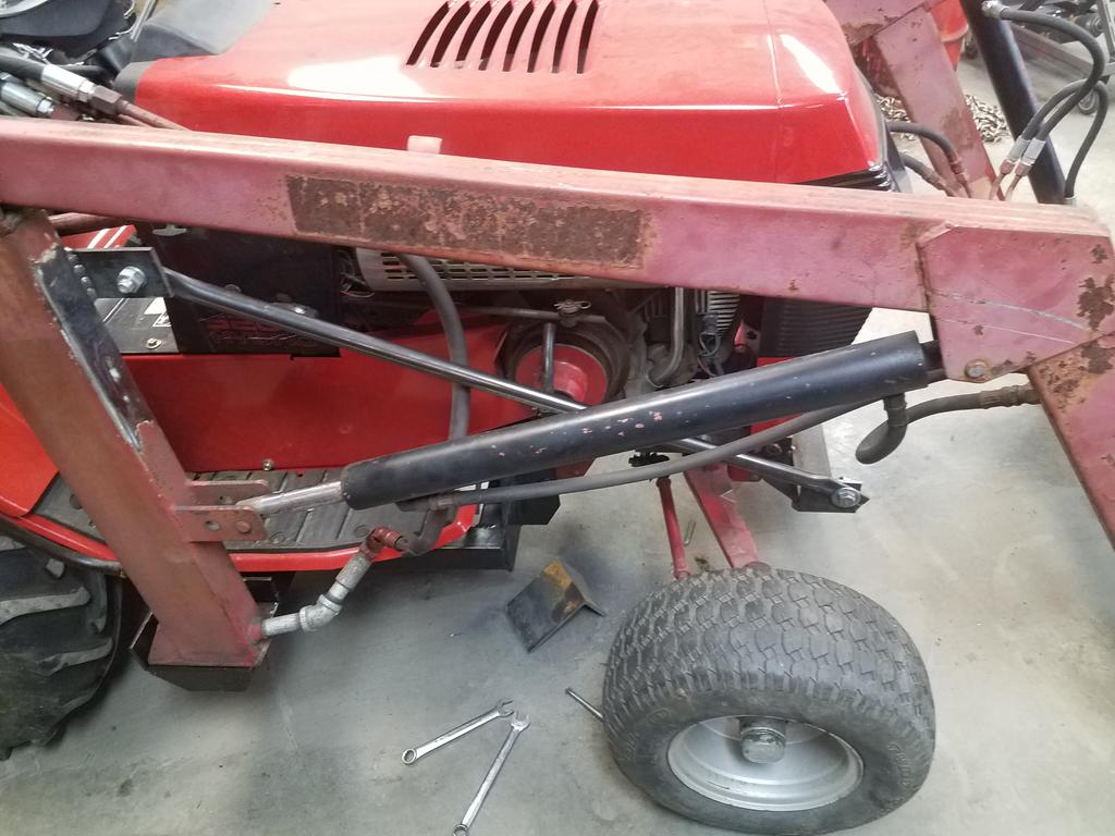

Shynon 7,470 #16 Posted December 10, 2017 Loader is on, now need to make some upright support braces and pump mount. 10 Share this post Link to post Share on other sites

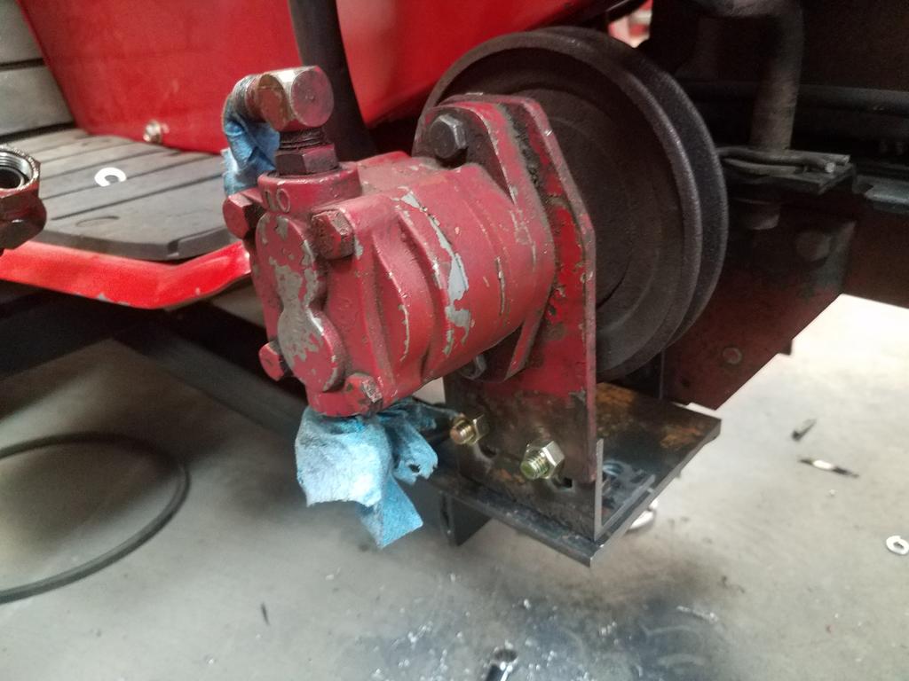

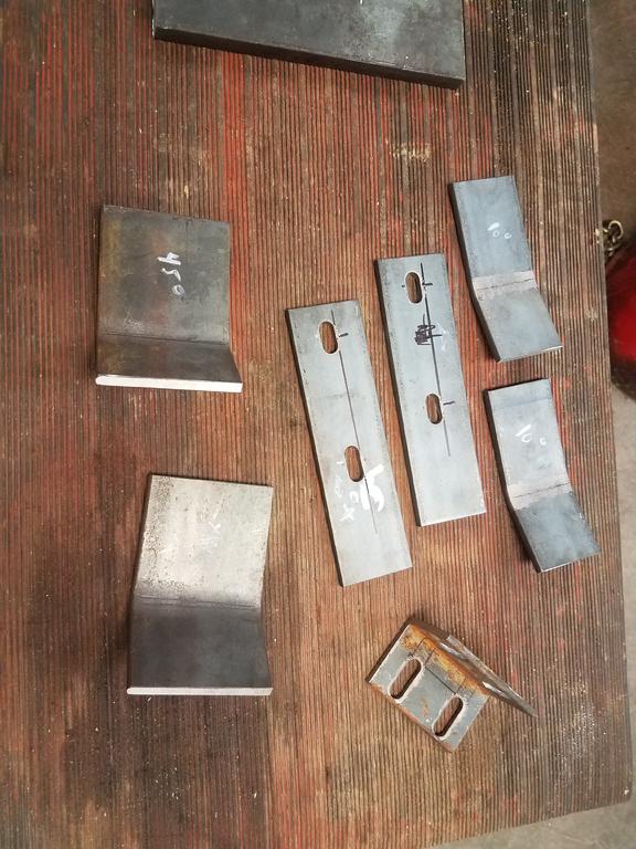

Shynon 7,470 #17 Posted December 16, 2017 (edited) Got the loader bracing done today. Went to see @wheelhorseman to punch some holes and bend some steel. Welded it up today. Pump brackets next. Pump is done. Edited December 16, 2017 by Shynon Added pics 6 4 Share this post Link to post Share on other sites
