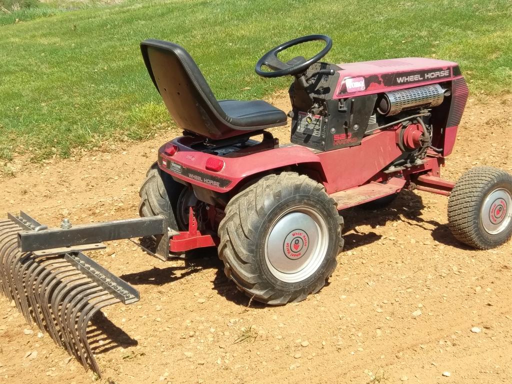

WVHillbilly520H 10,376 #5 Posted September 2, 2017 The "york" rake from Sears for the clevis hitch works for "bigger" stone and if you fab up a flat bar across the teeth you can set the depth and keep more stone coming forward than falling through, Jeff. 1 Share this post Link to post Share on other sites
